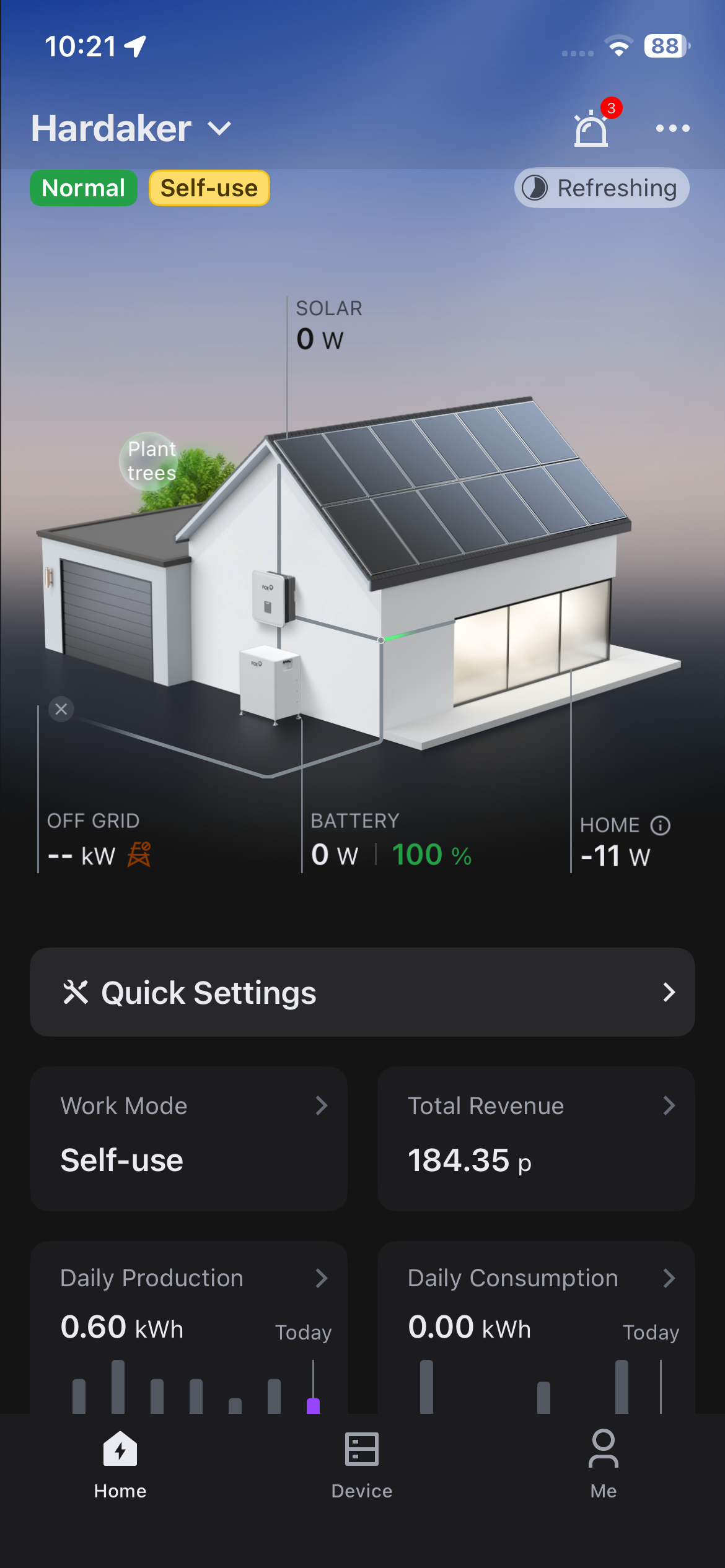

May be related issue, but my FoxCloud 2.0 app not showing any power generated. The system has been down it seems since about 12 April. Called Sustain Homes who installed but no call-back yet. Ive tried all the advice online about shutting down and restarting to no avail. On the App everything appears to be online if you look at devices. Any ideas?
And when I check on the Foxcloud website i can see since 12 April we've had a Category 3 fault on the Inverter. What is that and how can i clear it?
