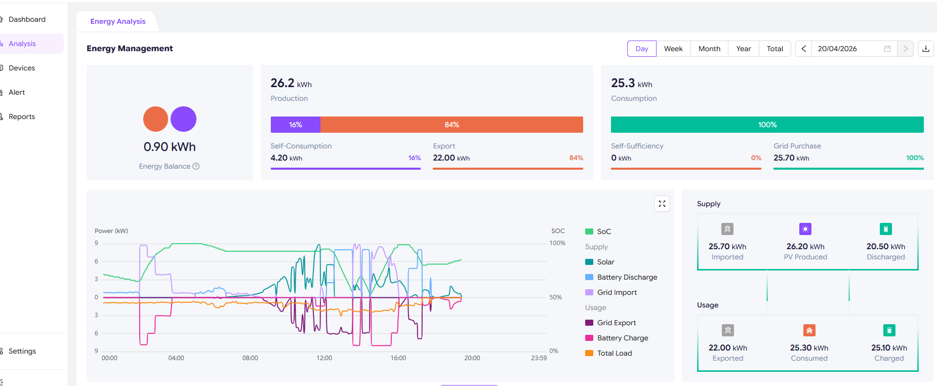

I logged on today and now have 12 all causing my batteries to discharge and export all my surplus back to grid instead of charging my batteries and l cannot change them

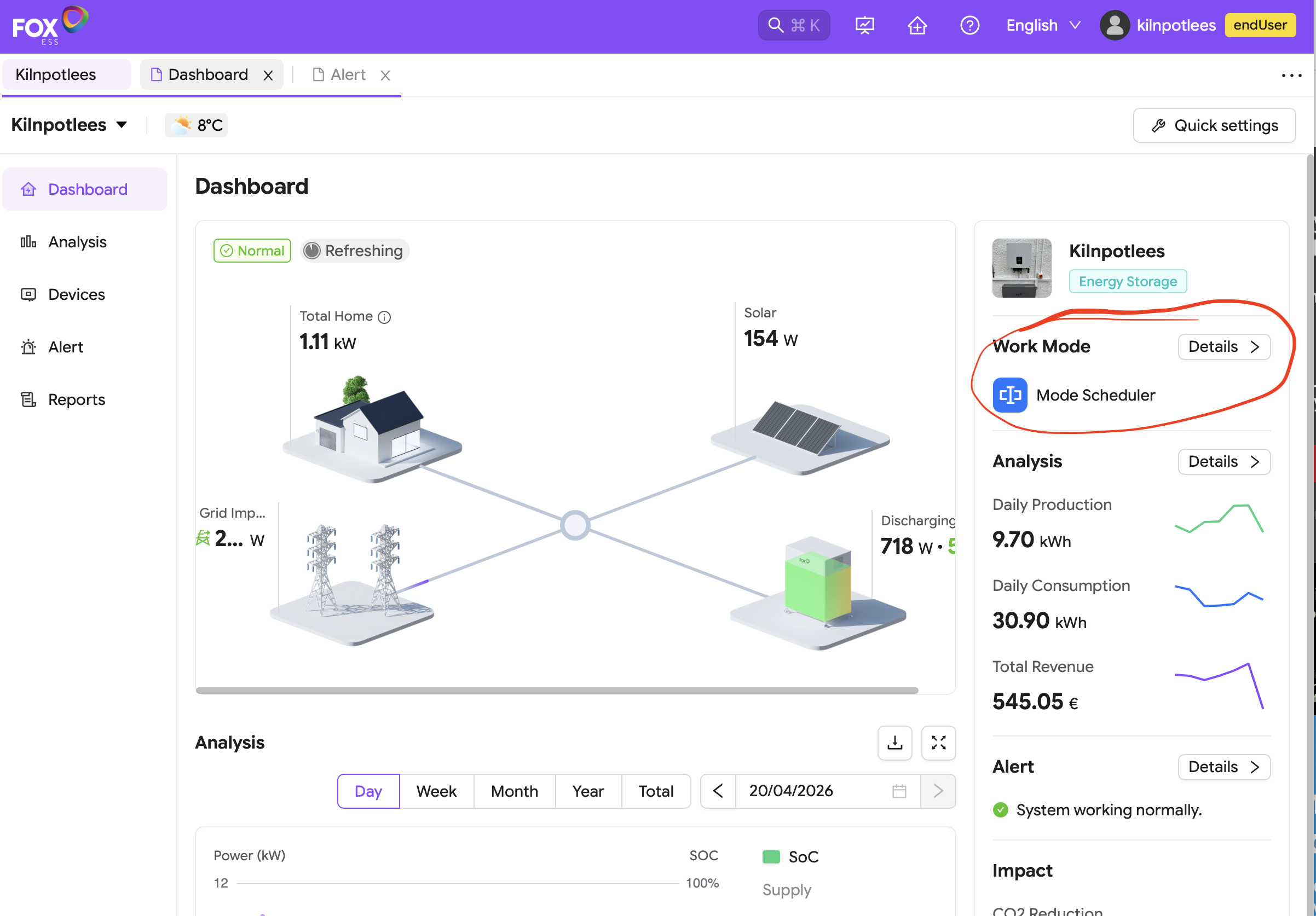

In cloud-v2 it should be here and no longer under "Quick Settings"
Clicking on "Details" in Work Mode should bring the scheduler up, enabling you to edit the schedules.

I see on your picture you have mode scheduler under work mode
I have VPP mode - weird. how do l insert a picture

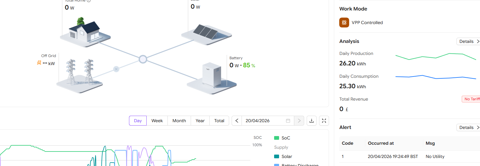

on my home dashboard l have no mode scheduler - i have vpp
l have no mode scheduler option
then when l press detail , l get this screen all was fine yesterday and now this!!

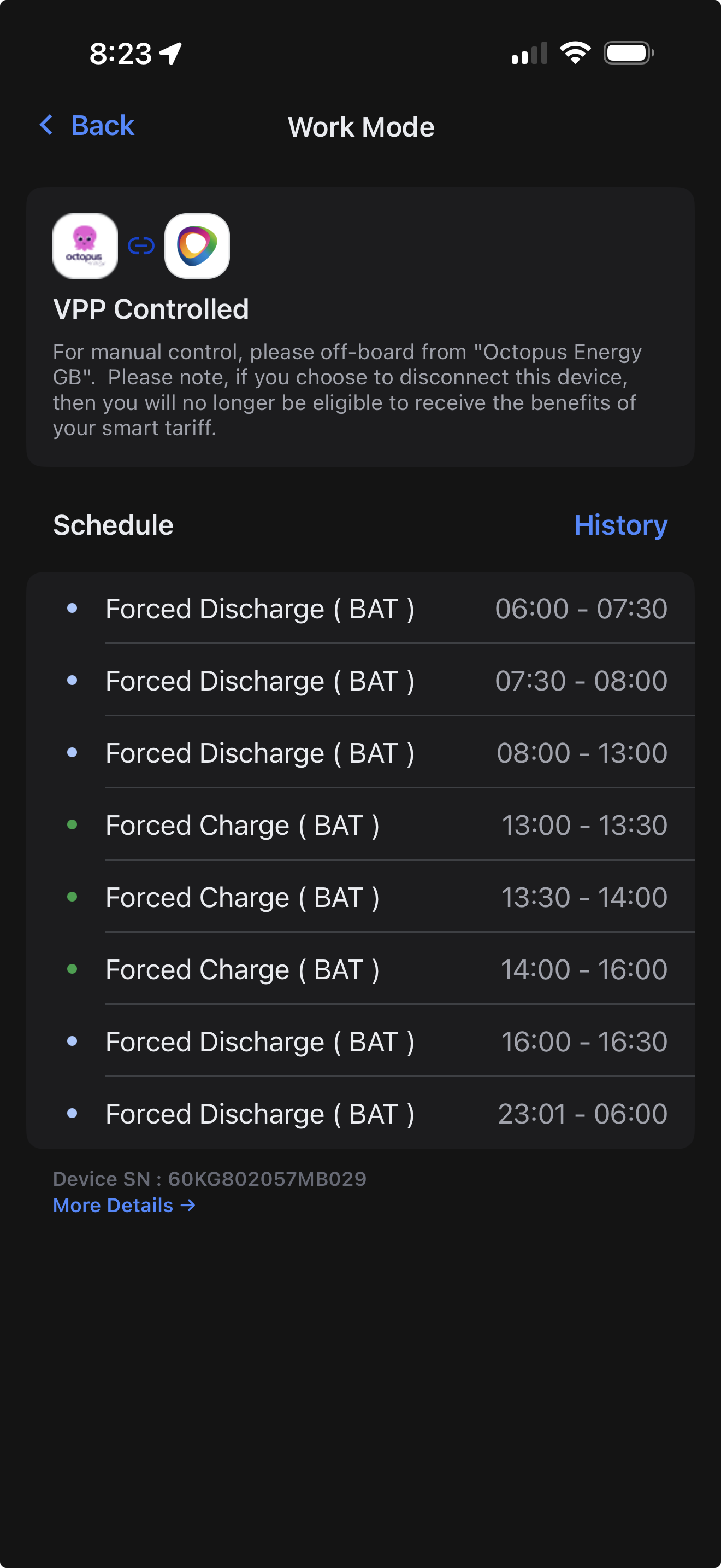

on phone app - when l go into box with two blue arrows - but l cant toggle between the two
the text seems to says l have to off board octopus gb - there was an octopus issue yesterday morning with their app going down. could this be an issue at their end?
now l know what sherlock Holmes feel like
Its seem Octopus have set my system to a VPP mode - it has configured 12 modes all selling to grid or charging off them at peak times - When it sells to them l get peanuts and buy off them at max rate

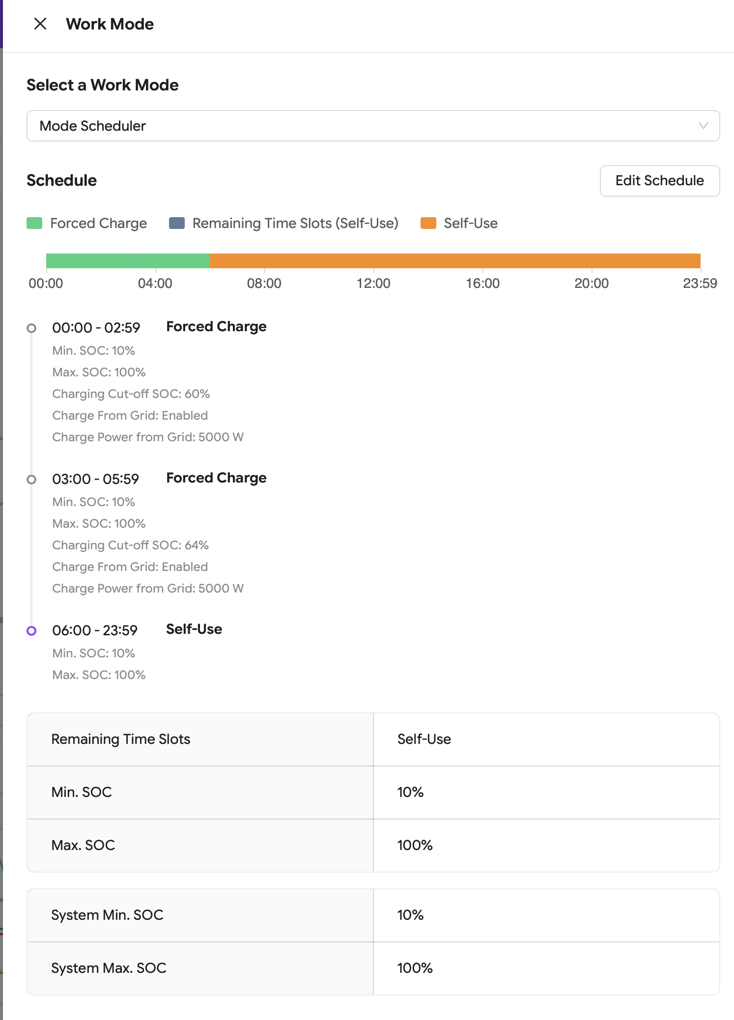

it changed within minutes and l was able to see mode scheduler and control my own systems again
back to my own modes
