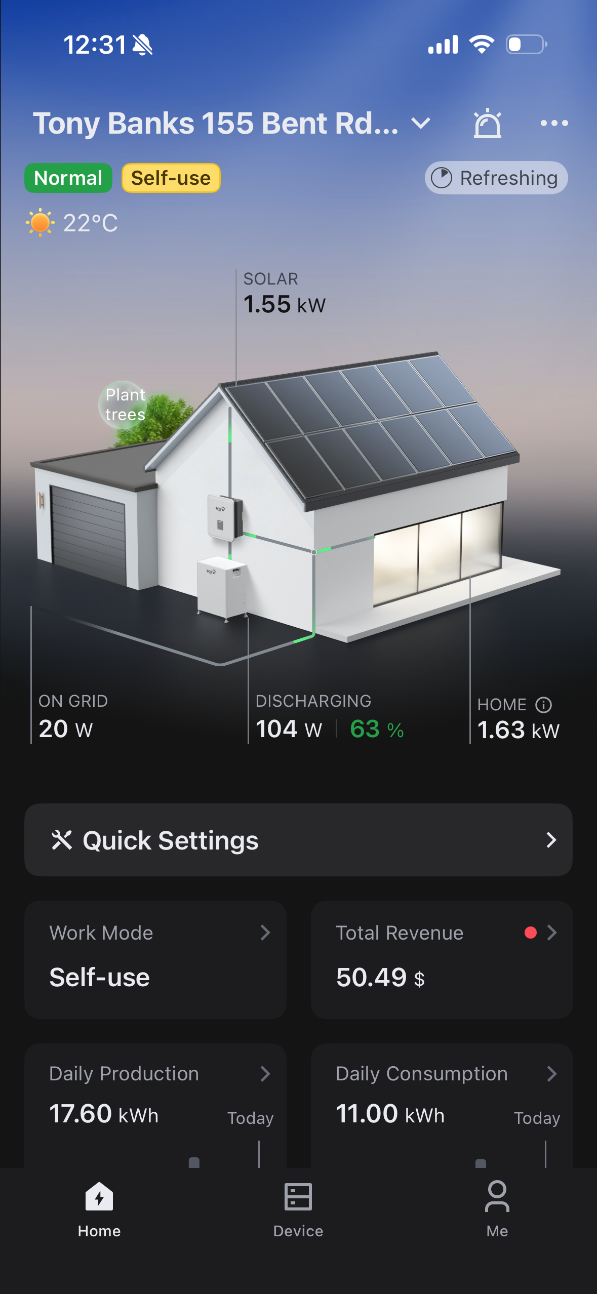

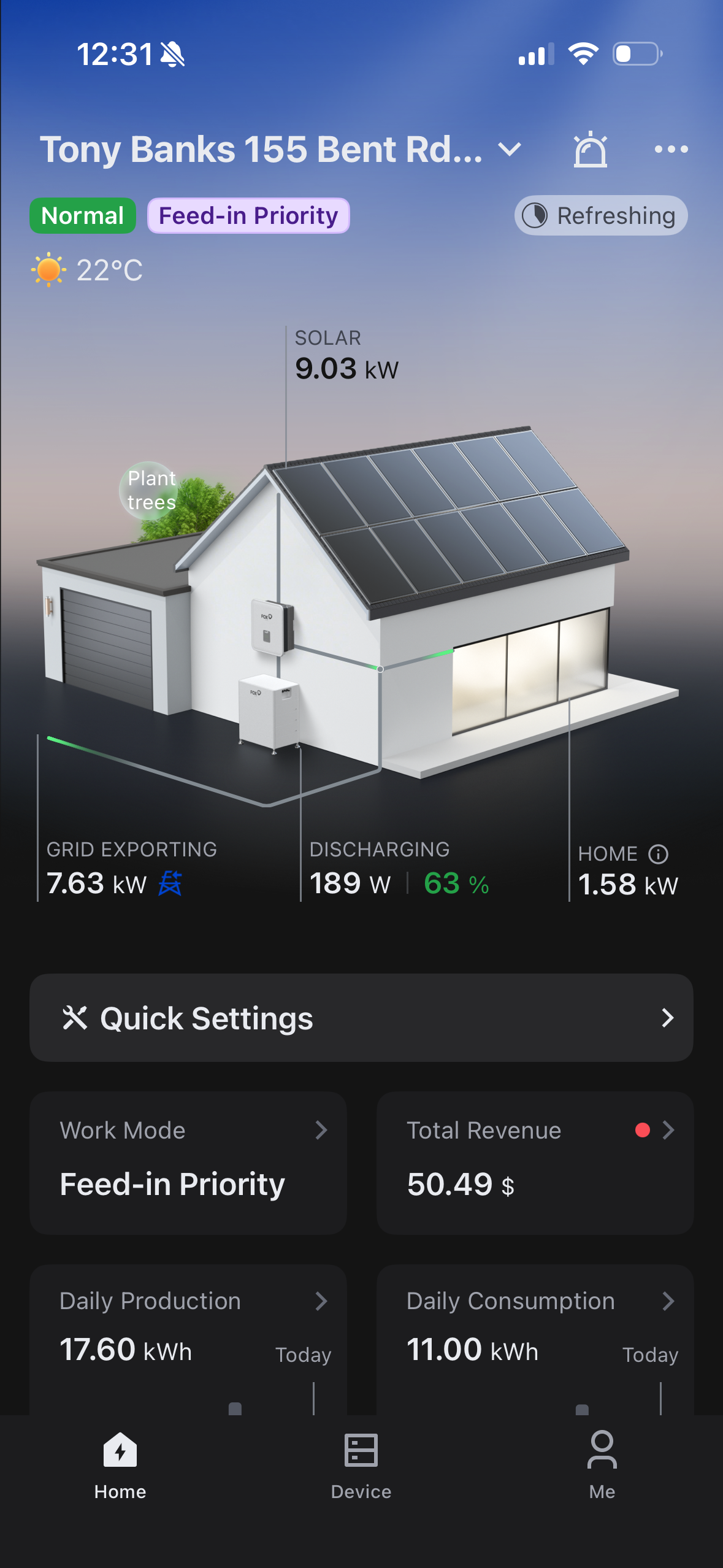

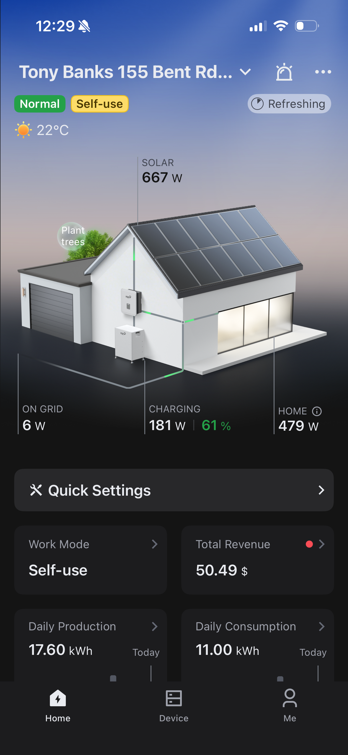

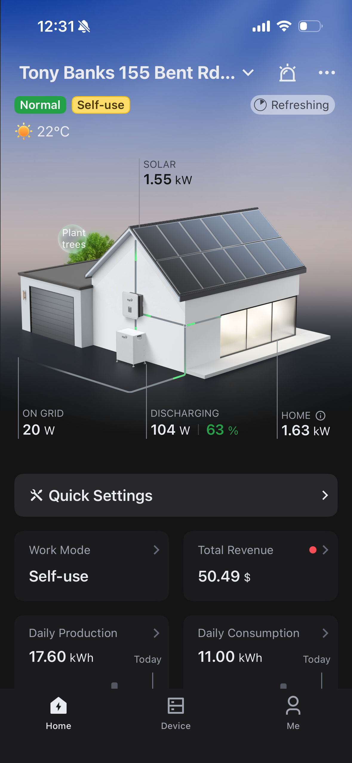

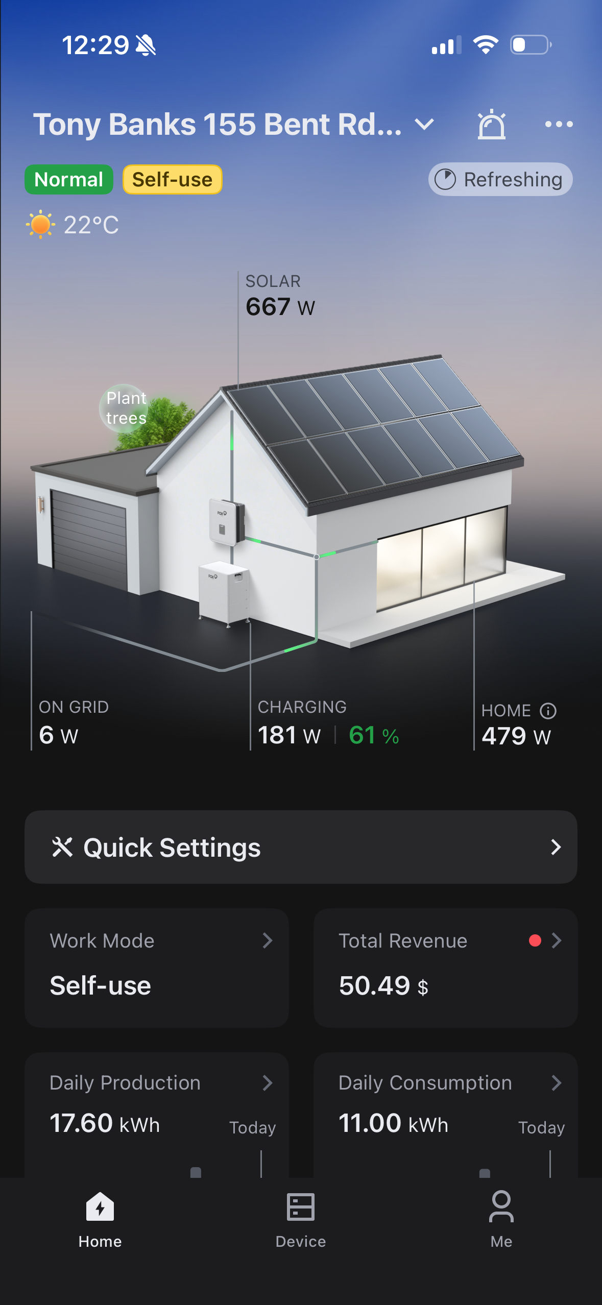

System was recently installed and have had no problems to date. Recently I upgraded the Master firmware for the inverter (K10) from 1.58 to 1.60. Since then the PV output only seems to match the household draw in very sunny conditions in Self-use mode. However, when you change modes to Feed-In Priority, the PV production goes up to what you would expect for the prevalent solar conditions.
I have hard reset the whole sytem but this problem does not want to go away.
Is the firmware release a dud? If so, what can be done about it? Obviously there is no option to return to a legacy firmware version which is extrememly frustrating.
Any ideas?
Master 1.60
Slave 1.02
Manager 1.58
Feed-In Priority
Feed-In Priority
Self-Use
Self-Use

My inverter just clips the PV outputput as soon as the batteries reach 60% SOC. The inverter doesn't even send the excess power to the grid in self use mode and my power company has no in feed limits. I basically have a battery unit that only ever operates at maximum 65% capacity which is absolutely rubbish. In addition, I don't get credited foe any excess power I produce because the inverter won't put the excess into the grid. I am thoroughly disappointed with this setup and no one seems to have a solution for this. I will attach screen shots showing the outputs self use mode then immediate switched to feed in priority then immediately switched back to self use mode.
