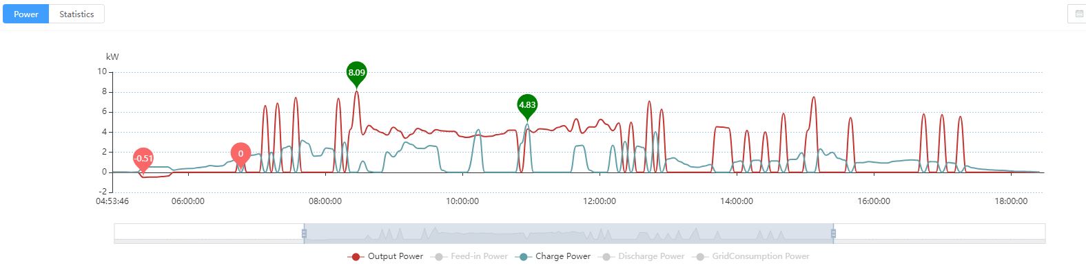

I currently have 2 KH10.5 with 10KW mira HV battery in parallel mode with export limiter set to 0 since netmetering is still being processed. Can someone help me with the following?
1. It is currenlty set to SelfUse mode. However, it is not following the priority order of Load>Battery>Grid. Based, on my observation when it is set to this mode the priority is Battery>Load>Grid
Based on the manual, battery should only charge when there is excess PV power. Is there a way to force the inverter to follow this priority Load>Battery>Grid? (see attached screenshot). as you can see in attached screenshot early in the morning the battery is already being charged by the inverter even though there is not enough solar/PV power. This would really help reduce the electric consumption tothe grid since solar would first be provided to the load rather than the battery.
