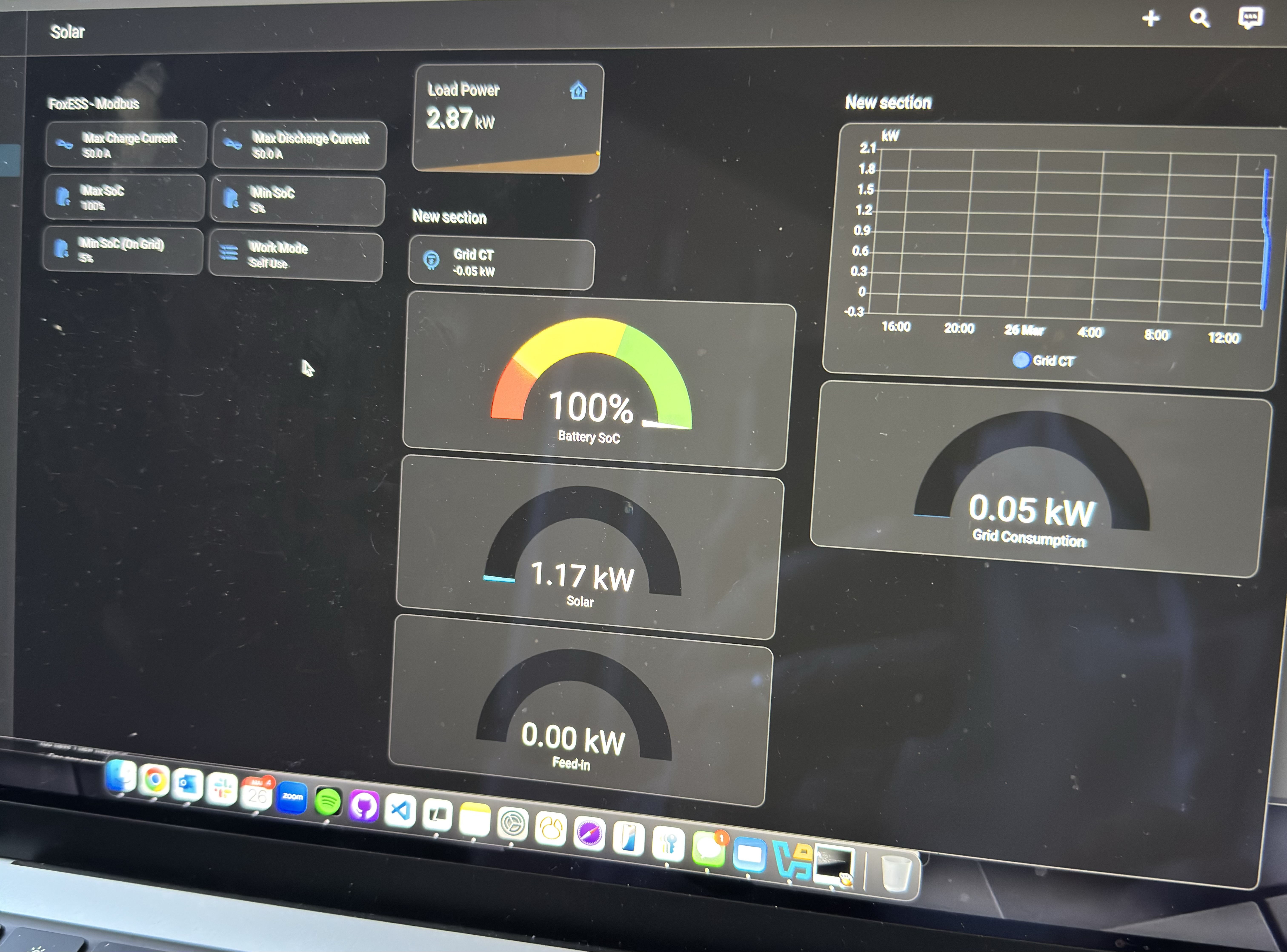

I had a quick attempt at setting it up with HA using this modbus fork (as the original project does not support EVO 10) https://github.com/AdamNewberry/foxess_modbus_EVO
Currently got a really crap dashboard going
Err, yeah, well it's a start...
Mine's a bit more text based. I used to be on Agile so I'll make a few changes once I figure out the which Fox energy stat is which..!

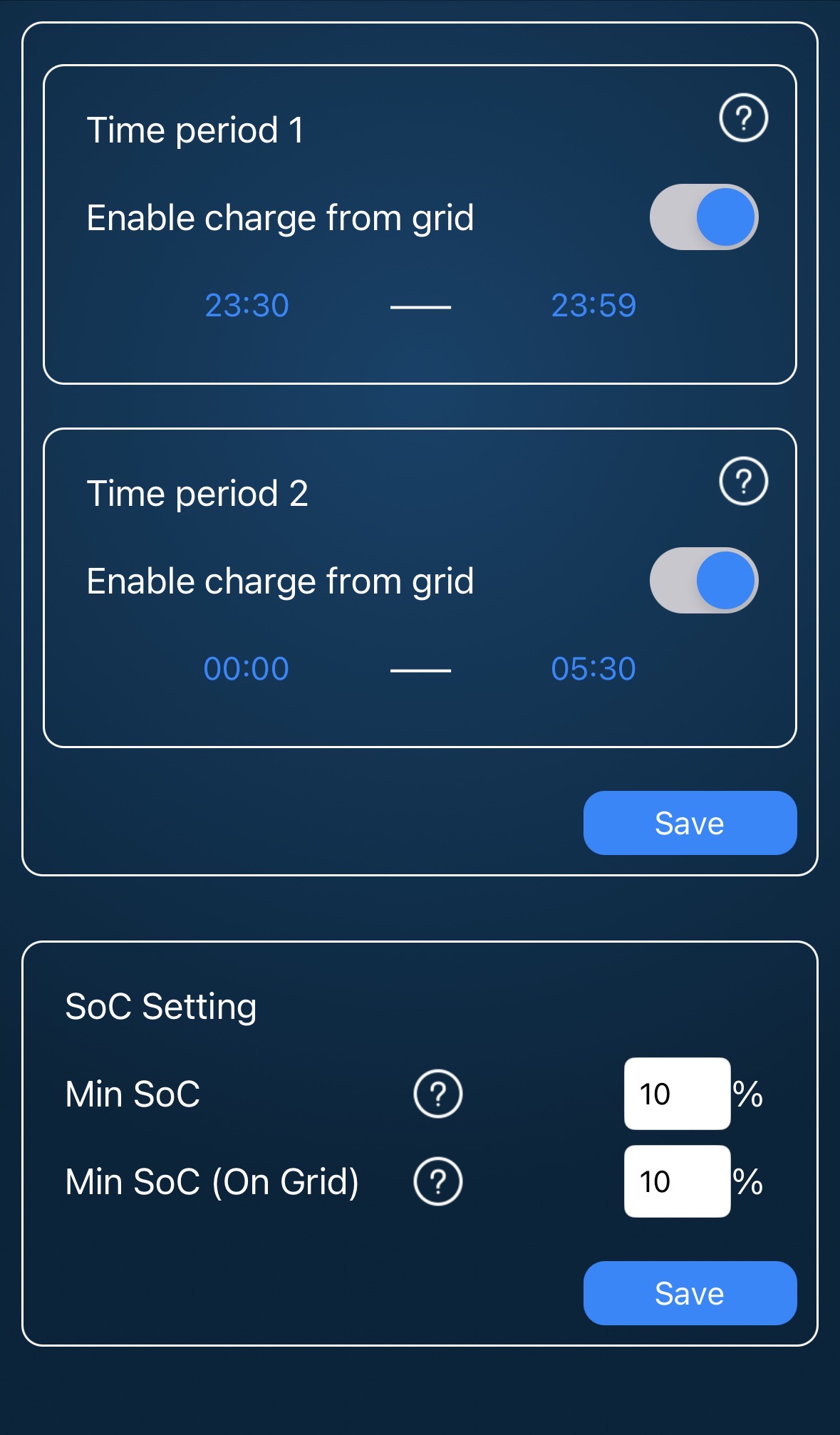

The battery minimum SOC was also an issue this morning, as in the app it was now at 98%, so even though I didn’t have enough solar to meet house load the battery refused to kick in. I changed it on the app back to 10% and it started to discharge to the house.
I have adjusted settings now to maximum charge from the grid to 50% tonight to see if it behaves. Going to be exporting a lot of kW today and not getting paid for it, which is annoying!
The app will show you the charge rate for yesterday: Click Daily Production and then the left arrow to show yesterday. The light pink line above the axis is Grid import.
Yes, it's confusing - there are two similarly named settings: "Min. SoC on grid" (Minimum SoC for the battery to be "on grid" - i.e. supplying power.) only appears in the web interface; "Min SoC" is the Minimum SoC when discharging etc.

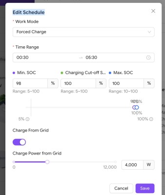

Any idea what the recommended charge rate should be for a forced charge on a 5kw battery.
I set ours to 6kW when it was stuck charging at 1.06kW but after the firmware fix it goes full beans!
I’ve actually set it now to 4kW as that’ll easily fill it, even when down to 10%.
I assumed 6kW was a standard thing a bit like an EV charger. As I mentioned earlier though we only have a 60A fuse to keeping the battery at 4kW is probably better for overall load
(I think

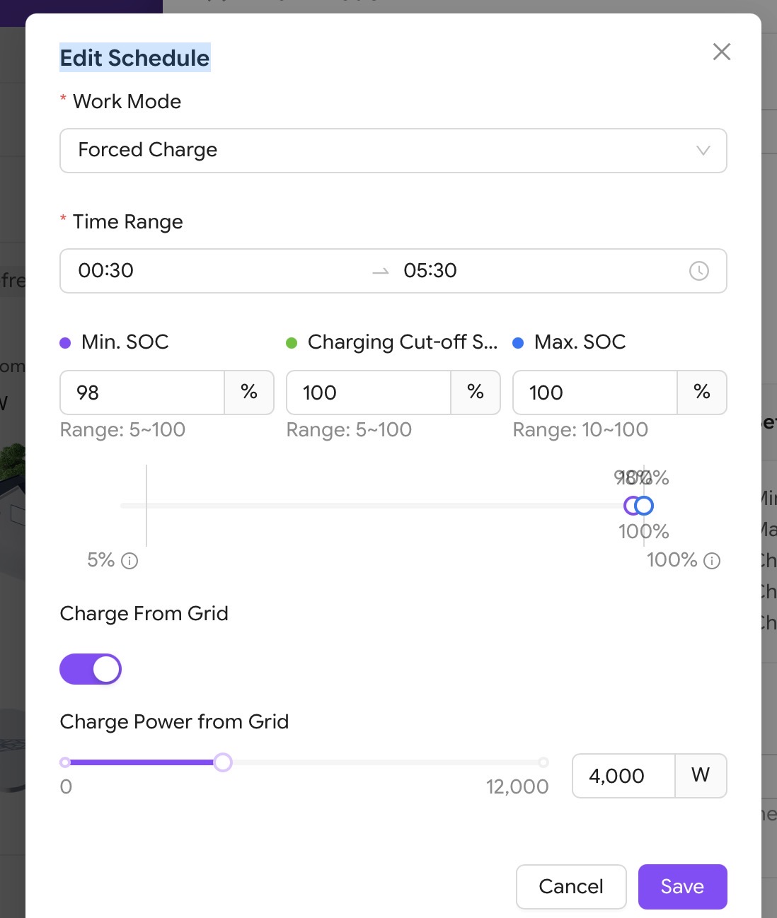

Is anyone else back to square one with force charging since the most recent firmware update? I cannot get my battery to force charge over night. I have the SoC Min at 98% and Charge cut off at 100%, but nothing happening again. I think I may need to ticket this with Fox…

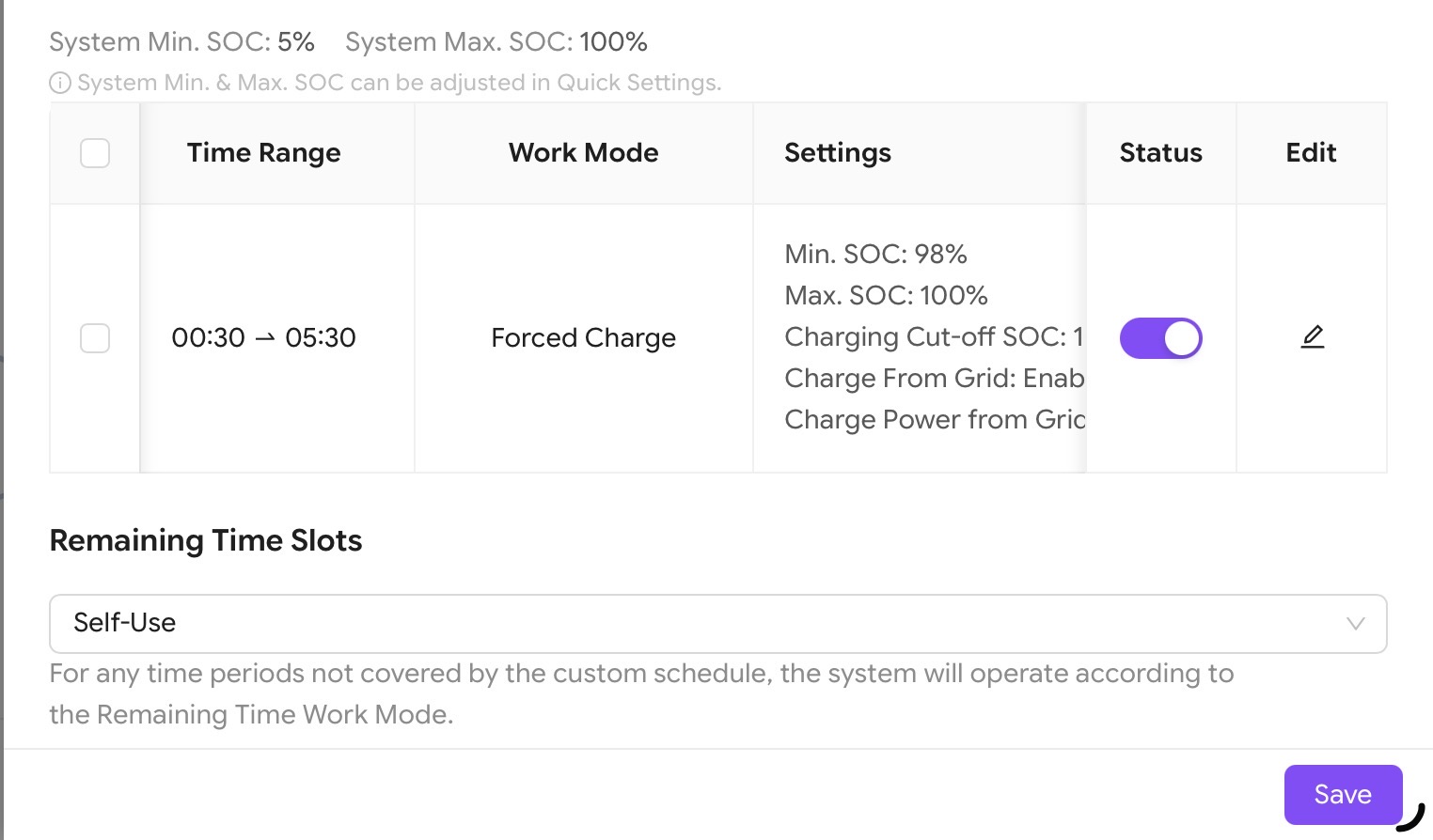

I have noticed that the Fox Cloud 2.0 website has changed so the settings window looks slightly different.
The pictures show the current settings.
