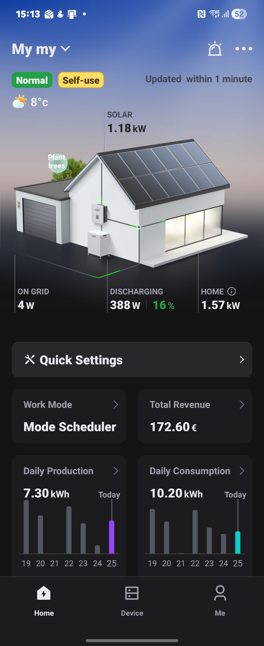

Re: Buttery does not charge. Wrong usage data indicated in app.
Now like this. Heat pump is working now.

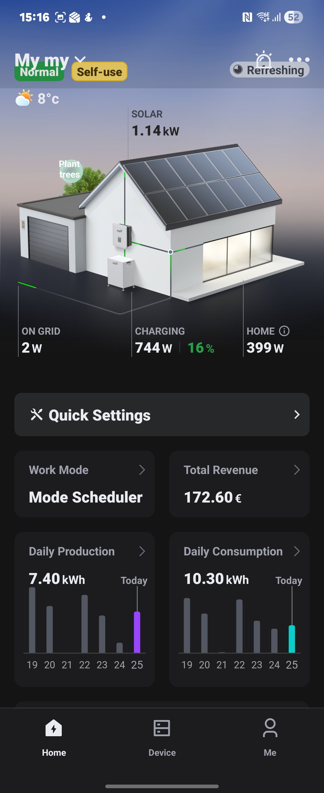

I turned off the heat pump and app shows matching data. Will keep an eye on it. Thank you very much!
That is looking more like expected, see how it goes and keep us updated.

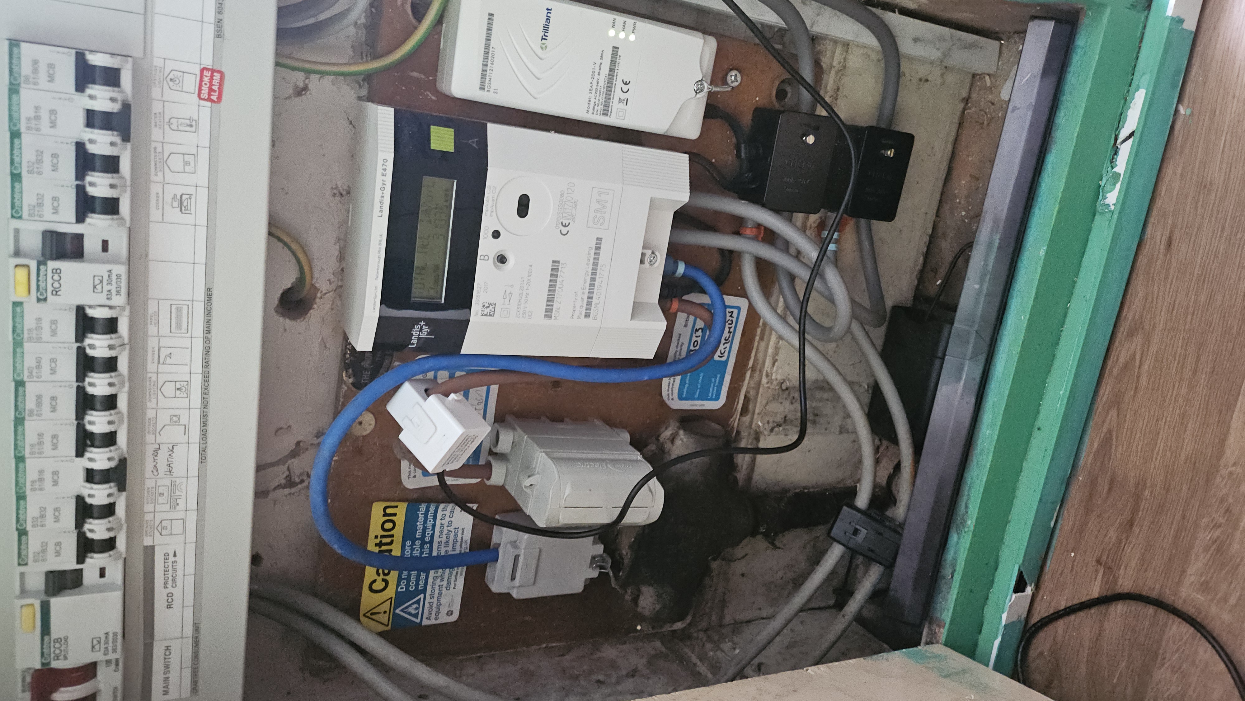

Been away for a few hours.
So you have got two CT clamps, Black for Fox and White for a Heat Pump?
That would explain how this has been reading wrong for ages.

But it does look a lot better thanks to @nrb501 advice on getting the CT Clamp moved.
