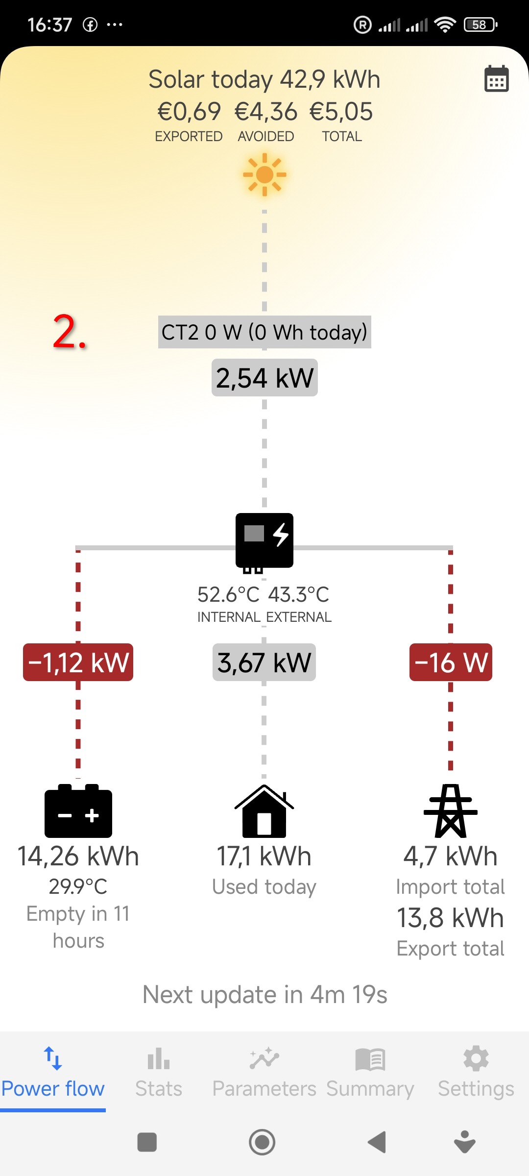

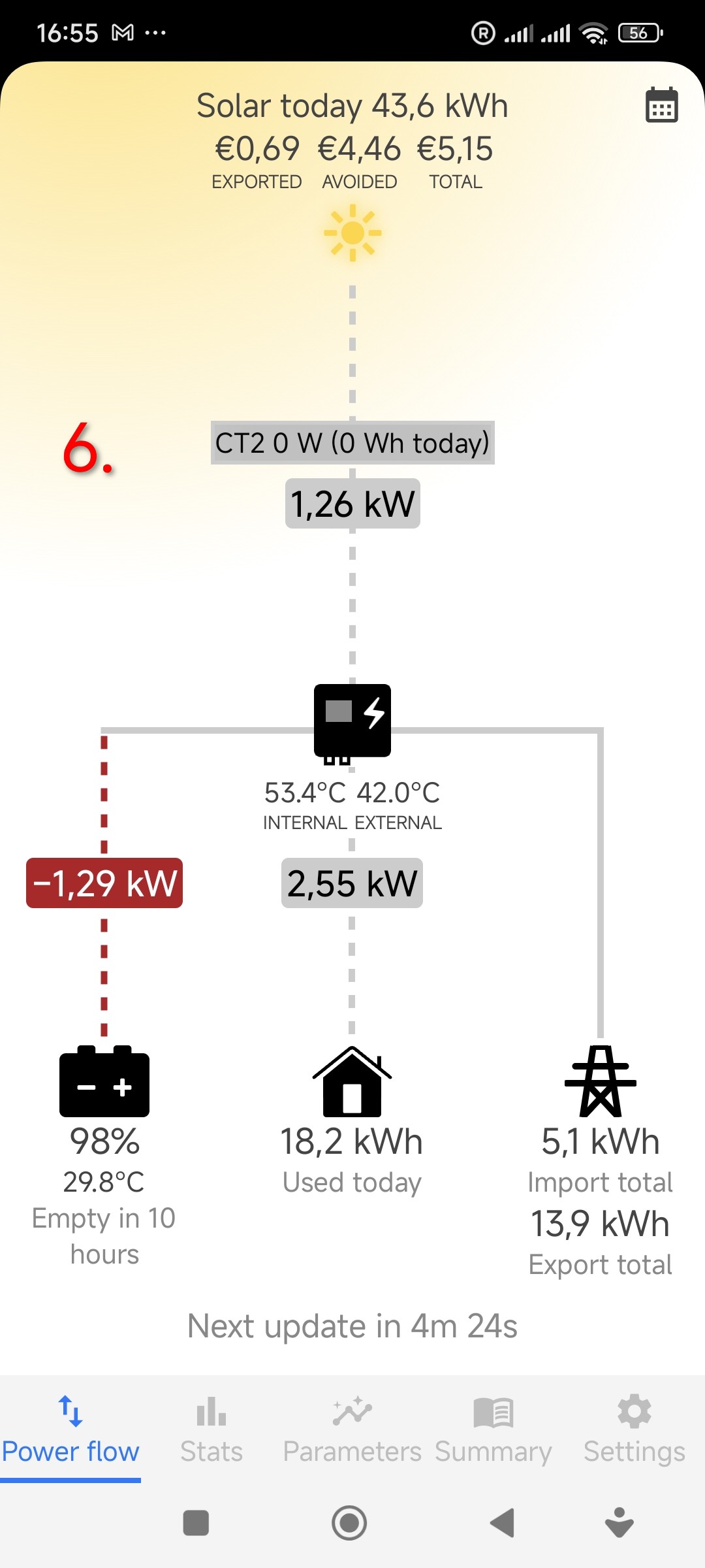

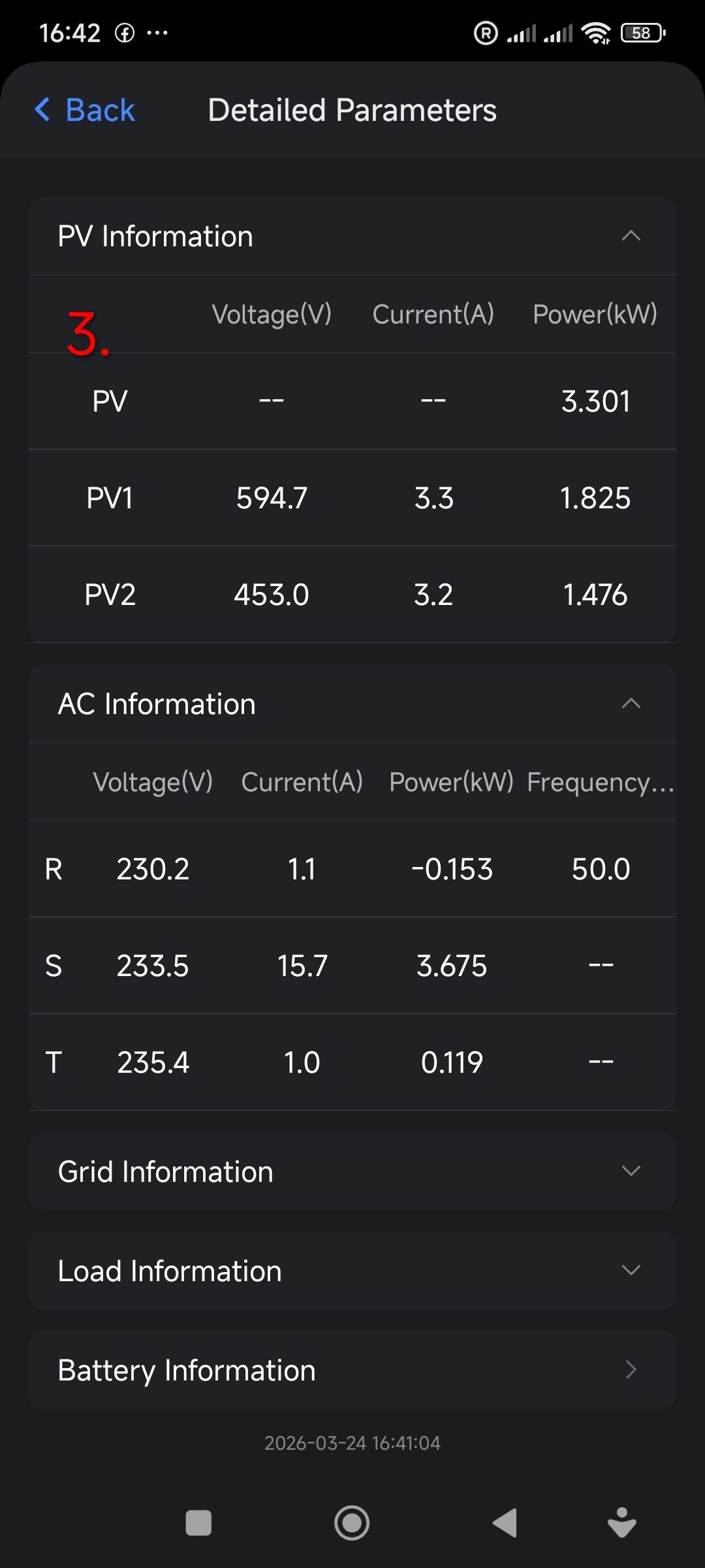

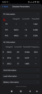

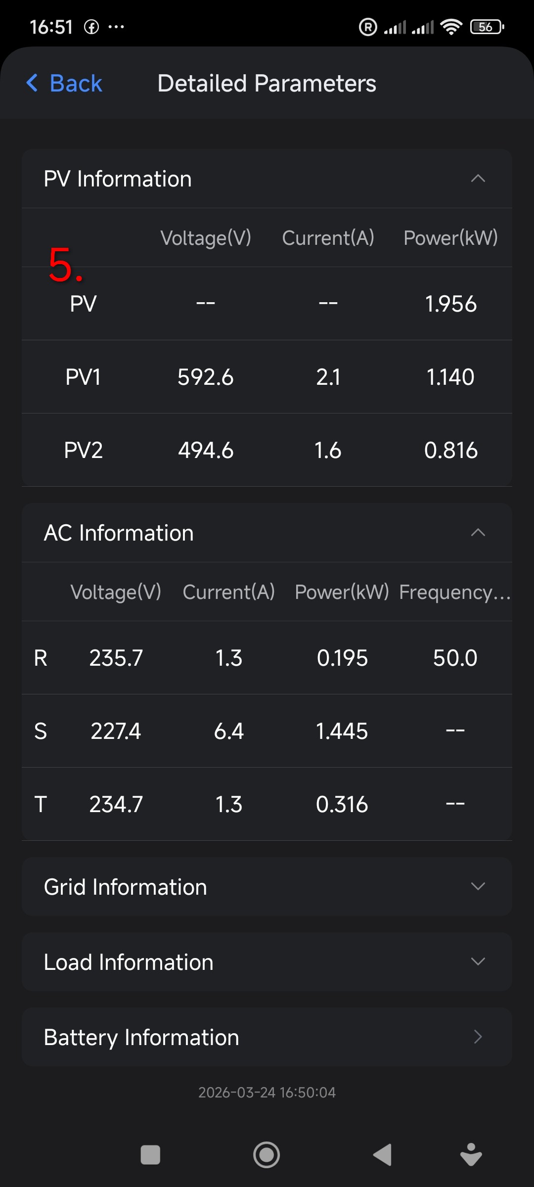

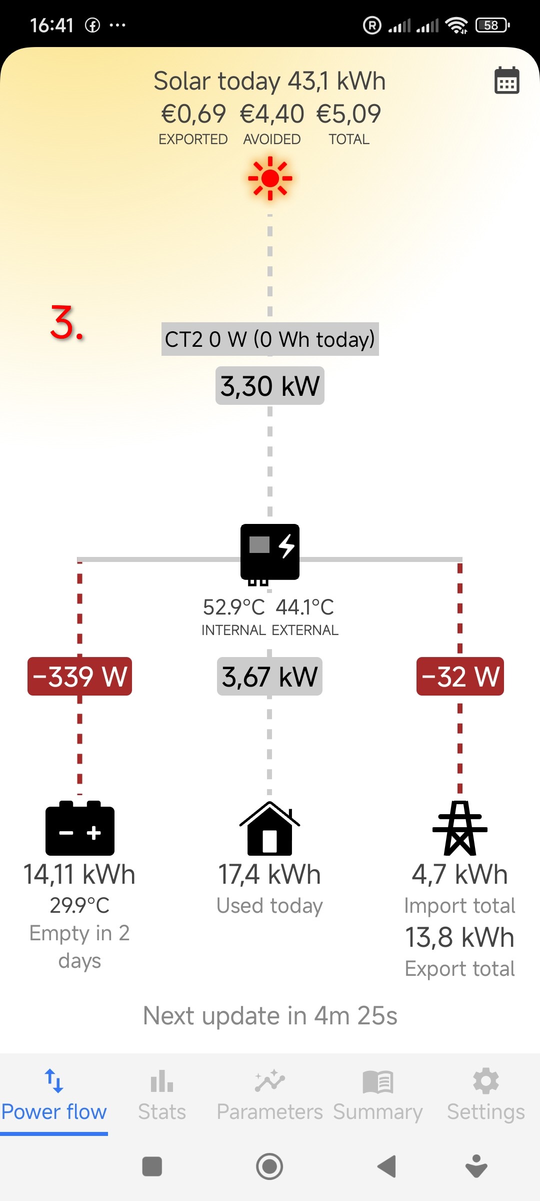

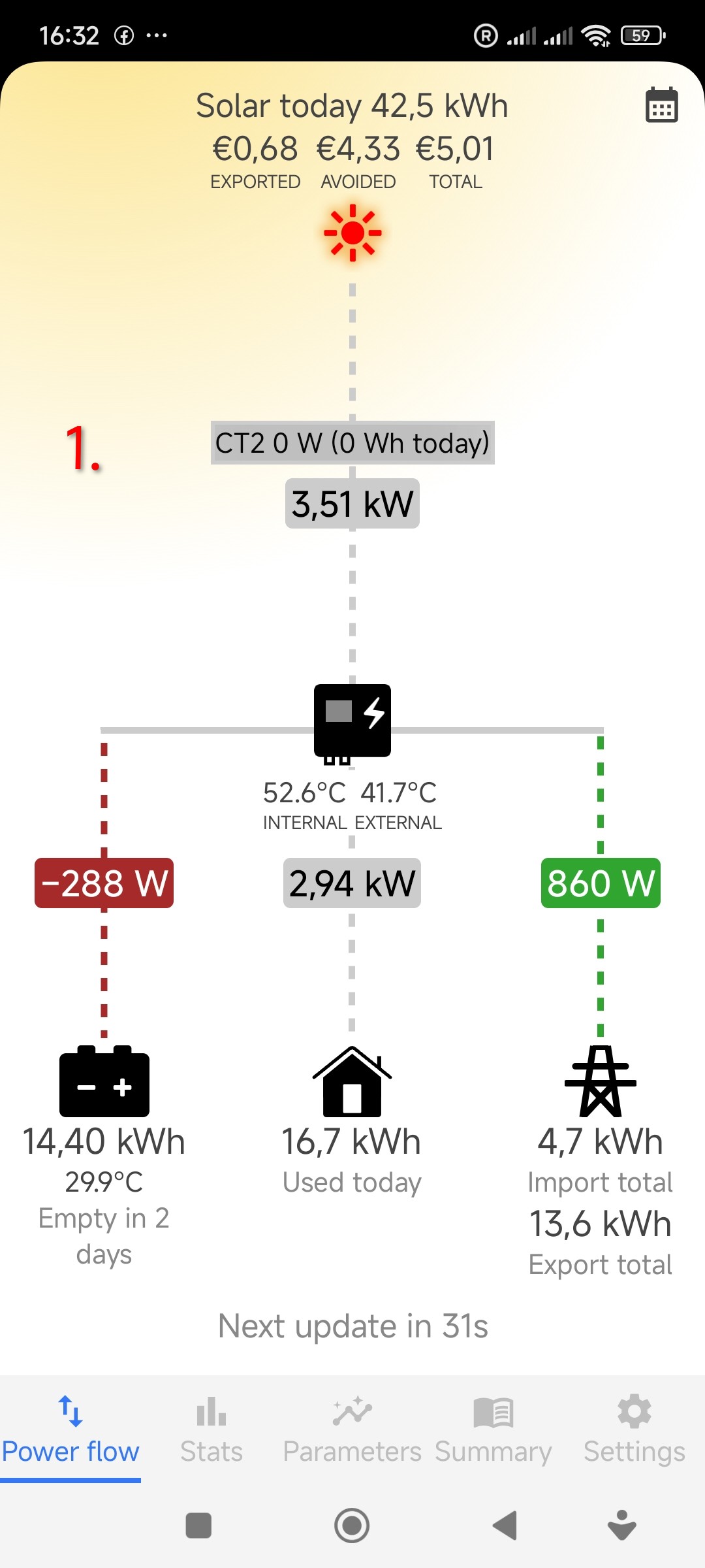

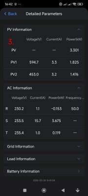

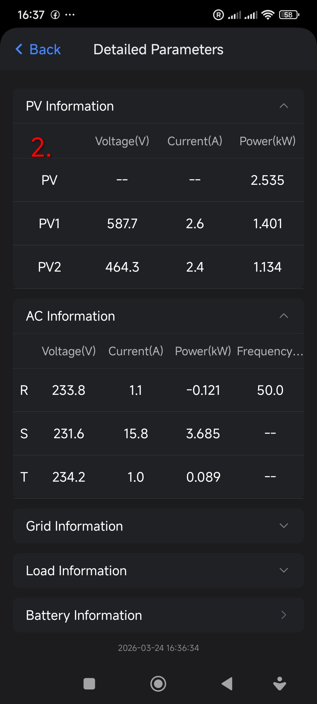

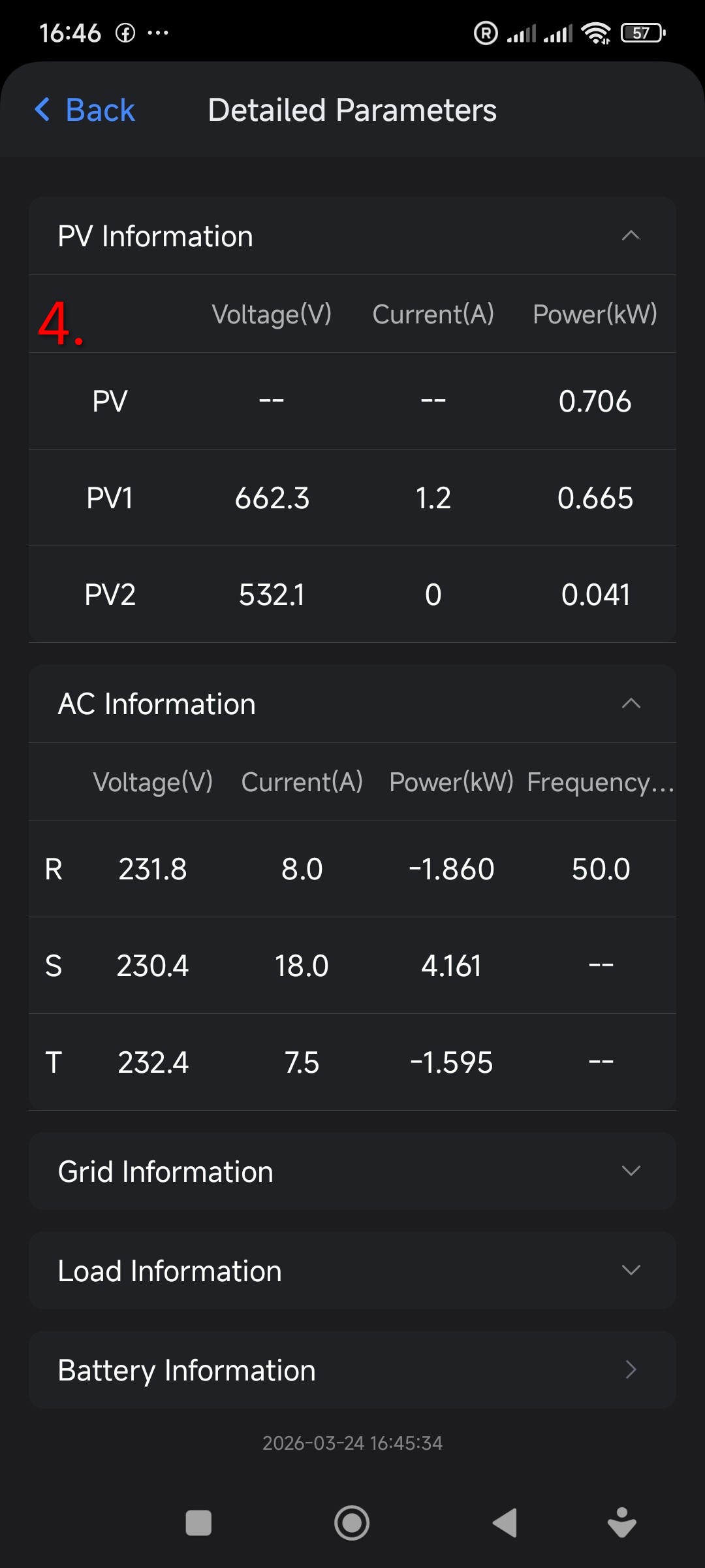

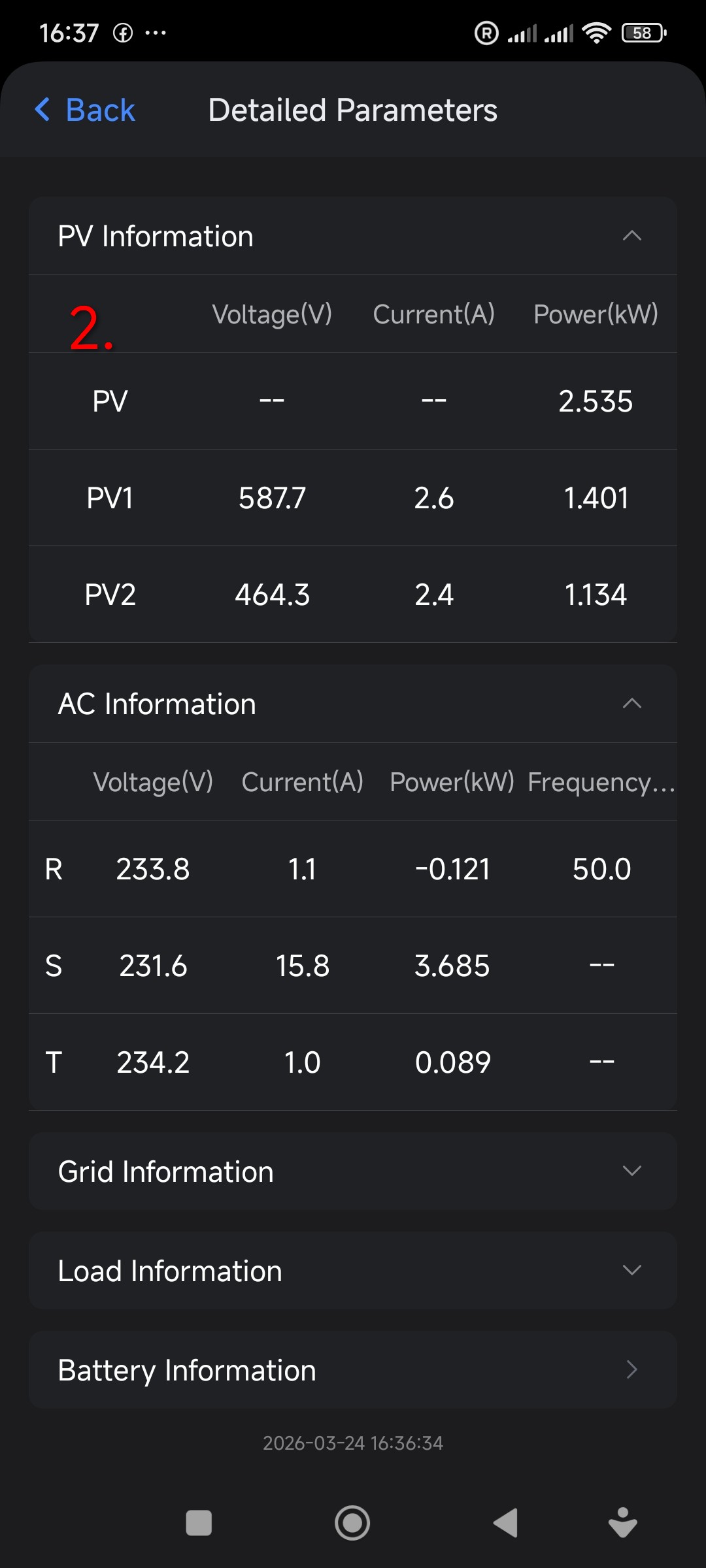

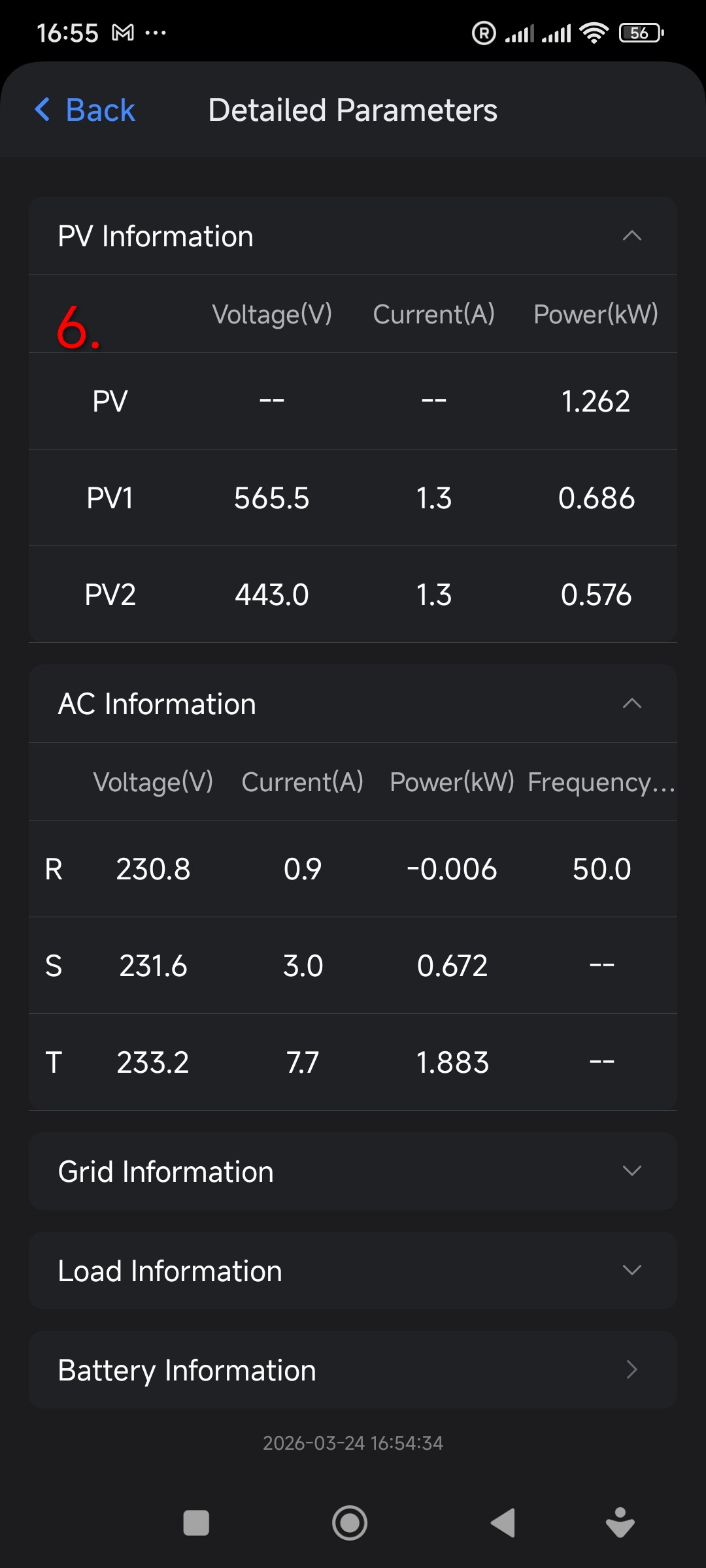

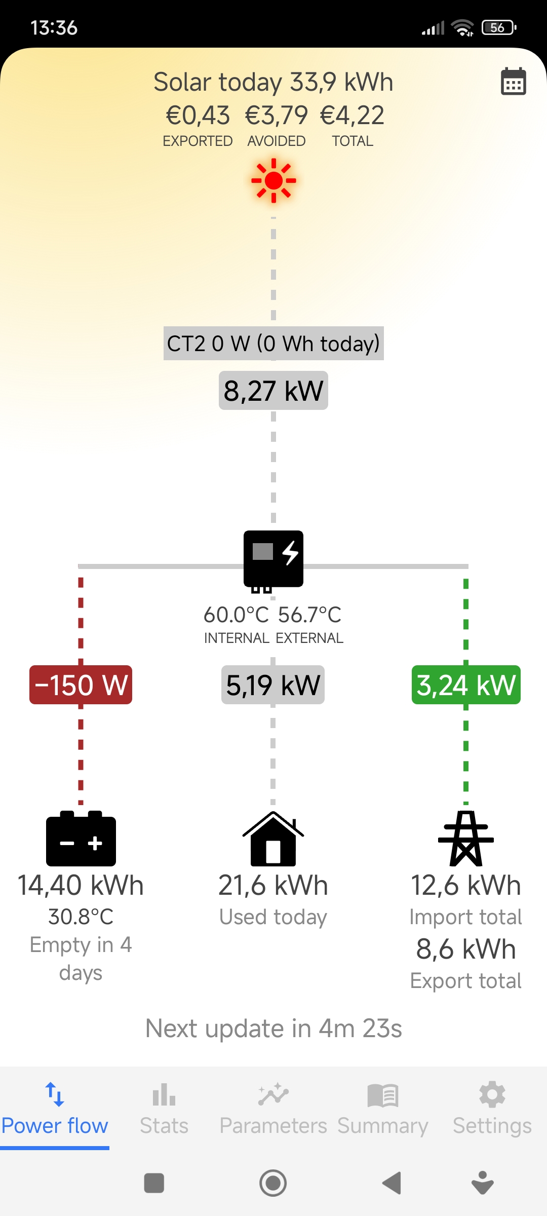

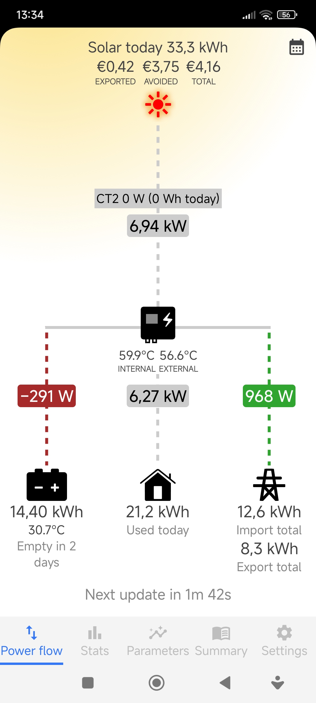

I ask the question again, why is it taking energy from the grid? If the consumption is up to 5.1Kw, the solar system shows max solar. If the consumption is greater than 5.1kw, it starts taking energy from the grid and from SOLAR PANELS. The higher the consumption, the lower the energy obtained from the solar panels. There are no clouds.

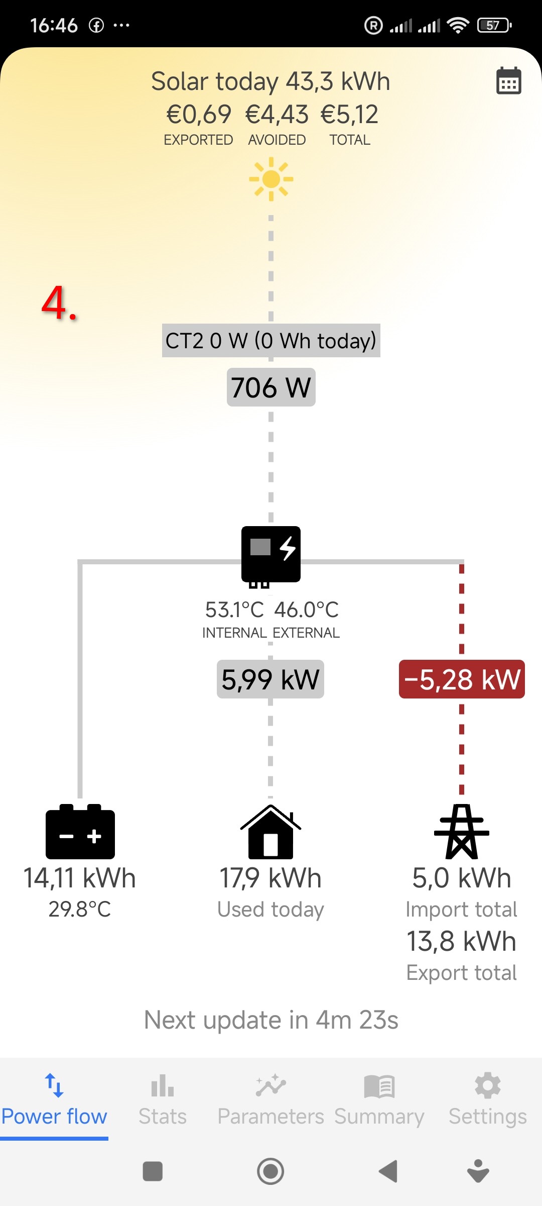

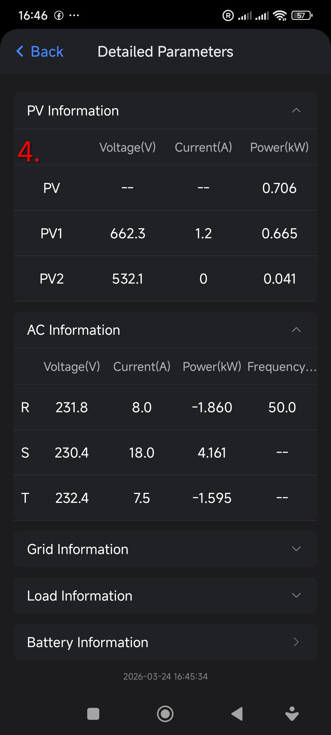

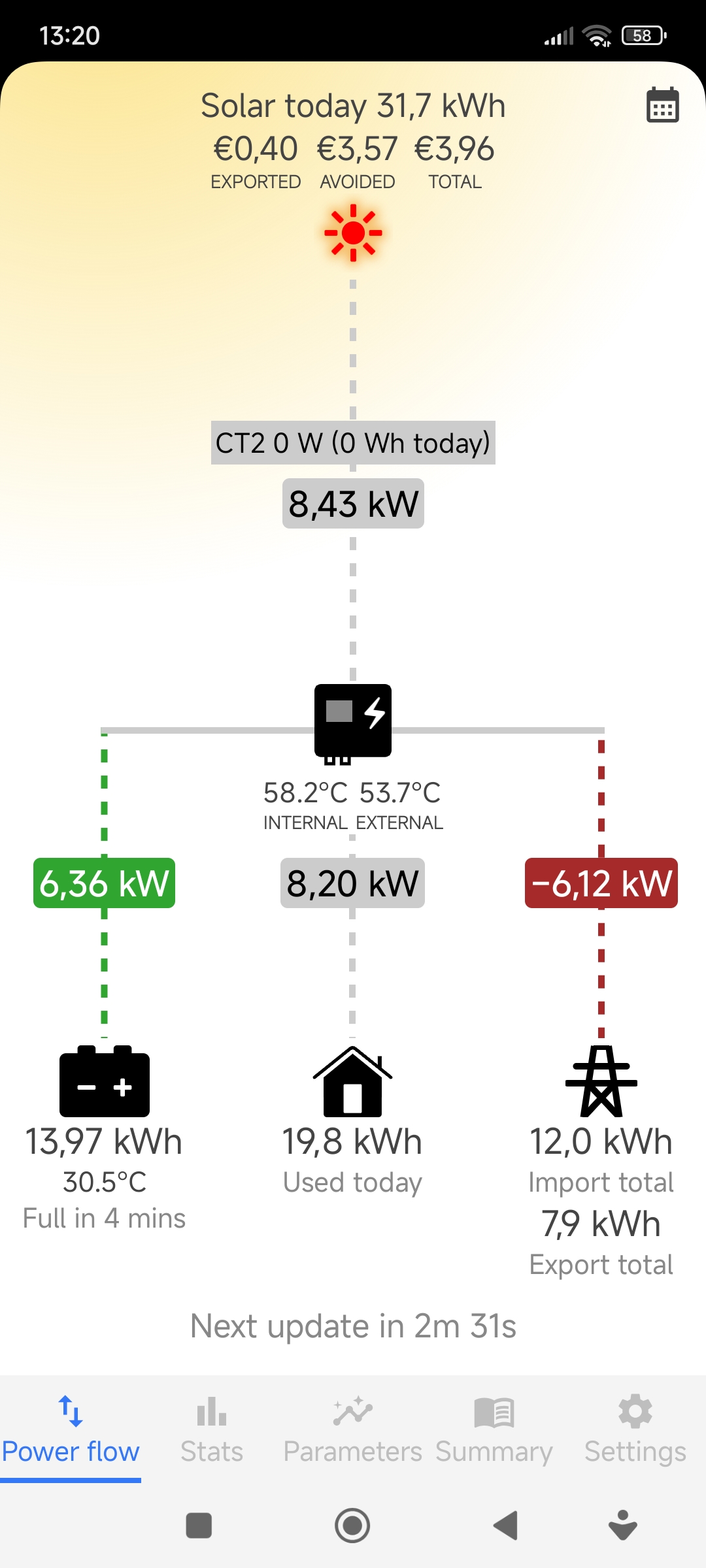

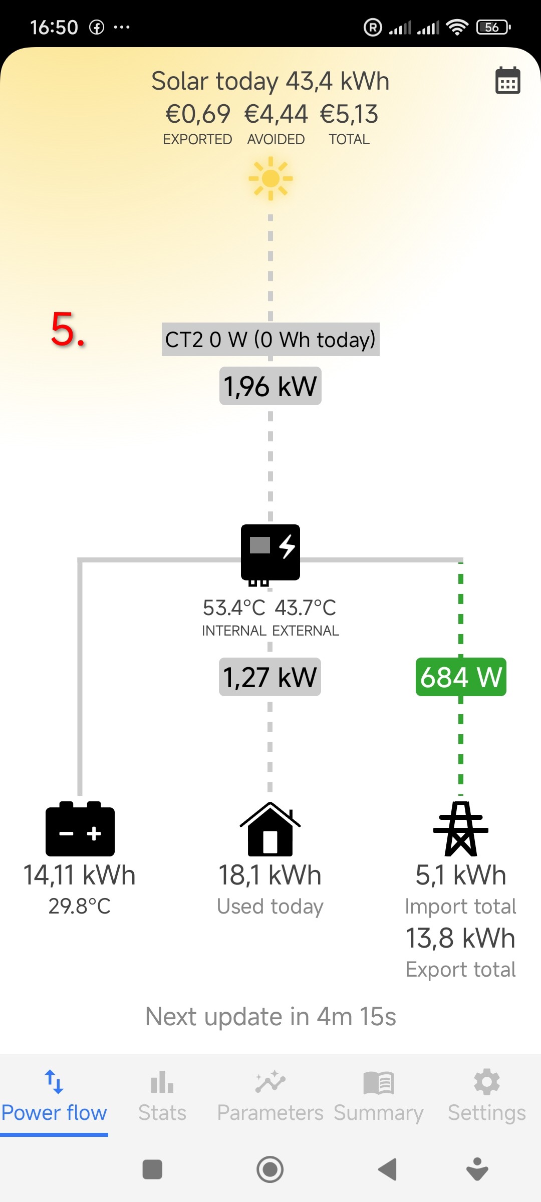

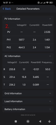

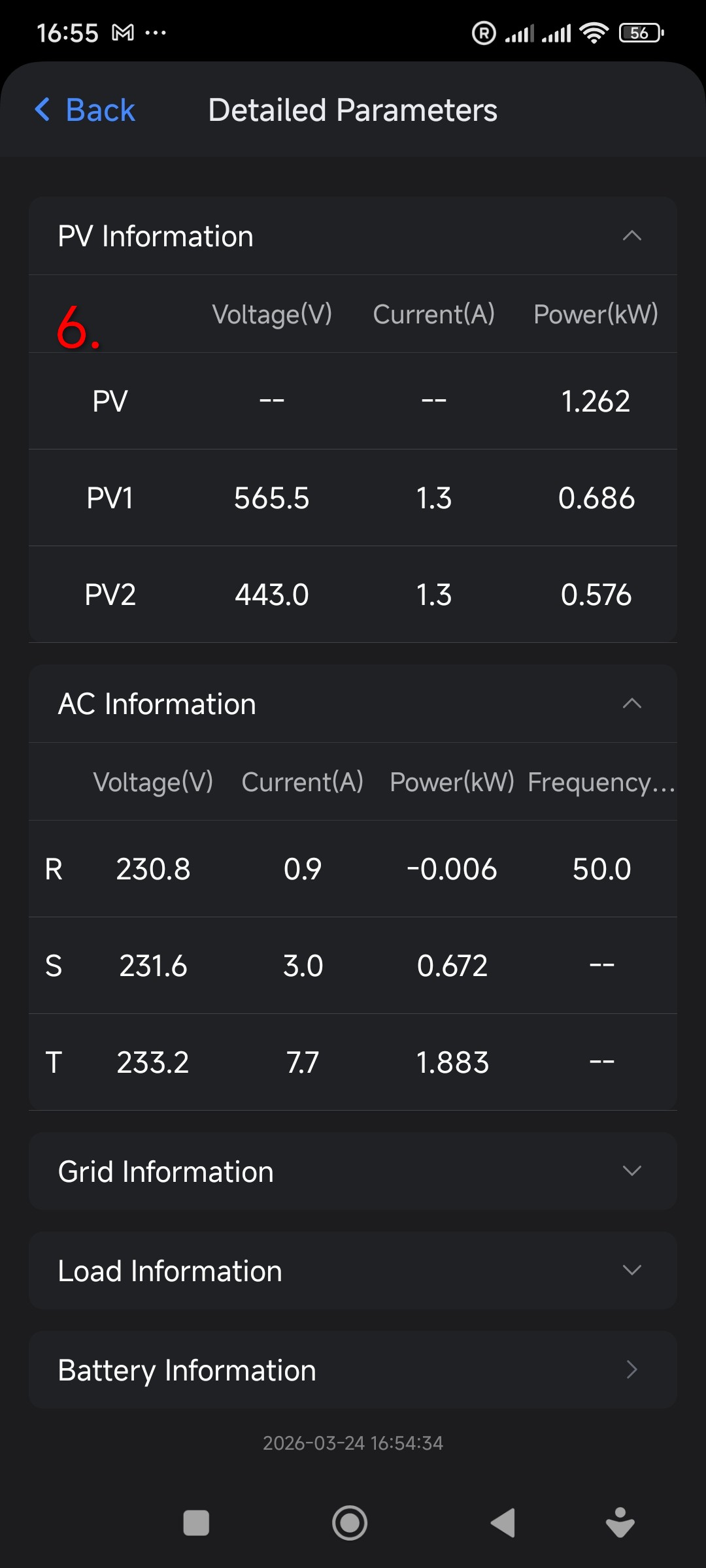

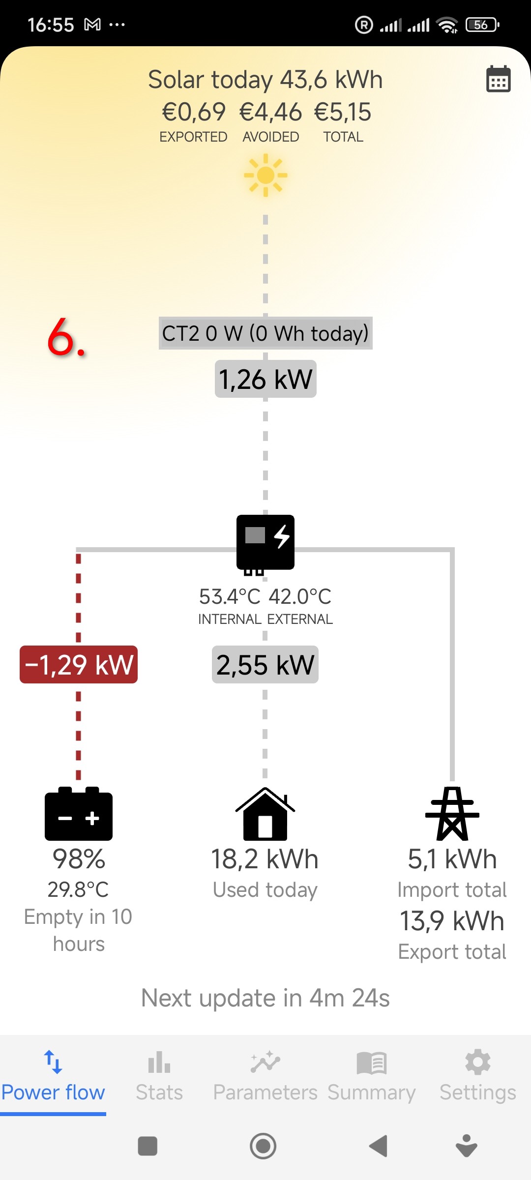

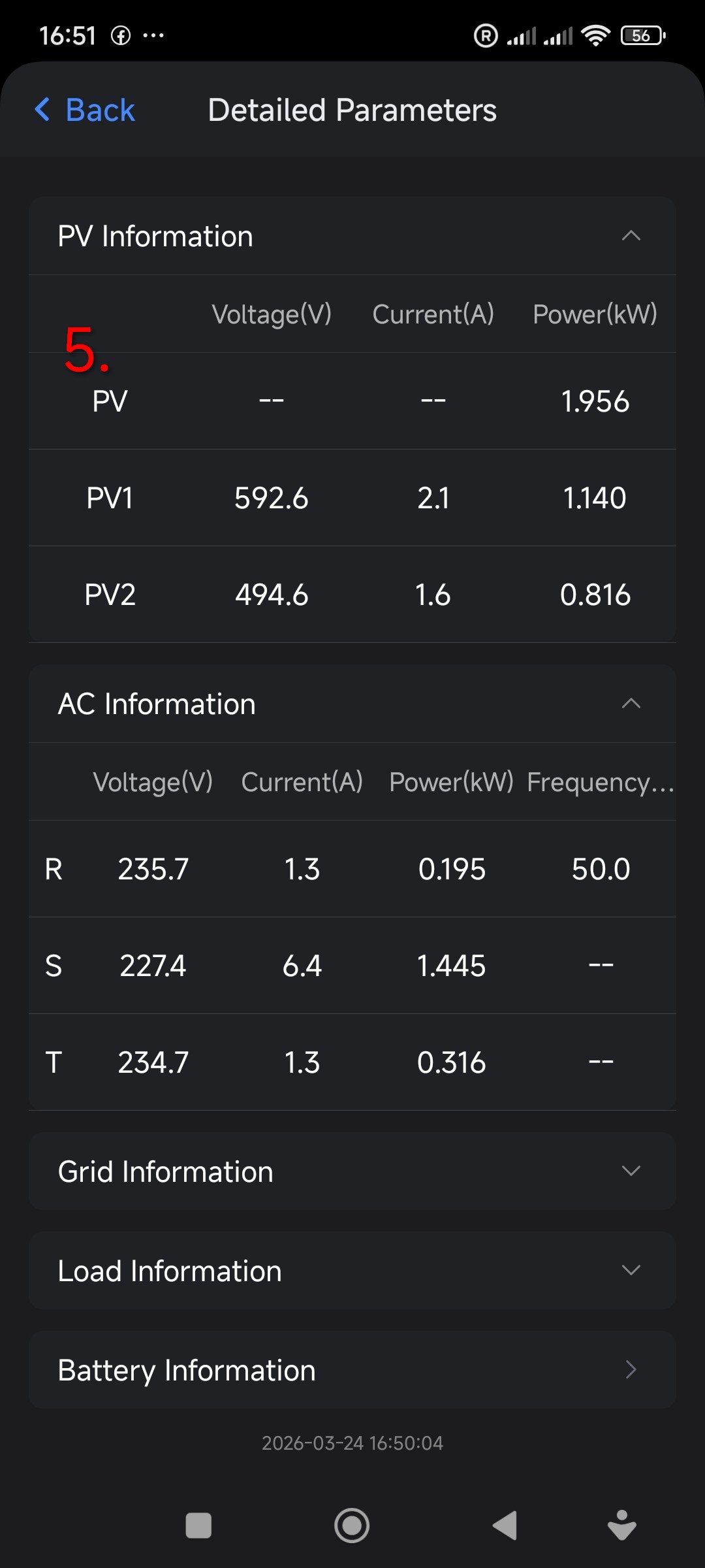

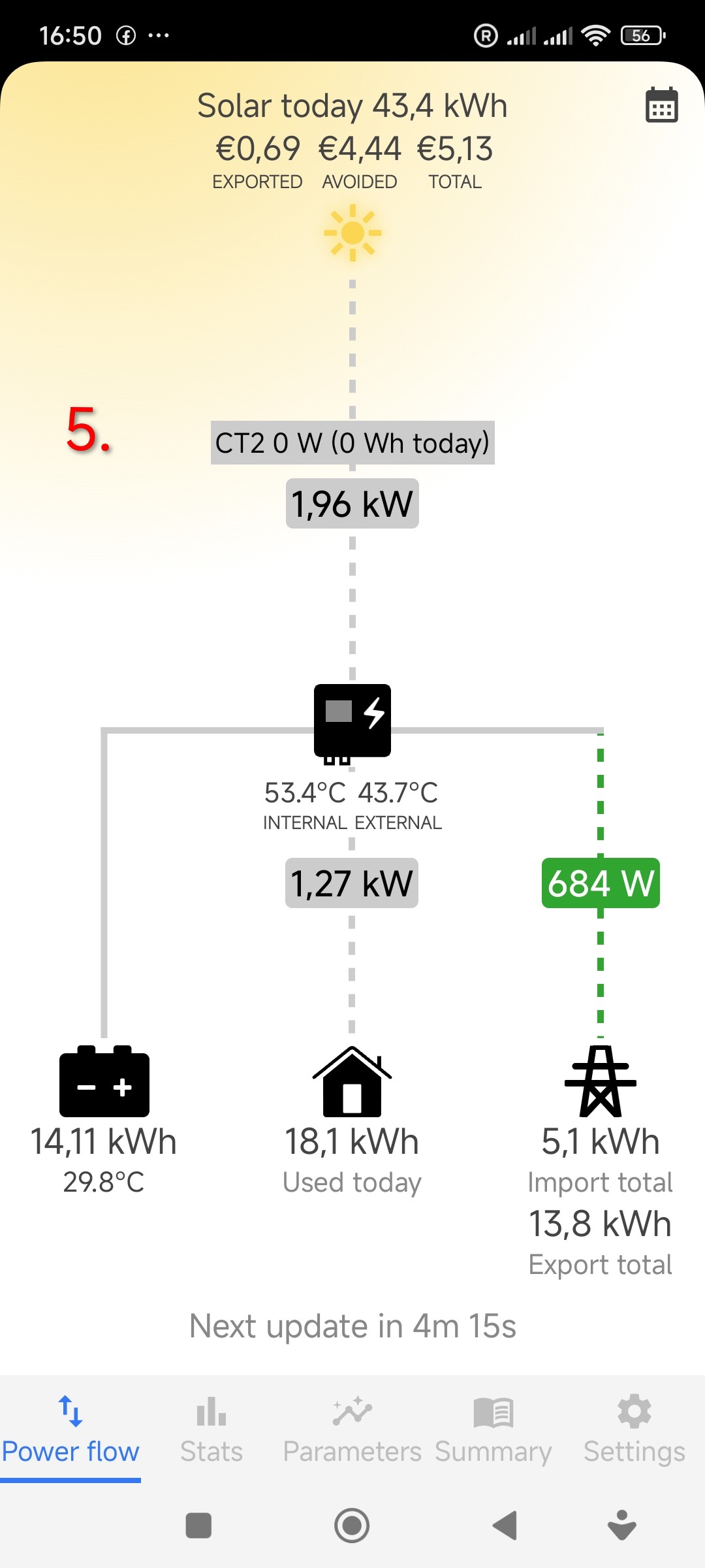

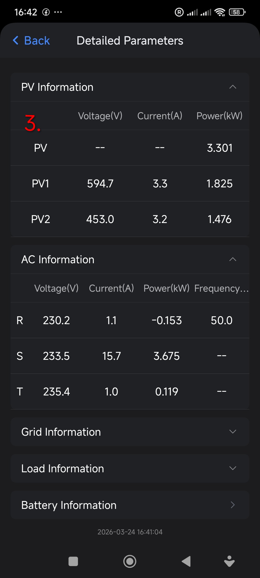

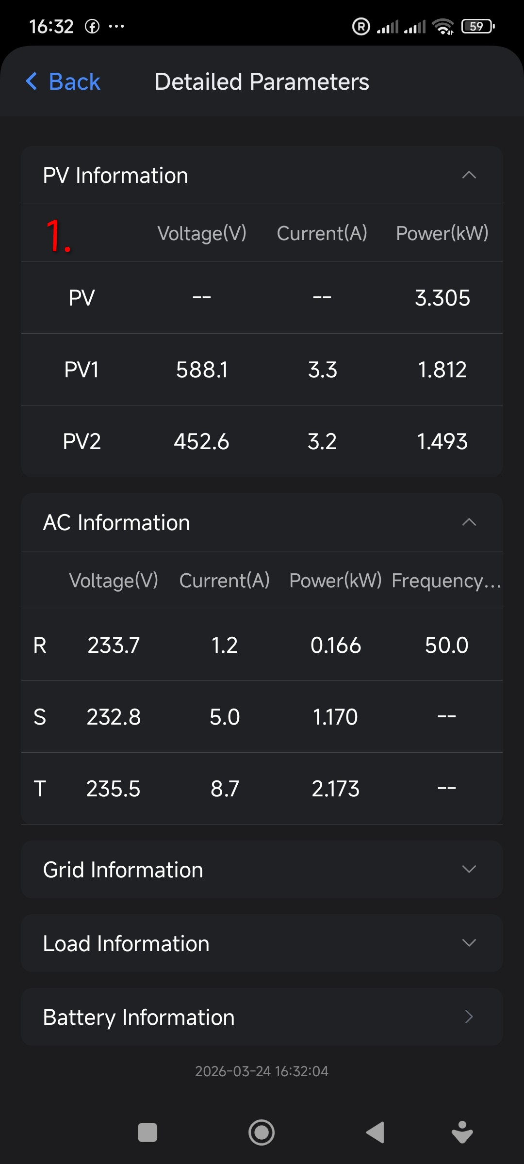

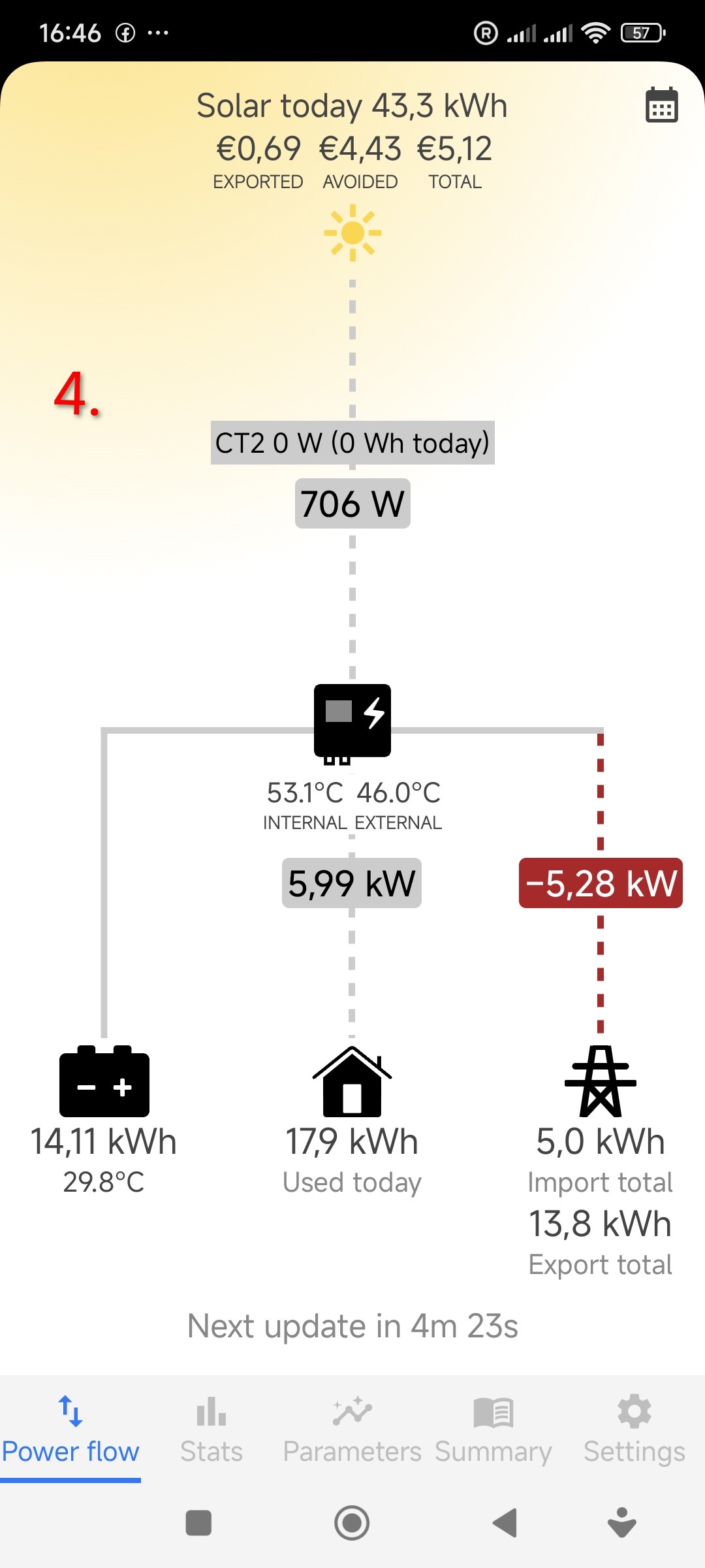

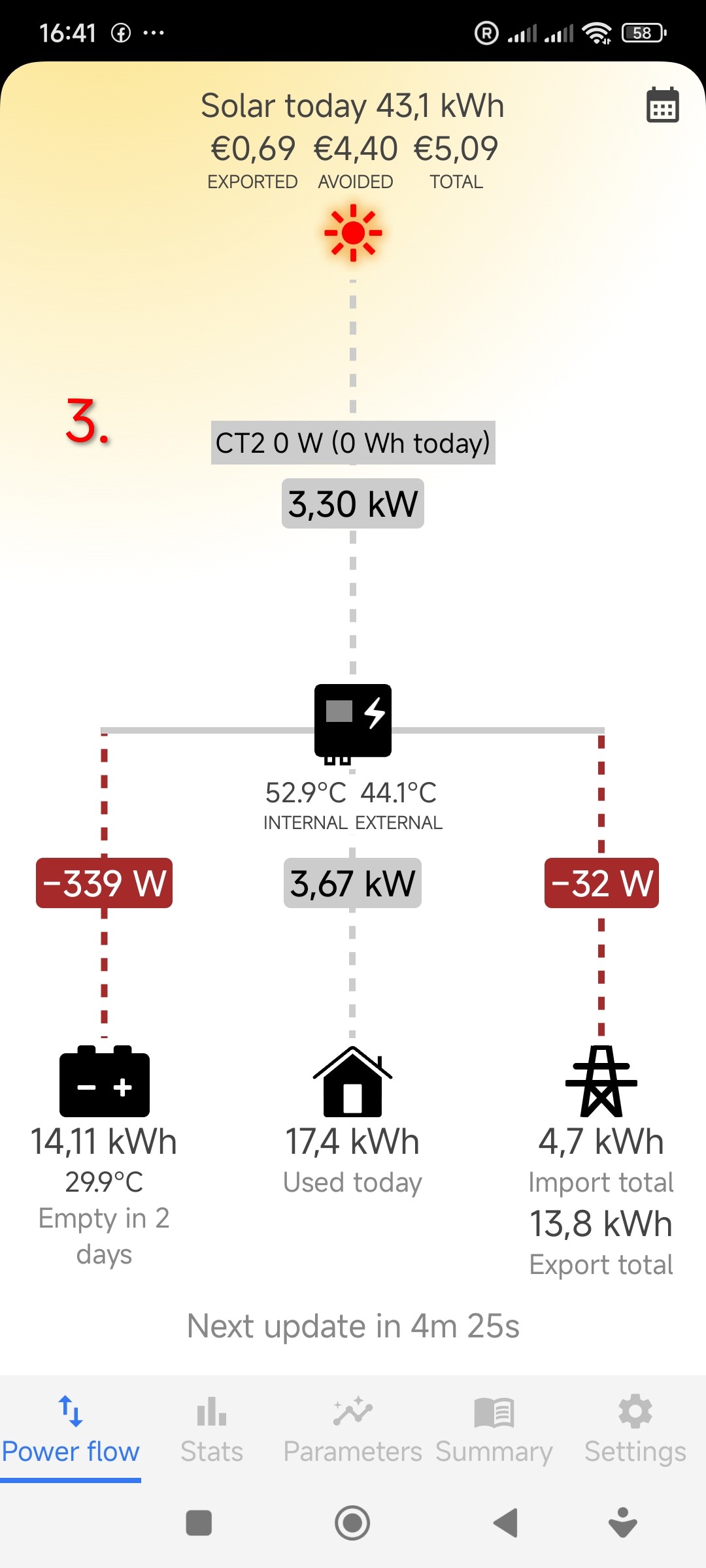

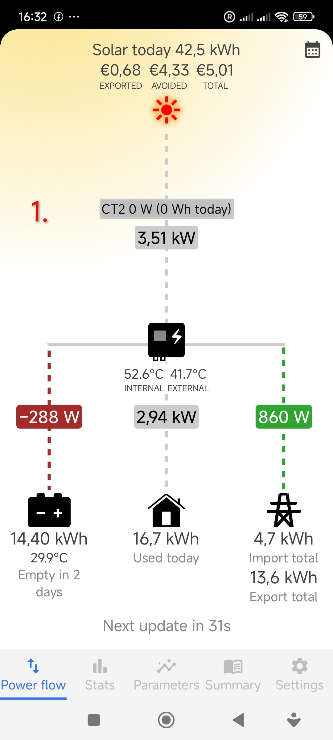

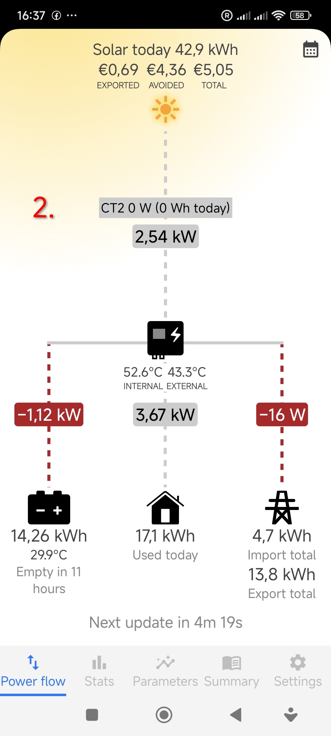

Here are the test results from the beginning (1st) through various high loads to the final low load (6th).
