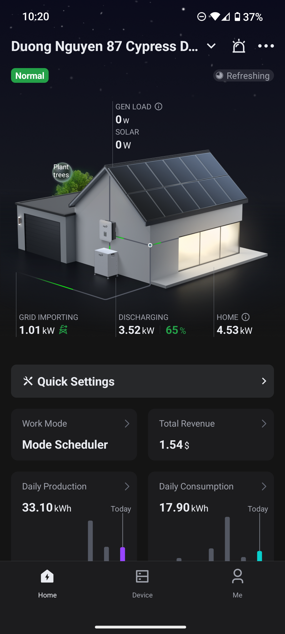

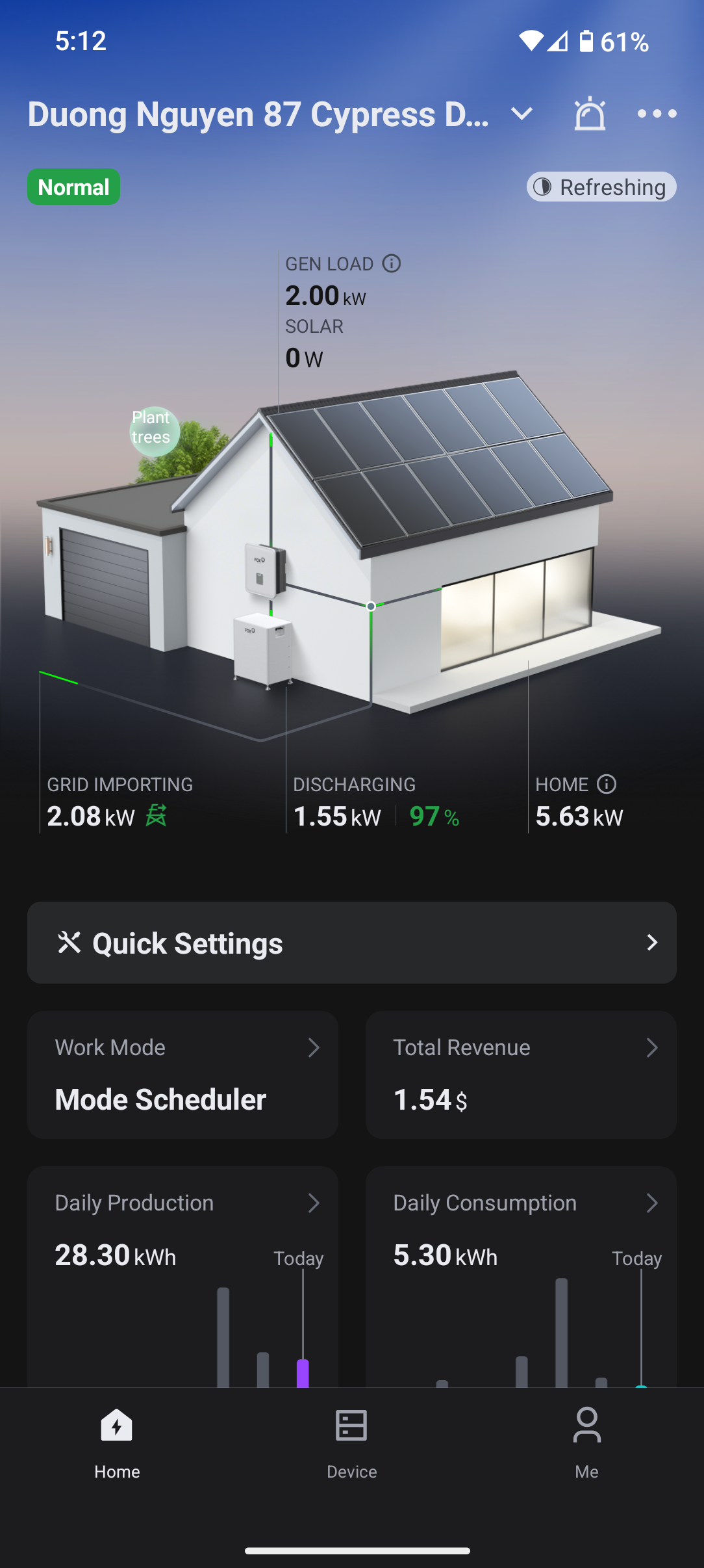

Today, I used my air conditioner for the first time since having the system installed. When watching the Foxcloud app, I noticed a constant draw of 2.0-2.5kW from the grid and only 1-1.5kW from the battery. I have attached a screenshot from the app after running the air conditioner for about 40-45mins
I was wondering why the system was drawing so much from the grid. I expected there to be temporary draw from the grid on start up but then the hybrid inverter would sense the increase load and increase battery output accordingly after which power drawn from the grid would decrease significantly.

My system is also AC coupled like yours, monitoring a 5kw inverter. I would have expected the the battery to have been able to make up the difference given that the house load was 5kW, and incoming solar was 2kW so the battery should have made up the remaining 3kW.
I have also tried running the air condition later on at night when solar was not working however the system was still pulling a bit over 1kW from the grid.
