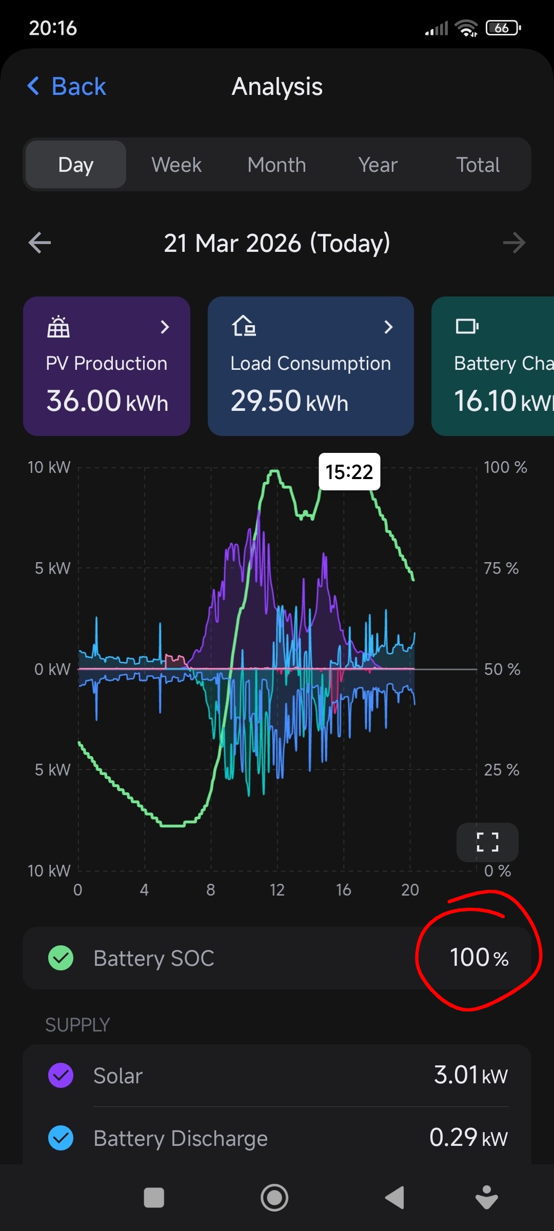

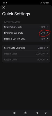

I see that the new udate has arrived on V. 2.2.4. Incredible result max SOC is set to 94%. But the battery charges to 100%. What is happening with the update. My setting before the update was set to 100%. Thanks and all the best

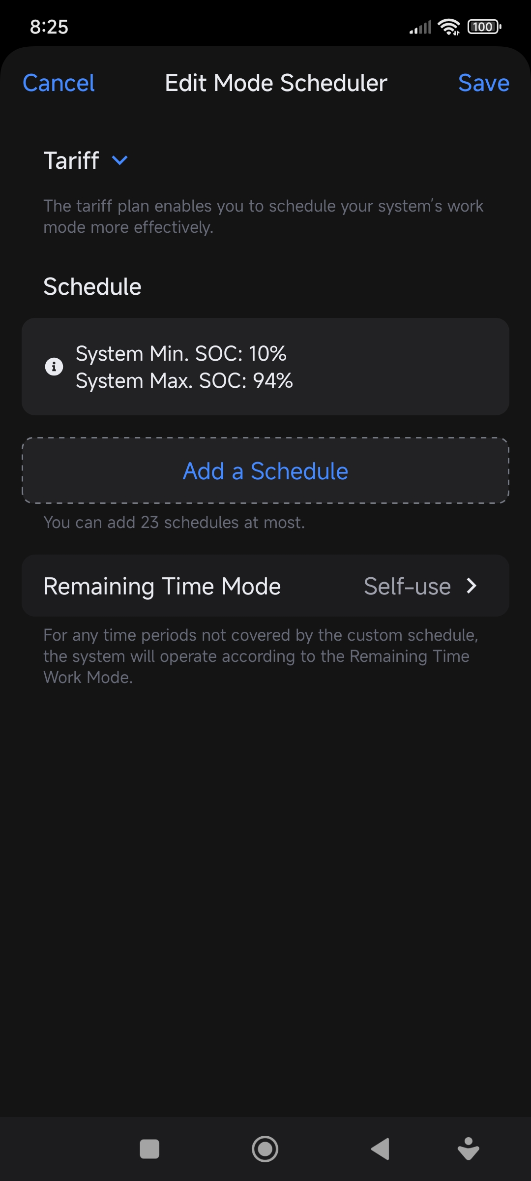

If you are charging by schedule, what do you have for maxSoC for the schedule?
I did not set the mode scheduler. I am attaching a picture. Now I have changed the max SOC to 100%. It is still a mystery how it is that despite it being set to 94% and it is charging at 100%. Thanks and all the best

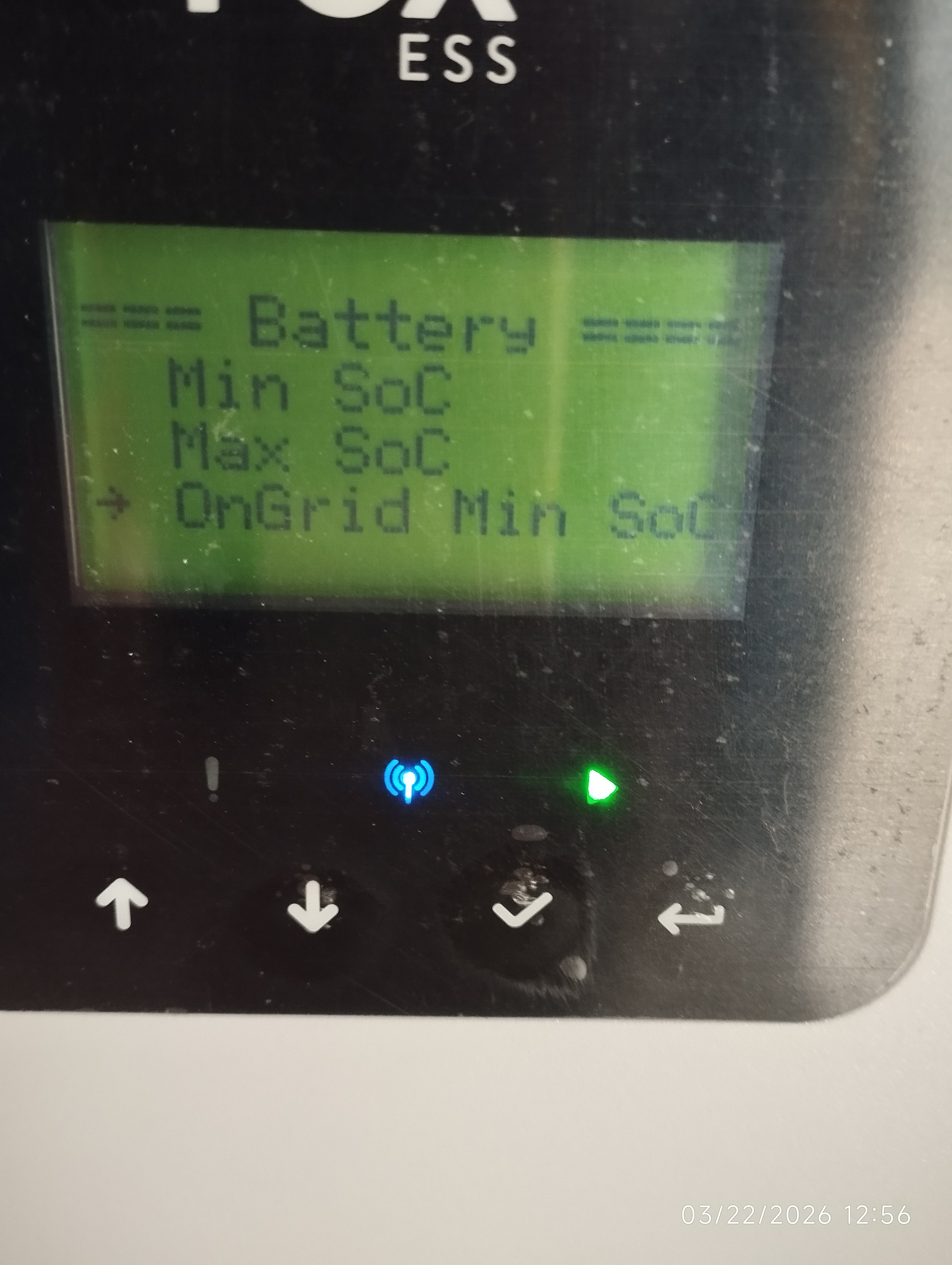

At your inverter panel go into Settings, Battery and see if you now have 2 settings for MaxSoC one is System MaxSoC the second is MaxSoC from grid - this appeared in a recent update on KH inverters so possibly also true of the H3 we believe that one limits the max charge soc from grid and the other from any charging source.
Only one of them is accessible via the app but if there you will see both in the Inverter Settings (or in Settings in the website if you have installer access).

In the settings there is only max SOC and no maxSOC on grid is visible

Can you pick a SoC figure between 95% and 99% and look for battery charge on your graph.
This is so we can check to see if the battery took a charge, that was measured.
