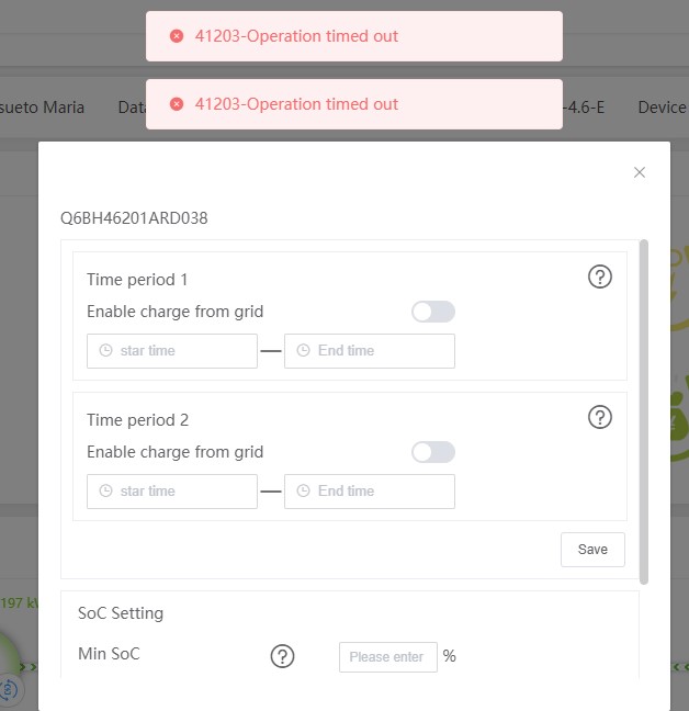

However i'have trouble opening the pop-up from pc for time out ad same situation if i try from the smartphone
See the screen shot
It's correct to set the threshold (min soc) to 10 ?
Why also set the on grid threshold ?
Many thanks

Do you want the battery to not charge above 90%? Or not fall below 90%? I'm not clear. There is a Max SoC setting but it only applies to charging from the grid, if there is enough solar PV available the battery will charge to 100% from it.
There's two MinSoC settings, as you might want a different threshold if you're using the system offgrid as opposed to grid connected. The early firmware in the BMS wasn't great at managing battery charge levels so some people were warned by their installers not to go below 20% as a safety buffer. That said, if you're on the latest firmware for everything then 10% is a sensible minimum (and is also the lowest that the BMS will allow).
