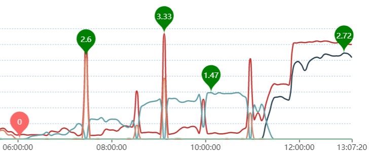

On and before 25-May, we had the expected output trace – a nicely curved "blob" slowly increasing from 8AM to a 1230 peak @4.8KW approx., then slowly decreasing until 5 or 6PM.
But since 26-May I have had a strange "stepped" output trace and much reduced power generation. On a perfect sunny day, output gets to 1.7/1.8KW by 0930ish and stays flat for a couple of hours, then shortly before midday it suddenly shoots up to 3.2KW where it again stay flat until it starts decreasing as the sun goes down. Please see attached screenshot of yesterday's trace. And as I type this, exactly the same thing has just happened at 11:40 - one minute we were generating 1.8KW, the next 3.2KW with no change in conditions. But it'll stay here now an hour or two before starting to decrease, it definitely won't hit the 4.8KW high at 1230ish we were enjoying a month ago.

Update: I've emailed Fox Support. If anybody else has seen output traces similar to mine I'd love to hear about it please. Today the same again - 1.7KW PV output all the while the battery was changing and for 20mins afterwards; then suddenly PV leapt to 3KW (which is yay, but just 60% of potential) and held for an hour or so, and is now decreasing again as the sun goes down. I should have fed in LOADS the last three weeks but no - this install is not going to pay for itself within 10yrs as originally calculated :cry:

Yesterday things improved somewhat with a smoothly incremental rise in PV generation until midday, peaking at 4.5KW. But I don't believe everything is quite right, as by 5PM we were only generating 500W in perfect conditions vs 1.6KW same time last month. I will keep this thread posted :)
