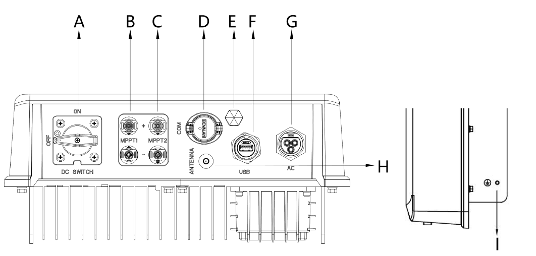

Under your Inverter, you should see a physical DC isolator, I presume this is set to On right now?
It might be worth turning it off at this isolator, and on again.
Can you let us know if you are using both string inputs under the bottom MPPT1 & MPPT2 also, or just MPPT1.
