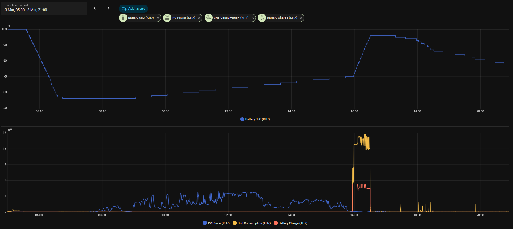

Overnight my battery charged to 100%, and in the morning it discharged for 1hr, down to 56% SoC. It was stable for a few hours, and it then increased 71%.
I use Feed-in mode during the daytime, and only if the PV is way it could have charged (if I go over my export limit) but today it didn't go above the 3.9kW export enough to fill the battery.
That just looks like your system charged from the grid at 16:00. Maybe a settings glitch or something for battery health but the grid import matches the battery charge and some significant load in the house for 15 minutes or so.

4pm was a cheap IOG slot for car charging.
I suspect that the PV was charging the battery, though it does not actually show this on then system logs.
