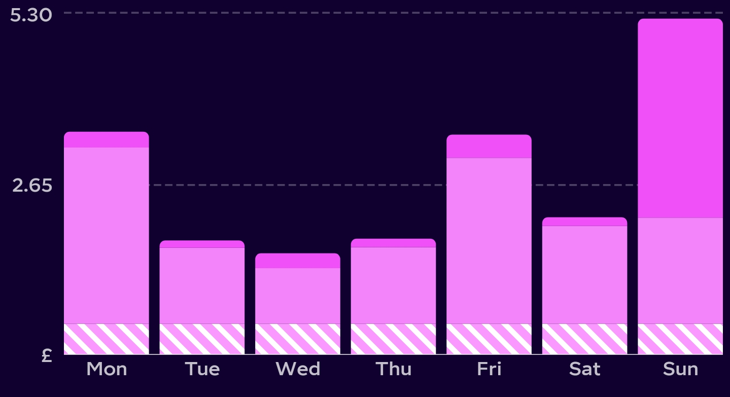

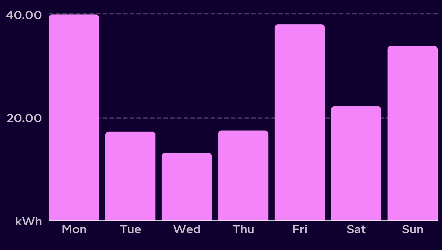

If you look at this first picture, you will see Sunday used less power than Monday
If you now look at the estimate costs, Sunday looks much higher.
If I wait for Tuesday or Wednesday, this will recalculate and Sunday cost will drop.
