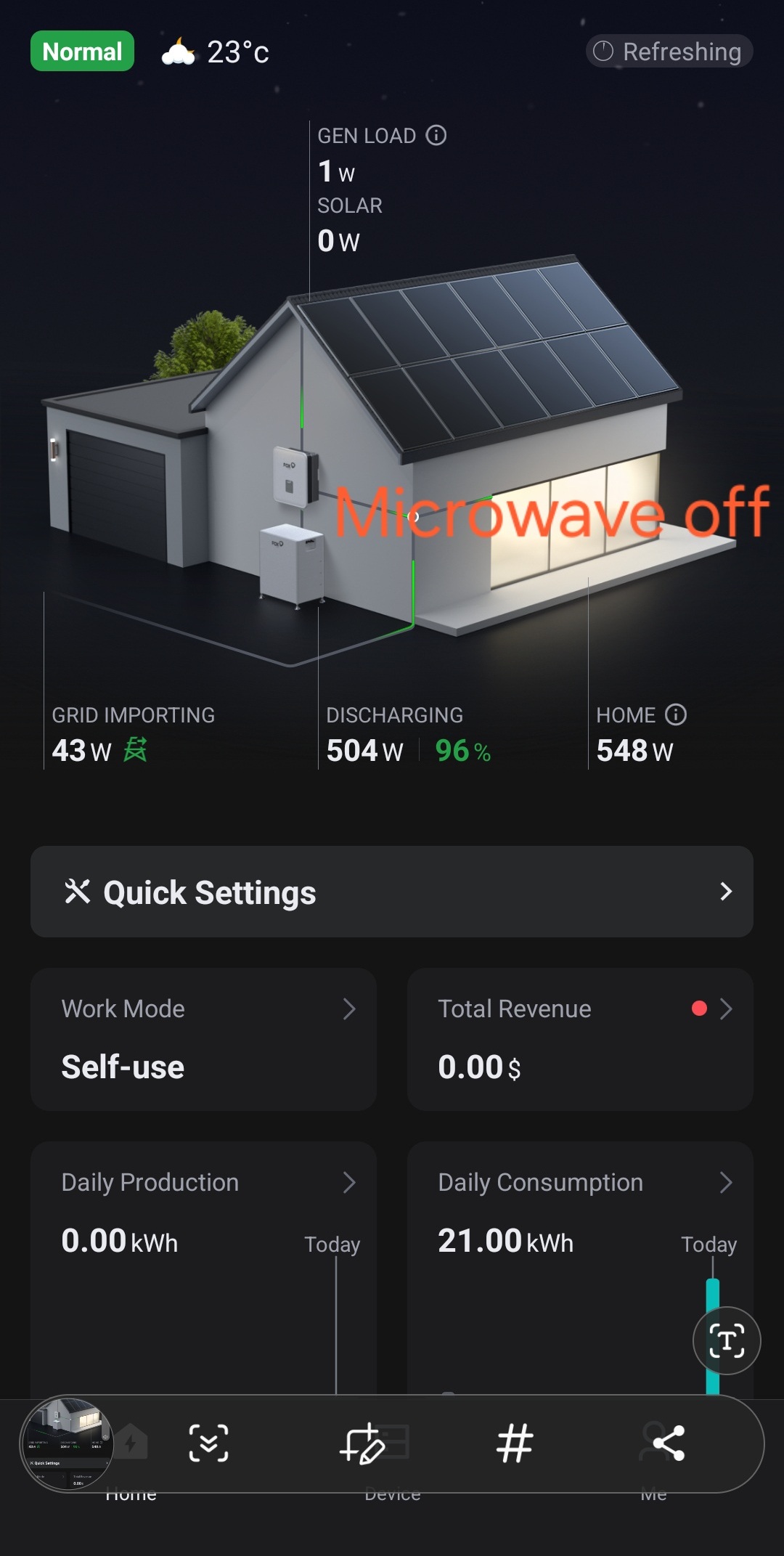

Yes, I suspect something is detecting one of the phases backwards, given these two grabs, first at night with not much running, 548W being used in the whole house:
and then if i turn the microwave on:
you can see it looks like the microwave is providing power - i wish it was! But I'm actually pulling power from the grid instead, plus there's no way my microwave is using 3.7+kW, i.e., the off-set of the previous 500W and -4.21kW, I think it's 1.2kW model, if that.

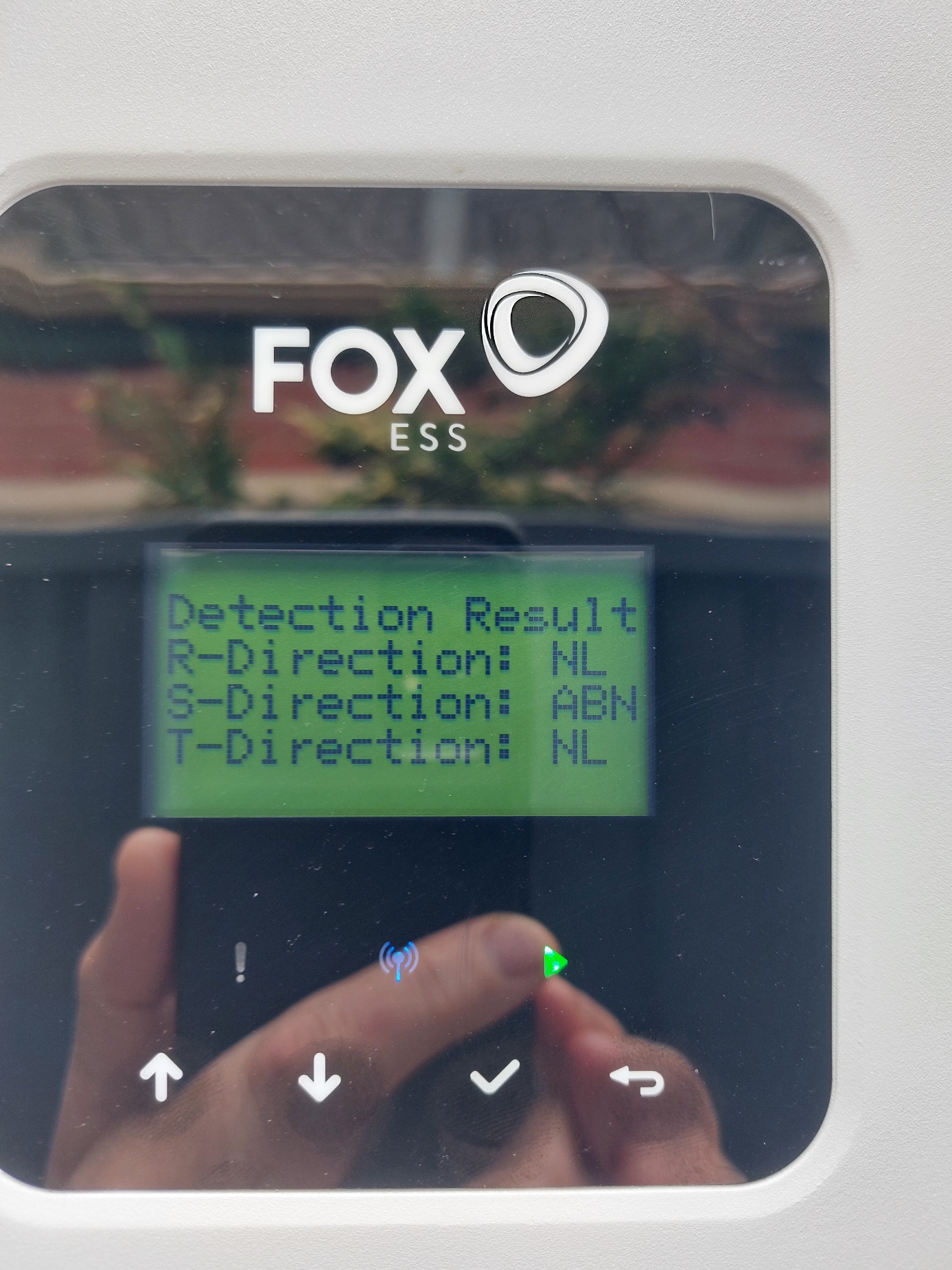

Ok, so after a lot of querying various sources and looking into the various 'Setting' menu options on the inverter, I have finally resolved this myself.
Firstly I ran the diagnostic option found under the Settings > Features > Meter area on the inverter; this reported that the S phase was "ABN" - what i assumed correctly was that this means the detection process didn't like what it saw "Abnormal", versus the R and T phases which showed as "NL" - again, assumed to mean "Normal".
So, based on this - and a wing and a prayer - I used the 'reverse enable' option for the S phase to correct what basically shows that the electrician has wired the CT meter / feed back-to-front. Groan. This was quite frustrating for me as a totally new owner with little information except scraps and tid-bits of info on the net, also somewhat nerve-wracking given I pretty much had little idea if this would fix it. Fortunately it did fix the main issue noted above, that some appliances - the ones on the S phase circuit - would show as generating power when used, which is obviously completely wrong, and in fact caused me to pull power from the grid, instead of saving power!
