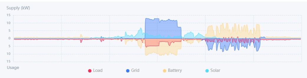

I have a new setup, with a schedule setup to force discharge from 4pm to 9pm (this when I get maximum Feed in Tariff) with the following settings,
Time 16:00 - 21:00
Work Mode Force Discharge
Min SOC on grid 10
Max. SOC 100
Forced discharge cutoff SOC (FDSOC) 30
MAX. AC power for forced discharge (FDPwr) 10000
When I have a cloudy day and no PV production after 4pm my system will discharge to grid and reach the FDSOC of 30% before 9pm, usually around ~ 8.30pm then the system will draw from the grid for 30min up to 9pm and not the battery, after which it will draw from the battery for the rest of the night. On days that I have PV after 4pm it does not become an issue.
So my question is does the schedule (time period) take priority, other than reducing the time period is there a way to make the system draw from the battery when the FDSOC reaches the 30% regardless of the time setting?
Inverter KH9.9
Battery EQ4800

Thanks for replying, to be clear I have the grid cut off at 30% so I have enough reserve to cover the night and the next morning, until either the PV starts to charge or the 11am free power kicks in to charge the battery. (Glowbird Zero Hero Plan)
