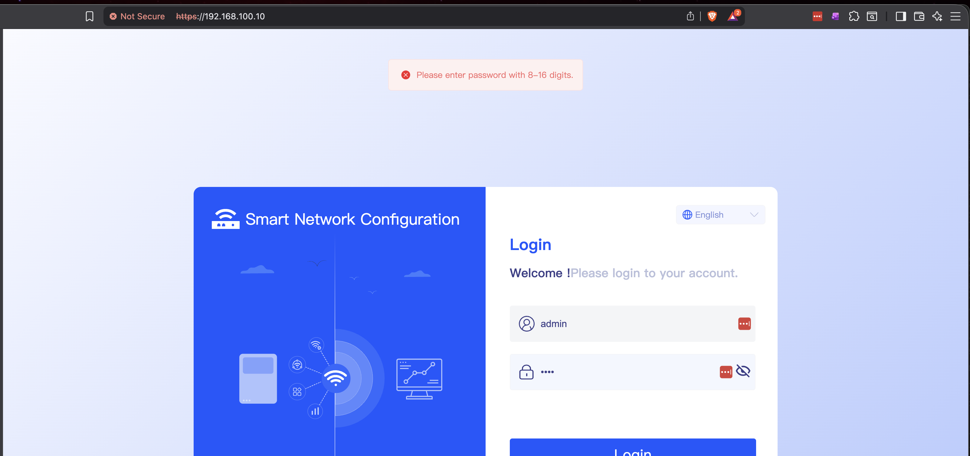

Hi Team,
Seems it was 8 characters and not 4:
![Image]()
Actually,
0,0,0,0 Does not work, seems to just disconnect.
The default is 12345678 but getting in doesn't get you anywhere.
Yup, same error "check network and reconnect".
Like somehow the system thinks that I want to login, enter the password and just as I press enter I disconnect my network...
So im not able to login and get the details of ImportLimitPwr and ImportLimitCur.
