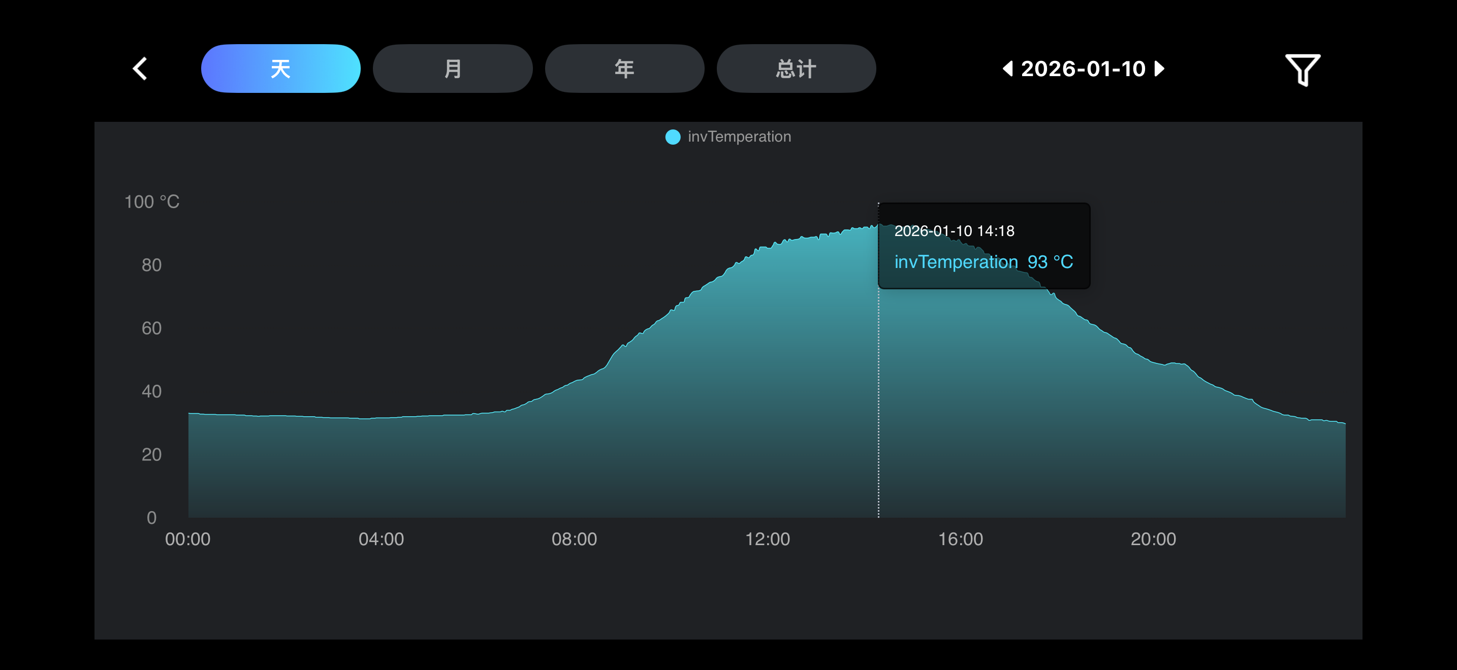

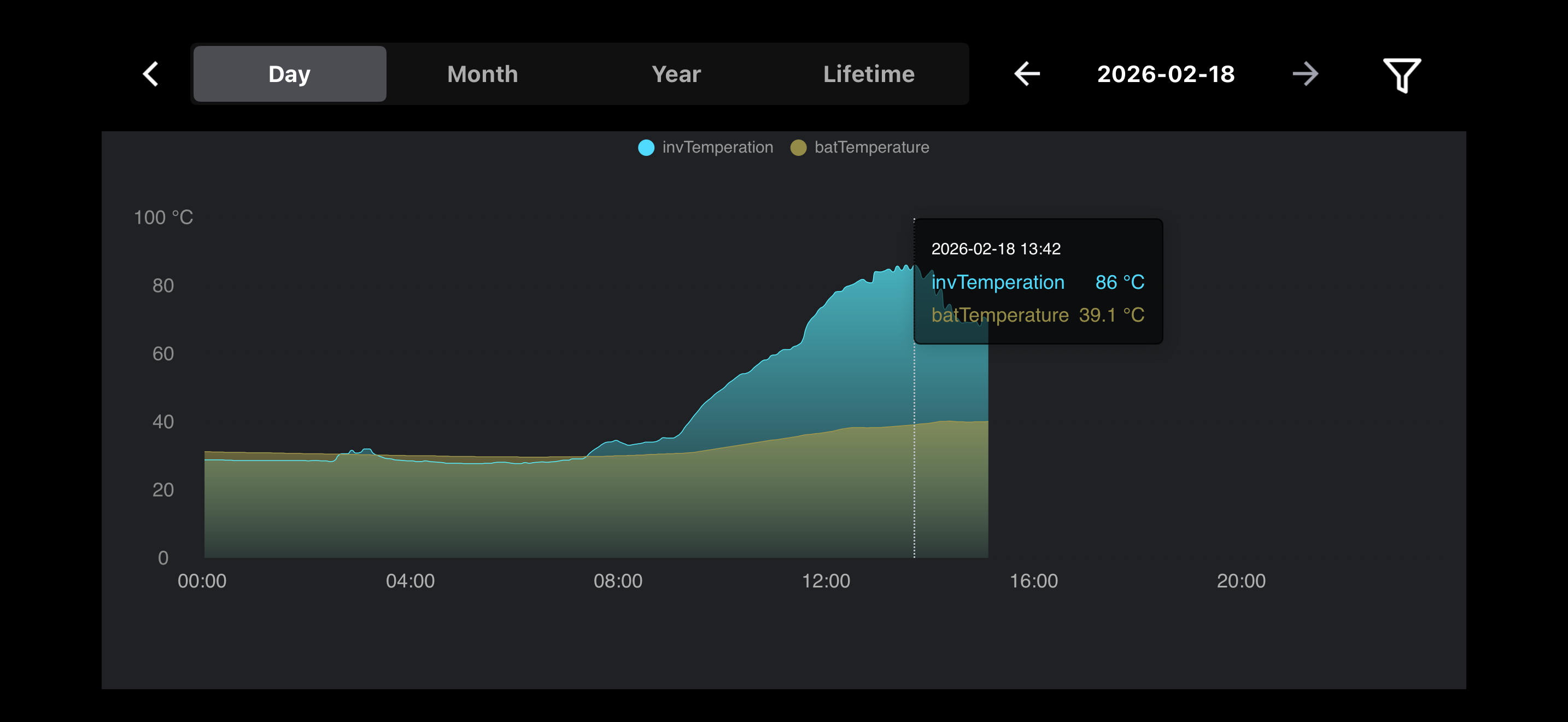

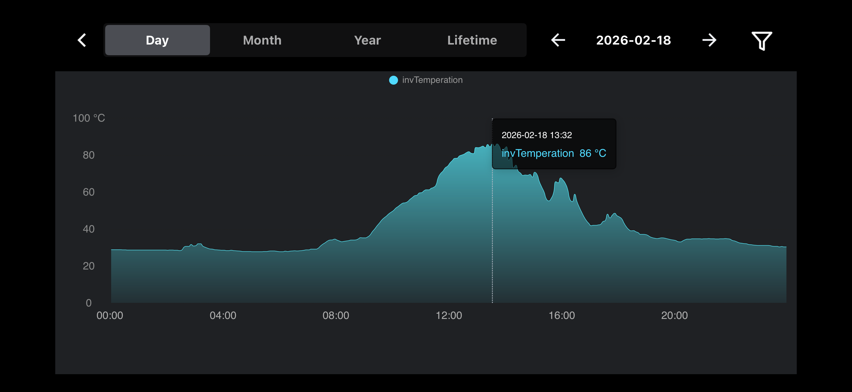

Such excessive temperatures raise serious questions about the product quality and system safety. I am particularly worried about the potential safety risks, including equipment failure and the possibility of fire hazards that could endanger the property and occupants.

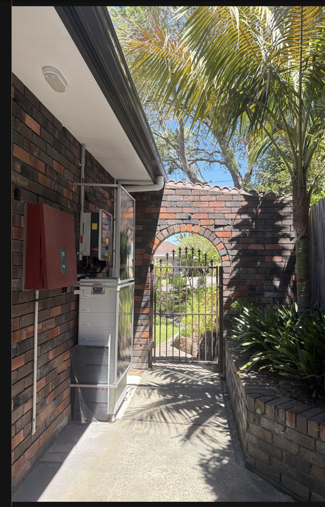

The inverter is new and installed outdoor with shade on by a qualified electrician. The inverter faces west but there are also trees on its west side and nearly no direct sunlight reaching.
Does these such high inverter temperatures mean a product failure? Should I ask Fox to replace a new one?
