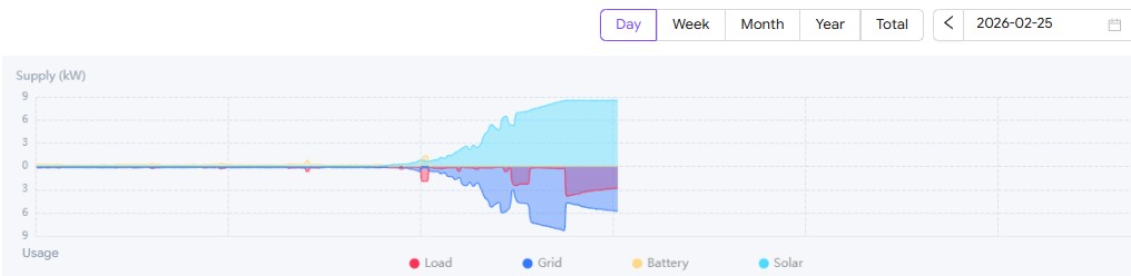

today I started Mode Scheduler from my phone. I put Feed-in Priority from 7-11:00 with intend not to charge battery.
Everything looks fine til 11:00. After 11:00 it seems that battery is charging but data on graphs (app on phone and V2 on desktop) shows unlogical data. PV limited at 8.57kW (Tigo app shows 9.5kW), charging batt = 0kW, load around 3 kW (nobody at home - house is in sleep mode)... but I can see the level of battery is incresing.
I found that there are some problems with new version of app so it might be it (?) ... any idea what to do?
G.
