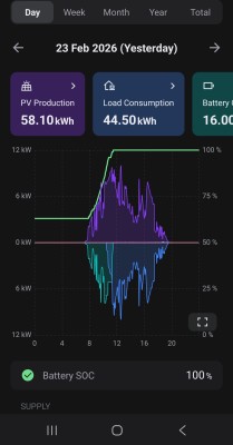

In the app if you could click on Daily Production and post that graph it would help to diagnose, but from what you have said It does sound like your inverter is not reading the CT clamp.

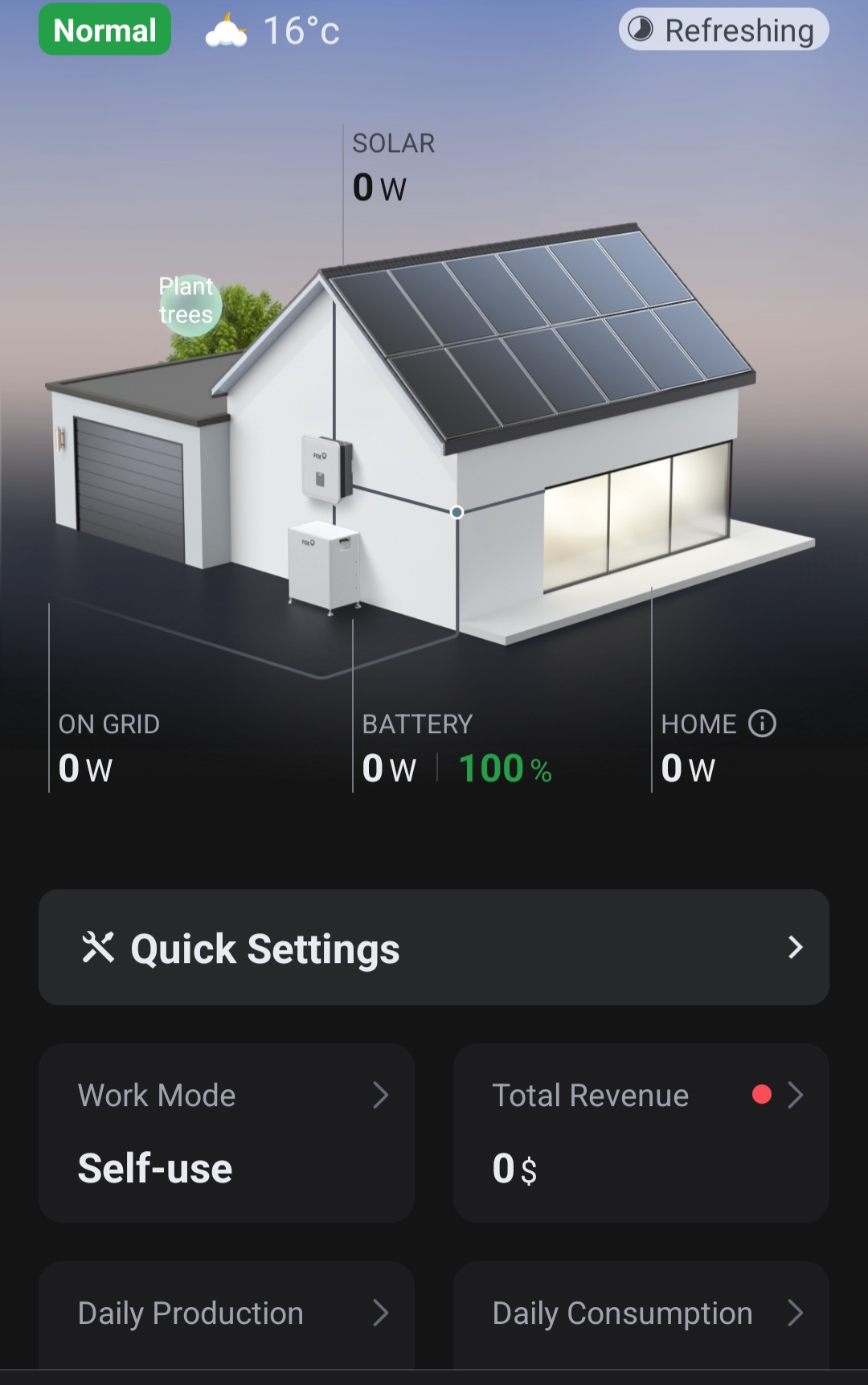

I found that video myself but didnt want to try anything given it is a new install. Last night nothing changed, battery remained at 100% and everything else at 0w.
It looks like I couldn't get it to use the battery at all through night.
Very frustrating

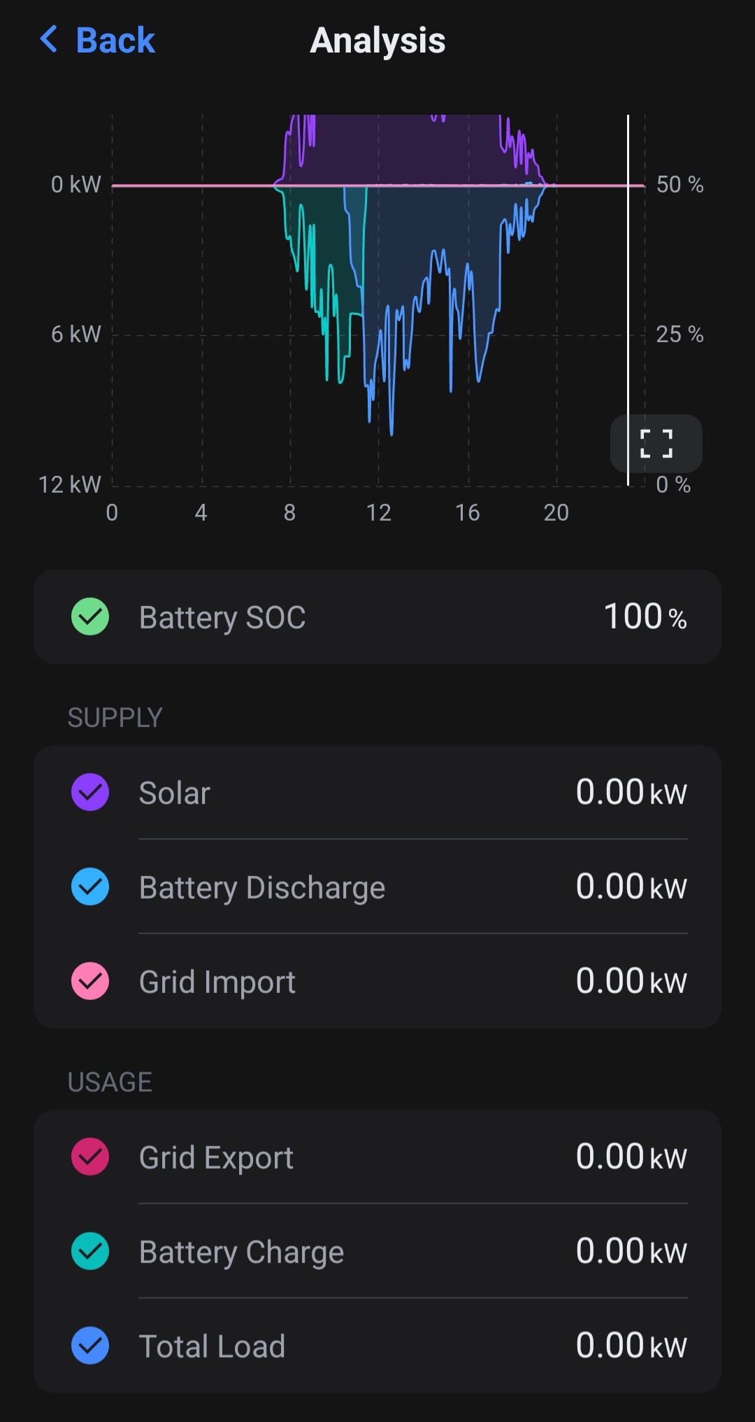

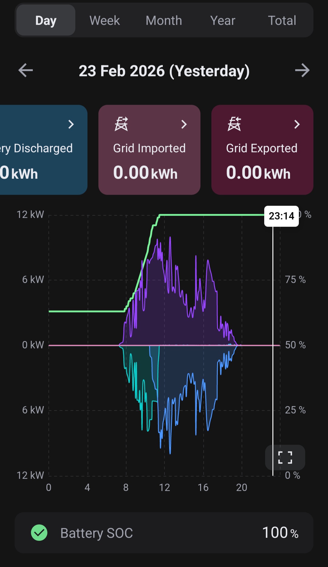

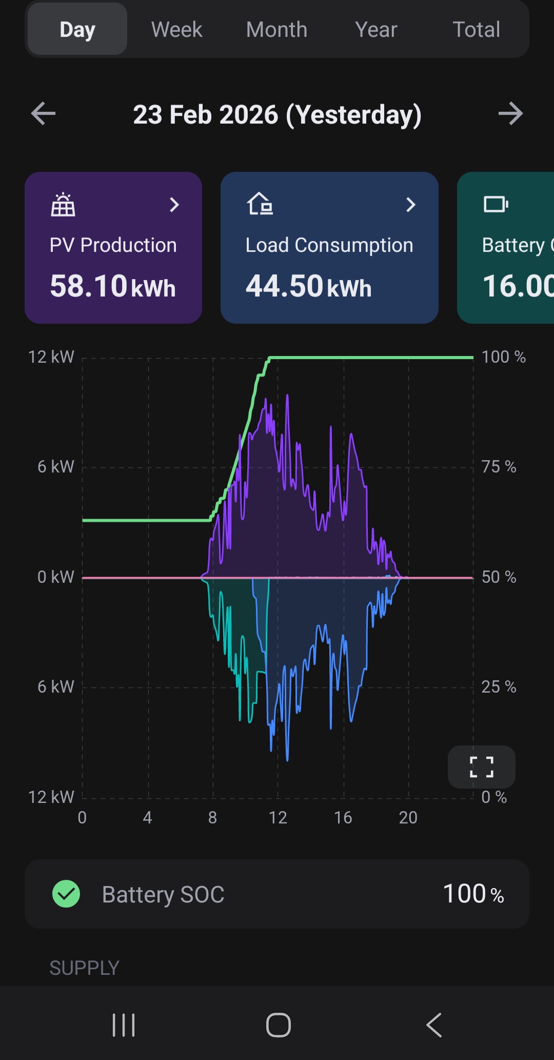

I have attached images of what i see this morning and yesterday's production.
Really appreciate the help.

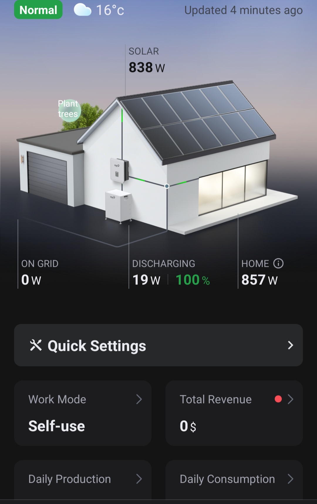

This is what happens as daylight comes.

Yes definitely looks like your CT is not reading, so either it has become disabled or there’s a wiring fault.
Thanks for following and help.
I will check the setting and contact the installer.
Would this also cause the problem that through night I wasnt using my battery at all?
Yes, the system cannot measure any load without it so it’s unable to balance it from the battery - at the moment it’s working more like a solar only inverter than a hybrid.
