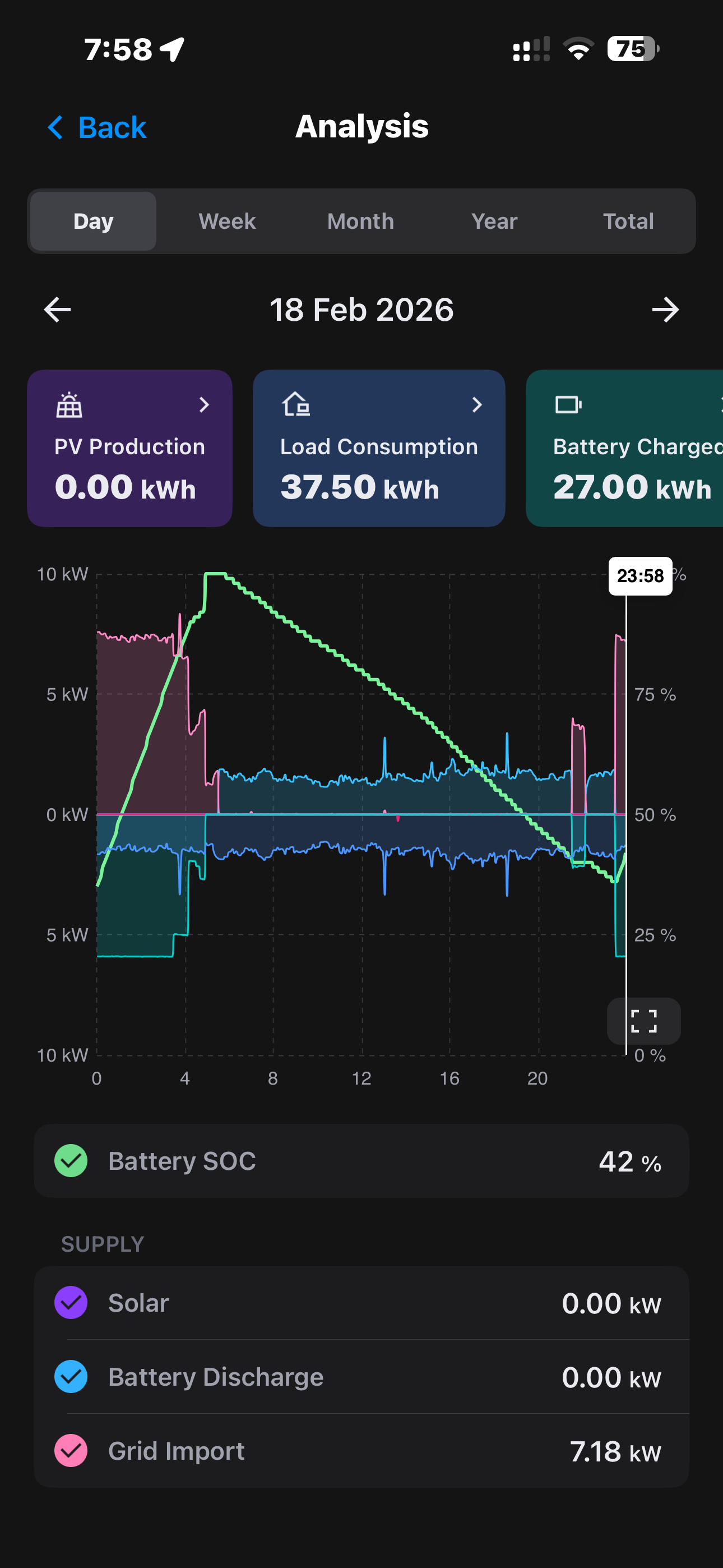

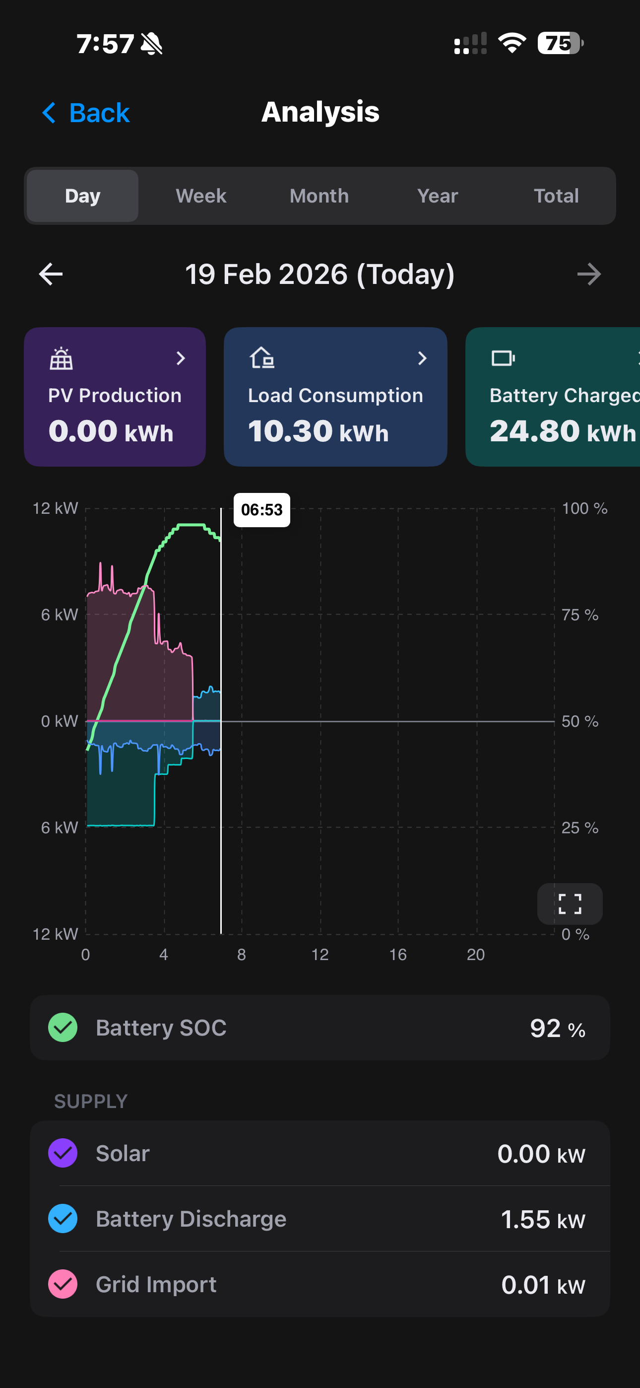

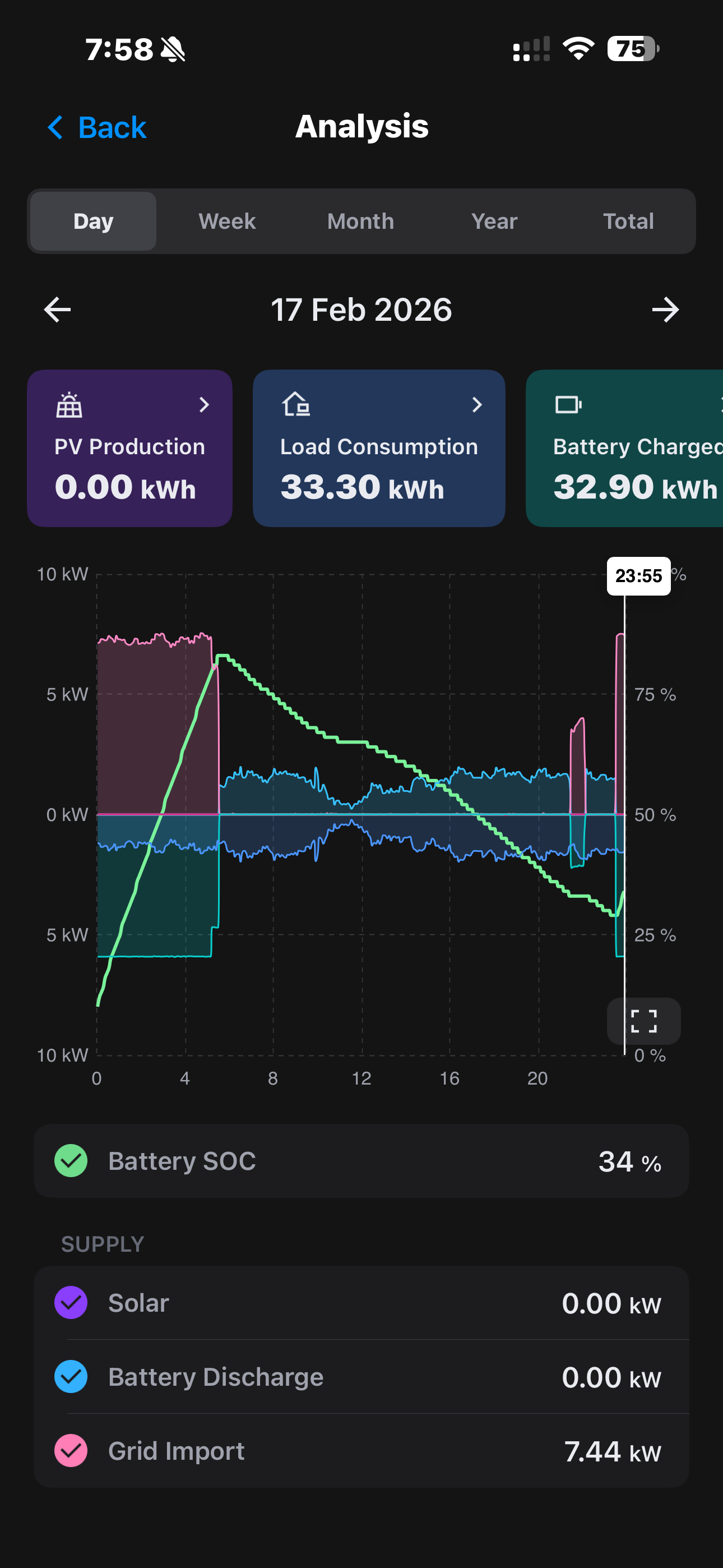

I have an h1 6kw g2 inverter, 4xEP12 batteries and charge with home assistant through Intelligent octopus Go. After the success of getting the home assistant to work and charge batteries when the off peak tariff triggers I am now getting very strange behaviour in that the inverter is switching to grid import randomly ( my EV is not plugged in) and also not hitting 100% charge and throttling back sometime two hours before the end of the off peak charging period. Any thoughts
The first and third graphs it looks like there was just not enough time in the charge slot to reach 100%, a full charge from 10% SoC of 4x EP12 with a 6kW inverter in a 6 hour slot is a bit of a stretch, you would need at least 7 hours to charge from 10 to 100%. The throttling as you near 100% is most likely the BMS performing balancing of cell charge.
Do you have battery heating enabled? If "charge from grid" is set then if SoC is less than 40% and battery cell temp drops below the trigger level then that may explain your random imports. With 4x EP12 you may see about 1.5kW going into the battery when heating from grid (based on what I see with 2x EP11)

As nrb501 has mentioned, you are going to struggle with the 6kW x 6hrs to fill 4xEP12's from empty to full. You can get around 36kWh added, that you see on the 17th, it didn't make 100% SoC. The other times you either had an extra bump from IOG, or just had a little more left at 23:29 that got you to 100% SoC

Thanks everyone, I can see absolutely that the discharge stop happened exactly as my battery warm up schedule switches on so that makes a lot of sense.
