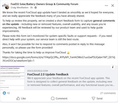

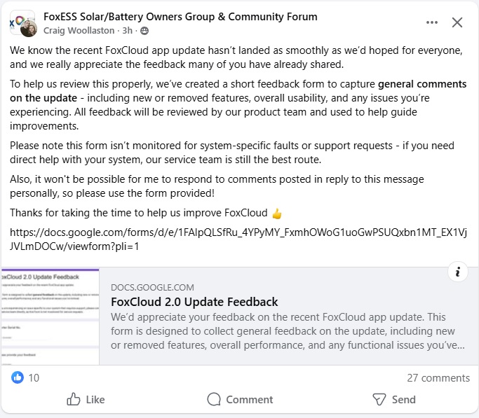

I'm posting this in it's entirety from Craig Woollaston (Fox UK service director) who is asking for specific feedback on the recent app update, if you click on the photo it will expand to read it.
