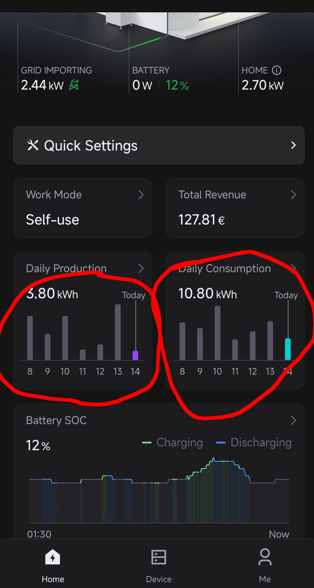

With the new update ( V 2.2.1), even smaller problems have appeared, the display columns on the chart that were colored the previous day are now gray.
