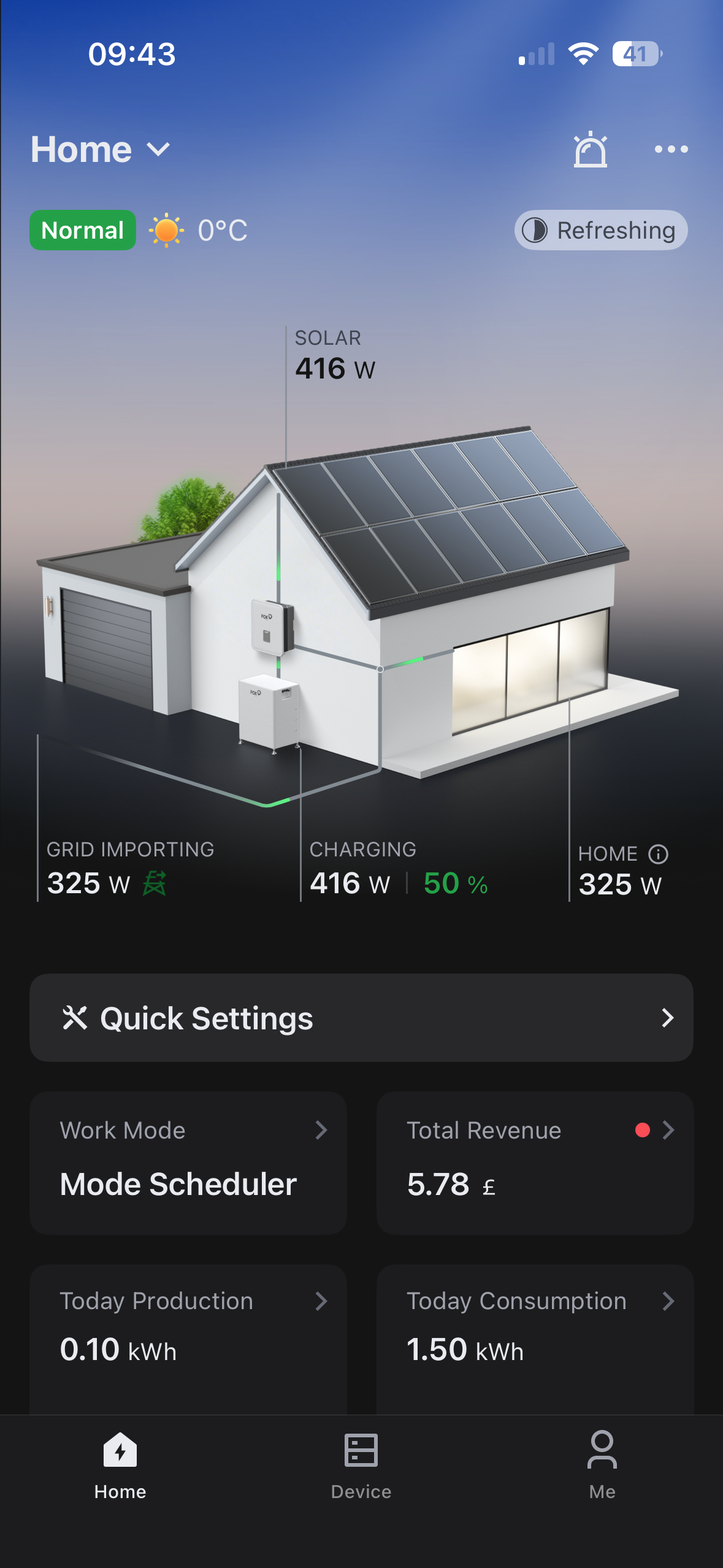

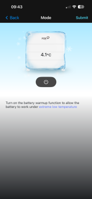

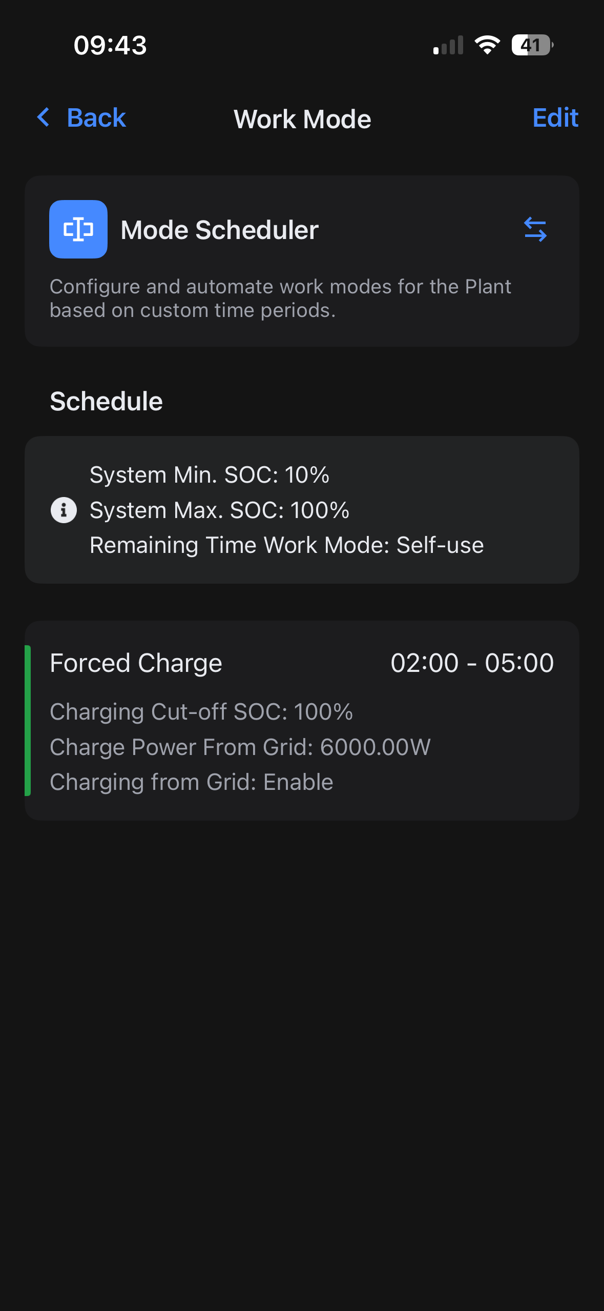

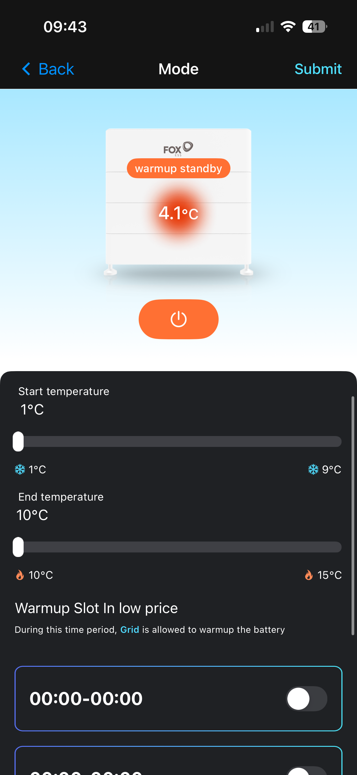

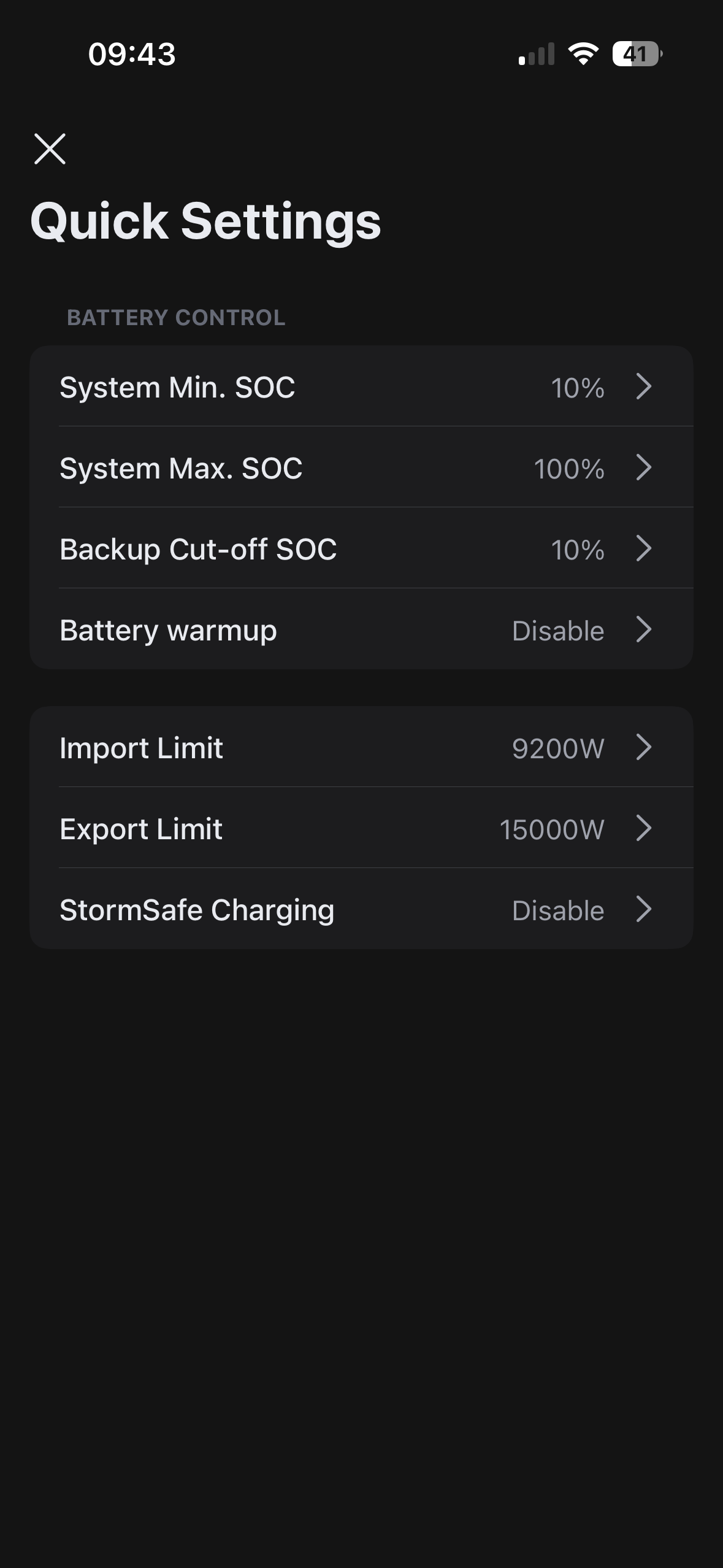

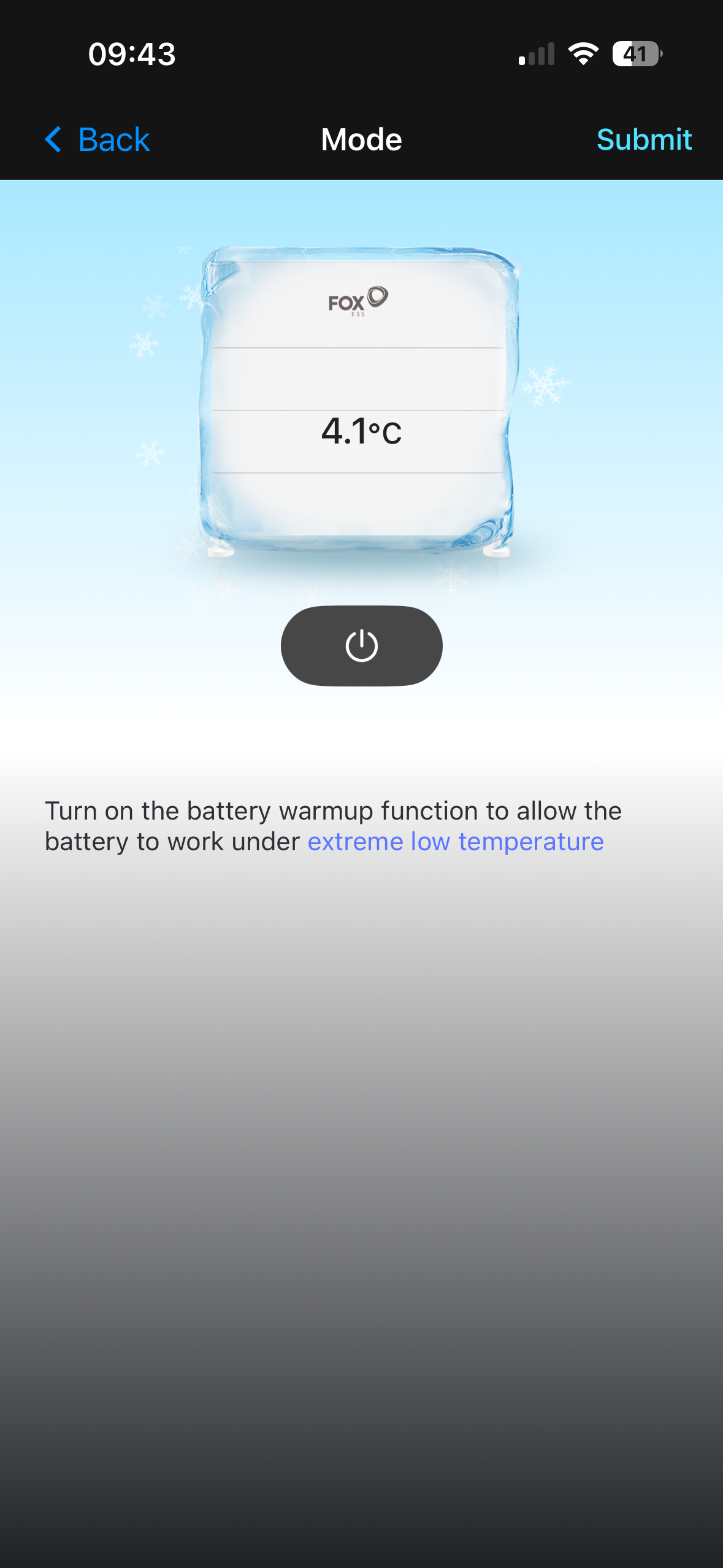

It was very cold last night and I noticed that my forced charge at off peak didn’t charge a lot (battery was only a couple of degrees). So this morning at about 8am I thought I would warm the battery a bit and put a bit more charge on the system. Now it’s sunny and the battery has climbed a bit in temperature I now no longer want to be drawing from the grid, but I can’t seem to stop it. I’ve turned the battery warmer off in the app and there is no force charge running. But it’s still drawing current. I can’t work out why as there is no setting on the app telling it to draw from the grid. The only thing I can think of is the originally I had set the warm up to finish at 10am, and it’s not that yet. But I’ve since gone in and cleared the settings?!

If you can look here, and follow the link in this thread, your start temperature is too low. It might still be charging from grid to protect the battery, as the BMS is in ultimate control and overriding your settings for now.
A link to Dave's post here about the BMS controlling the situation: viewtopic.php?p=13131#p13131
