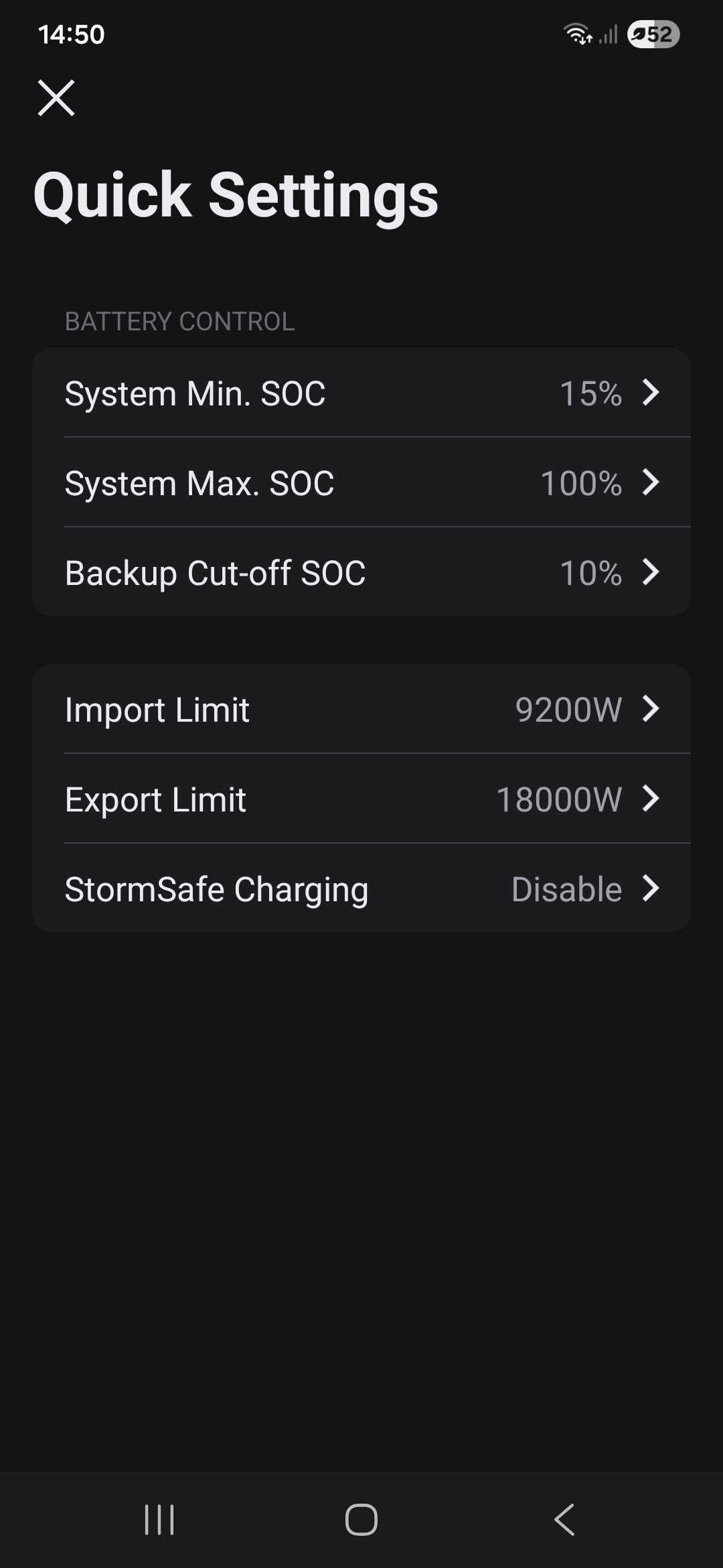

In the Quick Settings of the Fox App 2.2.0 there are import/ export settings, see screenshot.
How do I know if these figures are correct?

For Export Limit, what inverter size do you have ?, the default is to set it to 60,000 which simply means output as much as the inverter can.
For Import Limit, this is a bit more complicated as it depends if the inverter can see all of your load or whether you have EV chargers, heat pumps that are wired in front of it or can be seen by the inverter. As a rule it should not be set any higher than your main house fuse (multiply * 230V to get the power). 9200 watts seems ok if not a bit low, if it is too low you will see your battery charge fall when you have other larger appliances on.

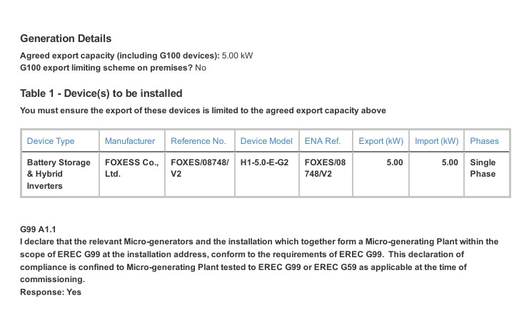

You need to check your handover pack from your installer for your correct Import/Export limits.
Here is a G99 for my installation, and comes from network suppliers, for example National Grid.
So you may have to check your documents for the correct values (certainly for export!)

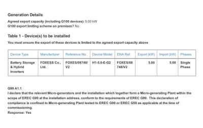

In the hand over pack there is this from UK Power Networks. Is this the information I need?
For compliance, yes you should set your export to 5kW (5000W in your App settings)
Given you have 12 panels of 445W, you will barely breach the 5kW limit (happens fairly rarely in Summer due to heat) so you are fairly ok.
Import has no limit from what I see for you, apart from the main supply fuse, so either 100A x 230V = 23000W, or 63A x 230V = 14490W
Thank you. So from what Dave Foster said earlier, I should increase the import setting. Does it matter which of the two ratings I should use, the 100A or 63A local fuse?

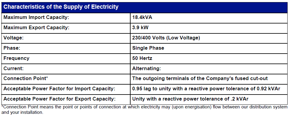

I have 80Amp supply fuse, with EV charger that is wired up.Northspoon wrote: ↑Tue Feb 10, 2026 4:16 pm Thank you. So from what Dave Foster said earlier, I should increase the import setting. Does it matter which of the two ratings I should use, the 100A or 63A local fuse?
I set my import limit to the full 80A x 230V for 18,400 Watts, and my own export limit as 3900 Watts.
And of course set your export limit as 5000 Watts to be compliant.
The CT clamp is placed on the icoming power after the meter, so for you it really should be import limit 23,000 Watts.

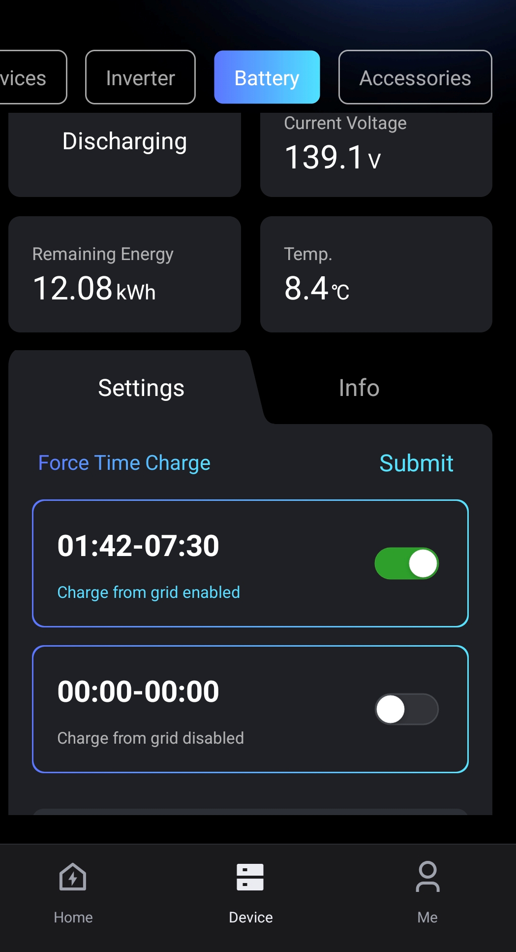

I had manually set the times to take advantage of the off peak hours, but really wanted the batteries to be 100% charged by the time the peak rate starts at 0730. Looking at the graphs, the batteries are fully charged by about 4am.
So if I set the starting time to charge the batteries to be, say 0300, then the battery should get down to more like 10% capacity. But only to do this once a month, not every night?
I am just an end user like yourself, Dave/Will would be more expert than me. I just like to read/learn/reply here to help with things. It seems the consensus is year 1 the SoH drops on average it seems 4-5% then steadies down to 1-2% for each year thereafter. This is what I have learned from forum, so maybe as I say, Dave/Will might reply and confirm that this is roughly on par.Northspoon wrote: ↑Tue Feb 10, 2026 5:50 pm That makes sense. I was a little concerned when you said your battery SOH was 100% and mine was 94%. So nothing to be too worried about then?
This make sense to me to shift the starting point to whatever you think works (say 03:00 as you think) then just check graphs the morning after to check if you dropped to 10% before and made it to 100%. As for how often, I suspect keeping to once per month for the 10-100% cycle will be good. It won't hurt too much if it was nightly (in my eyes) but like you mine is often left with 20-50% before a charging period.Northspoon wrote: ↑Tue Feb 10, 2026 5:50 pm I had manually set the times to take advantage of the off peak hours, but really wanted the batteries to be 100% charged by the time the peak rate starts at 0730. Looking at the graphs, the batteries are fully charged by about 4am.
