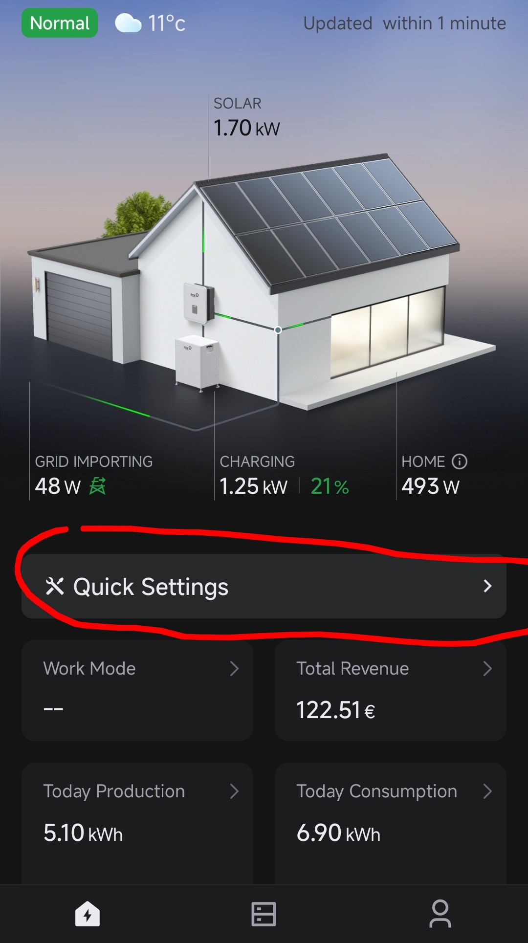

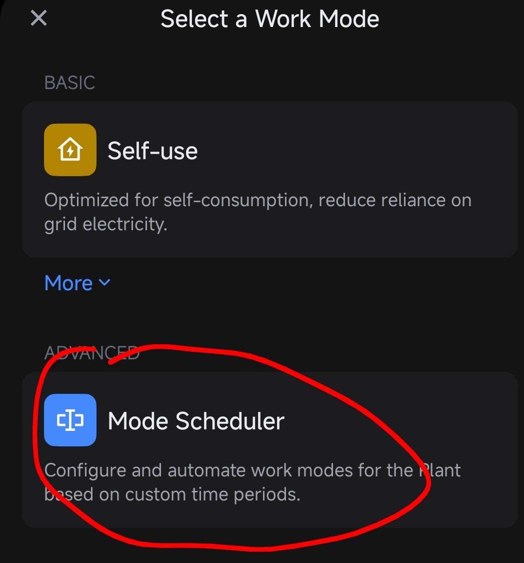

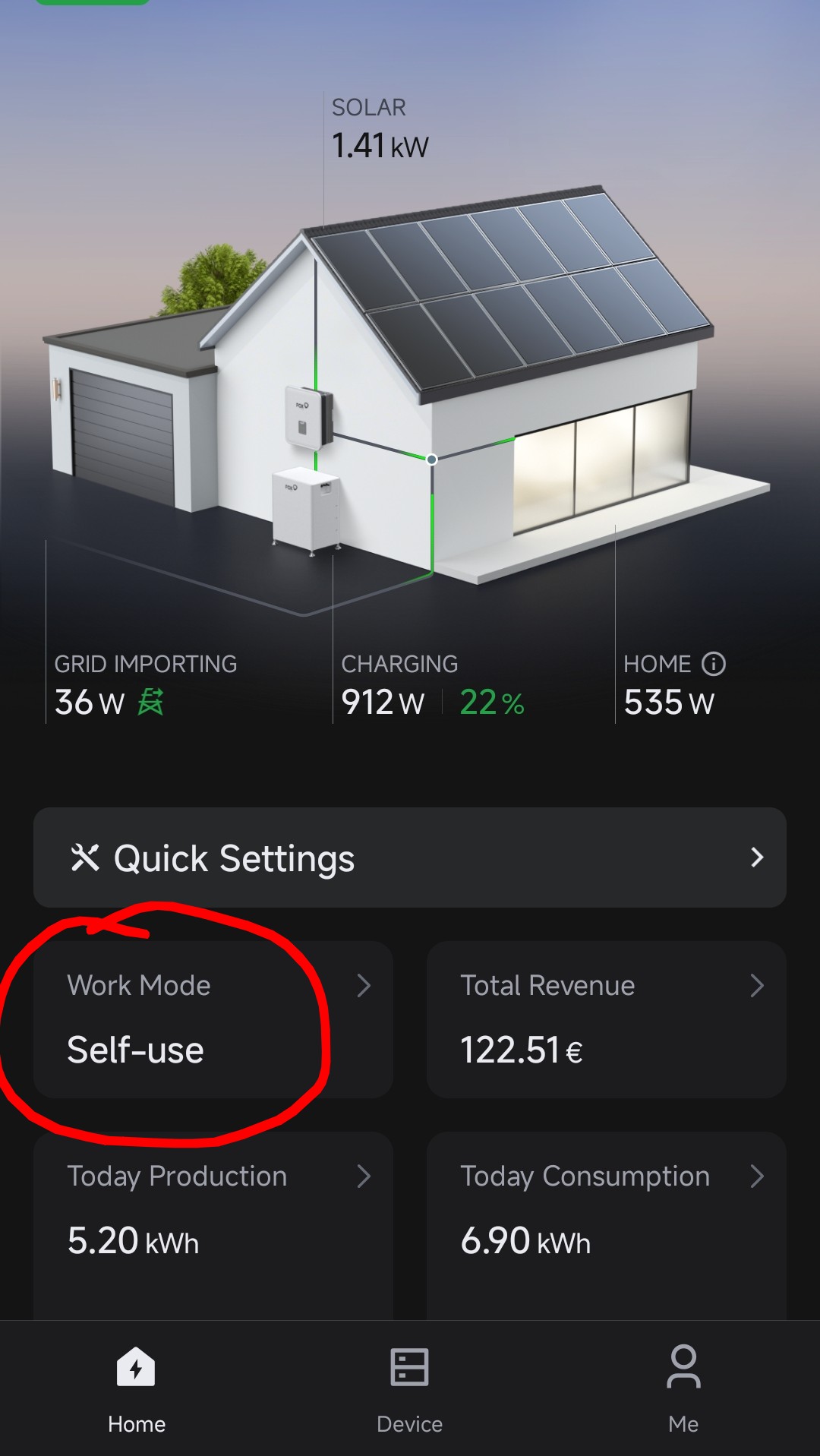

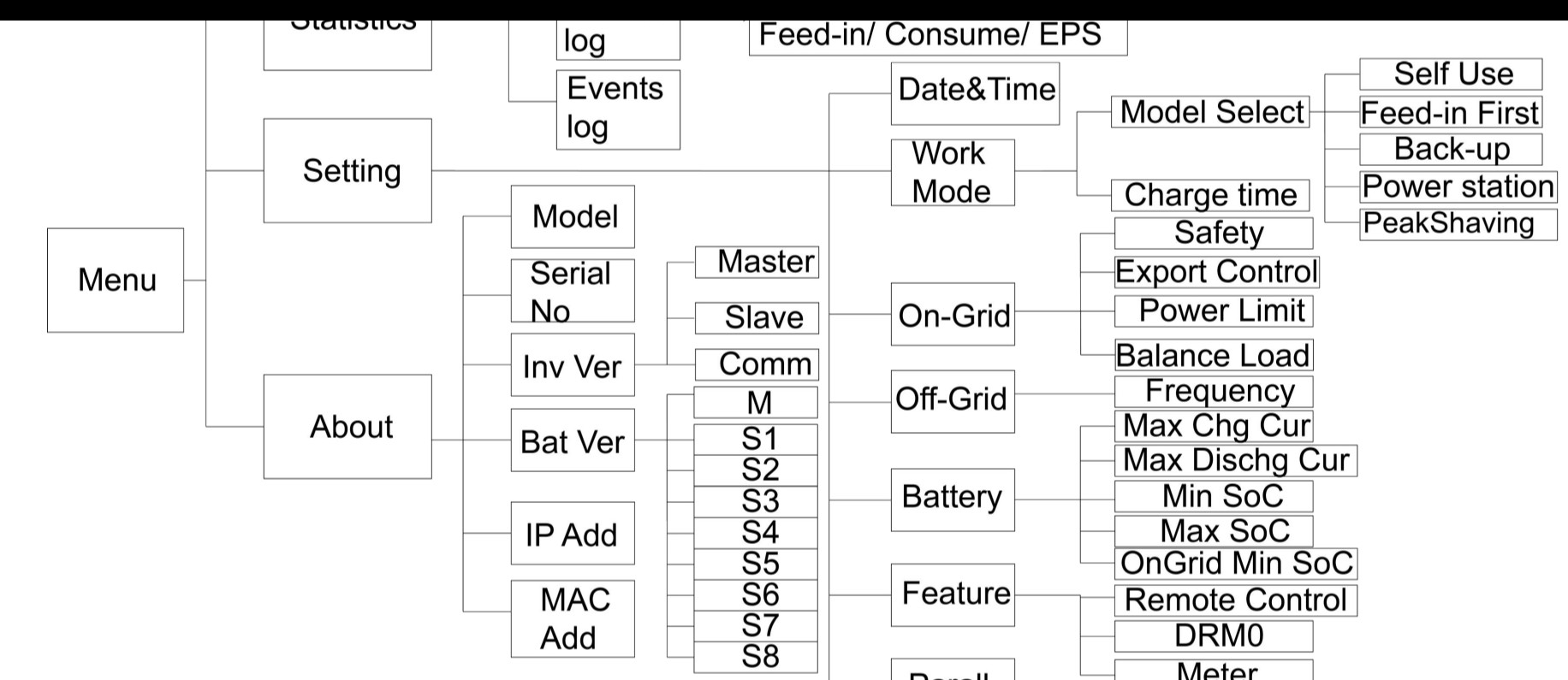

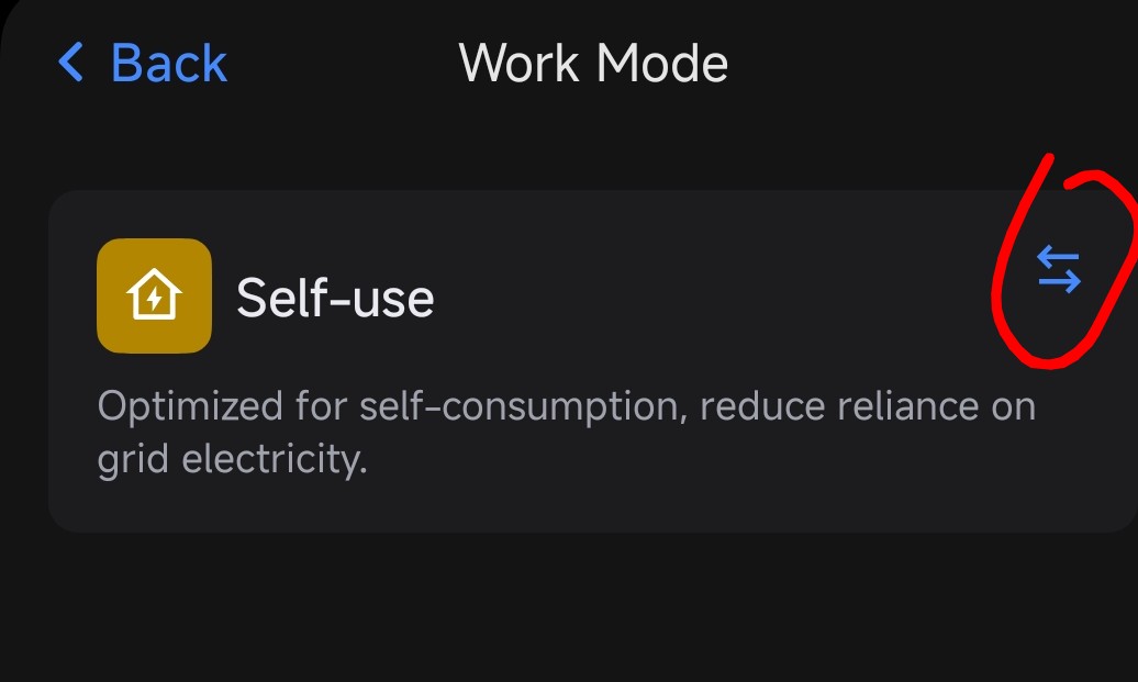

You have two options

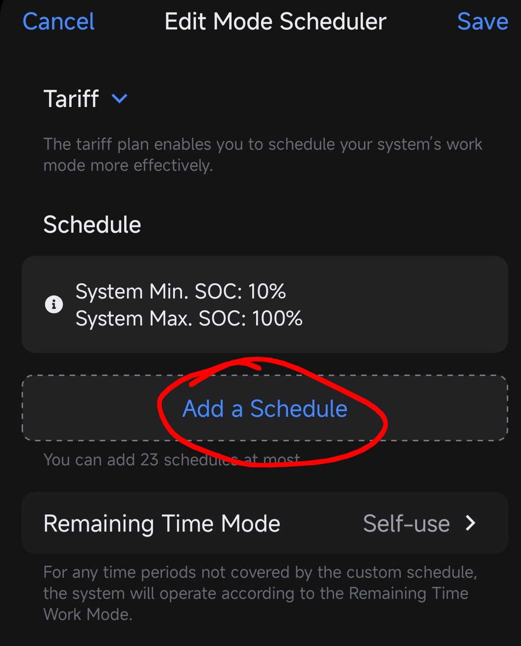

@fumbo Thanks for the quick reply but it's not clear from those screenshots how they relate to each scheduled work mode.
I have 2 scheduled work modes with different SOC settings which I set using the previous app.

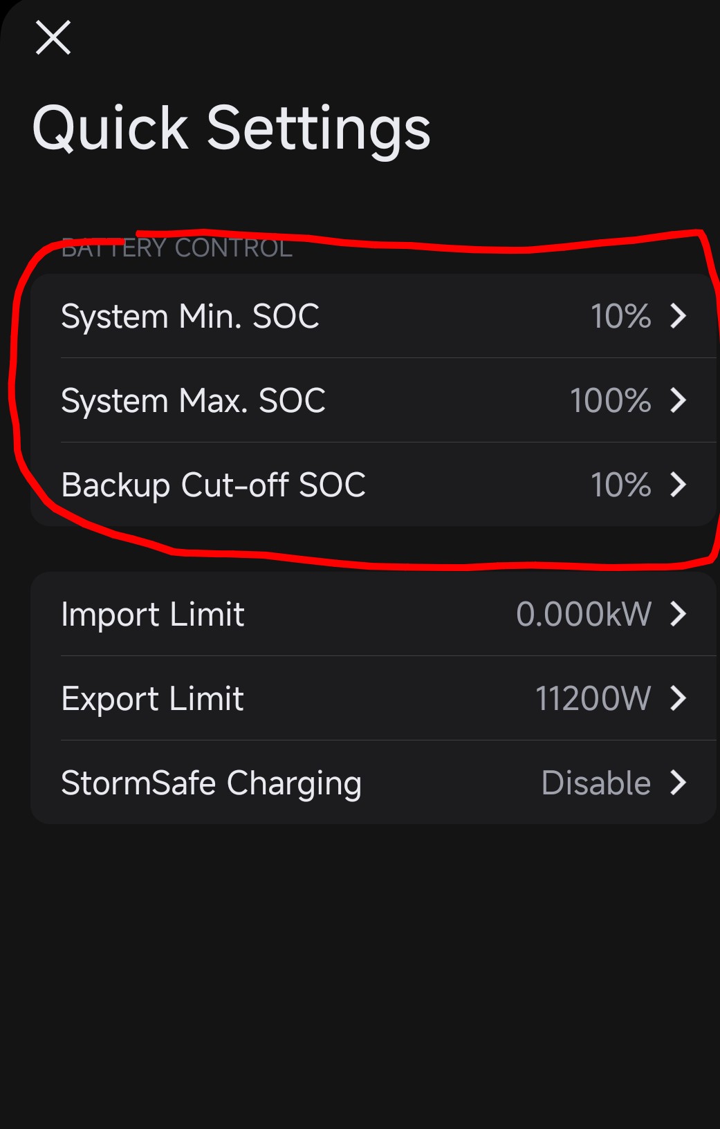

I imagine the battery control settings immediately under Quick Settings relate to the current running work mode?
How would I edit these settings for a different scheduled work mode?
Perhaps the whole scheme has changed and now we can no longer have per schedule SOC settings?
Hope that was clear,
Thanks.

Mykey wrote: Mon Feb 09, 2026 11:11 am
Yes you are correct, the scheduler no longer allows per schedule soc settings - you can have the system defaults, and Force Charge/Discharge have their own cut off soc’s (assuming does ‘Backup’) but Self Use and Feed In First can only use the default settings.

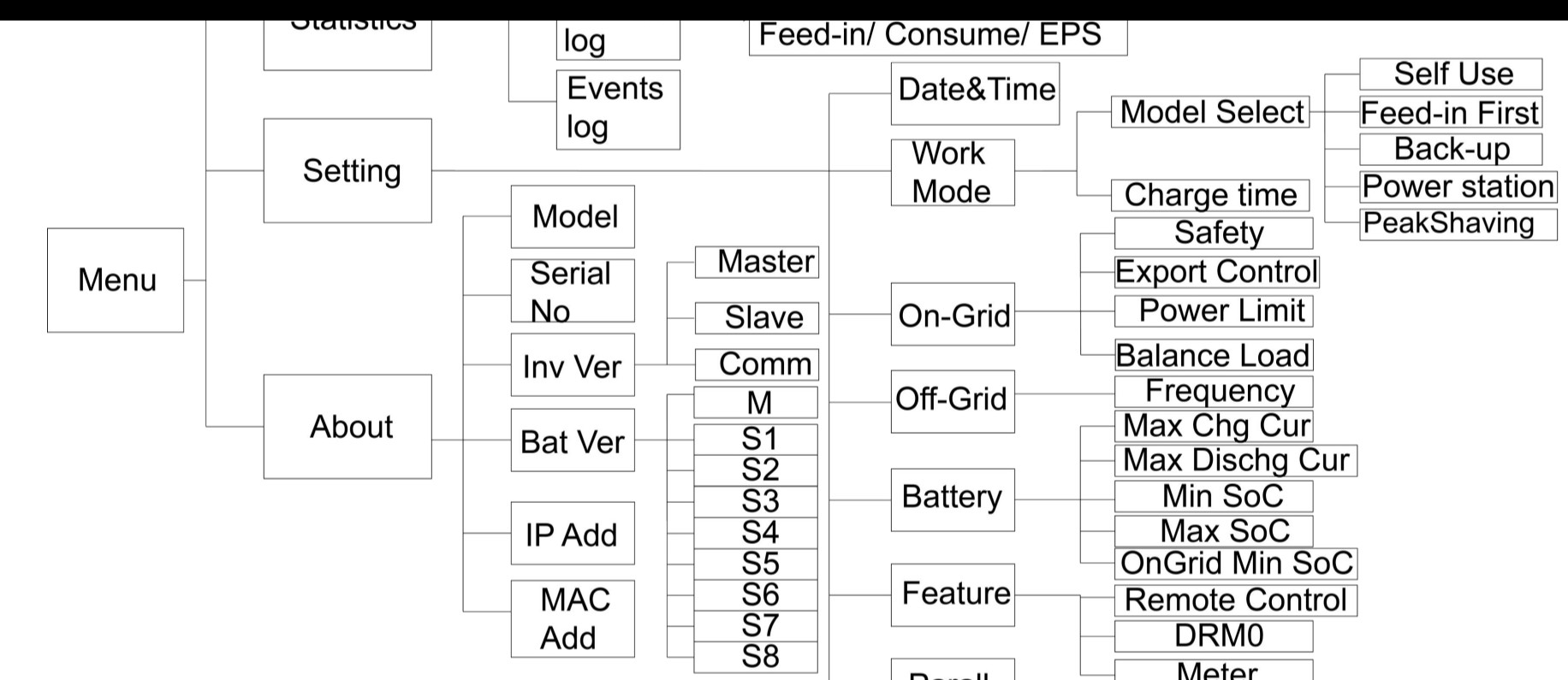

Maybe you can solve your problem directly in the inverter settings.
