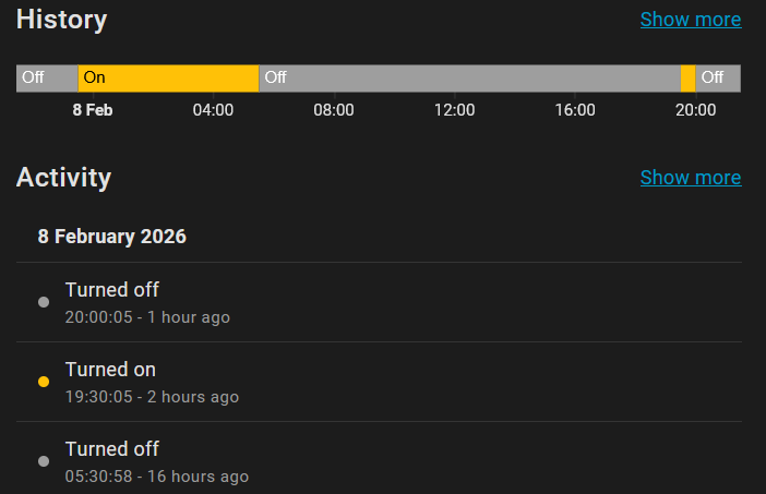

It worked fine for an IOG slot I got earlier.
I just see Dave has posted, I don't have any Fox scheduling turned on.
