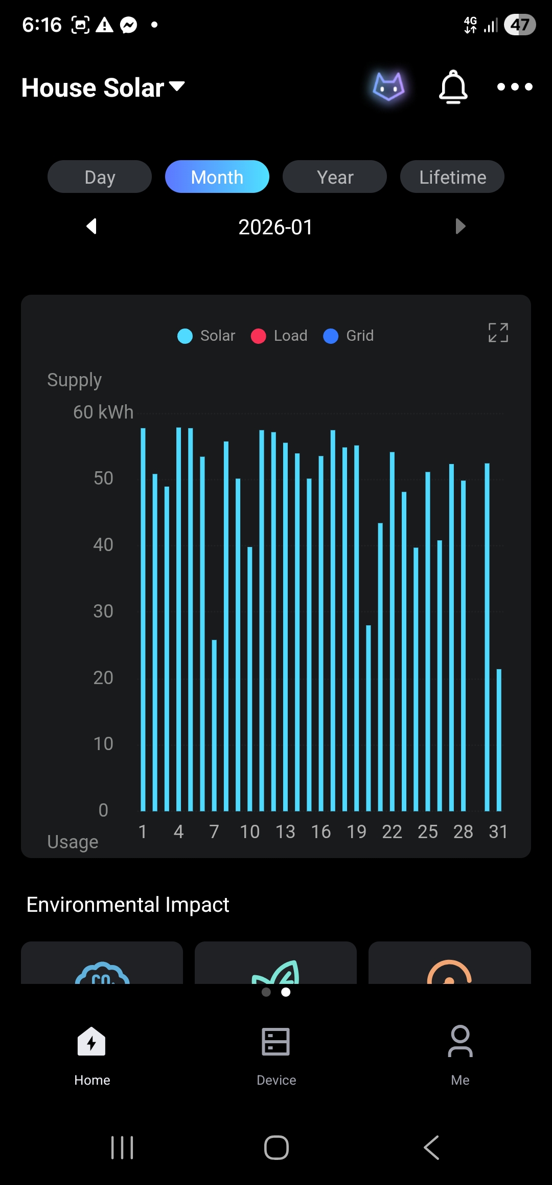

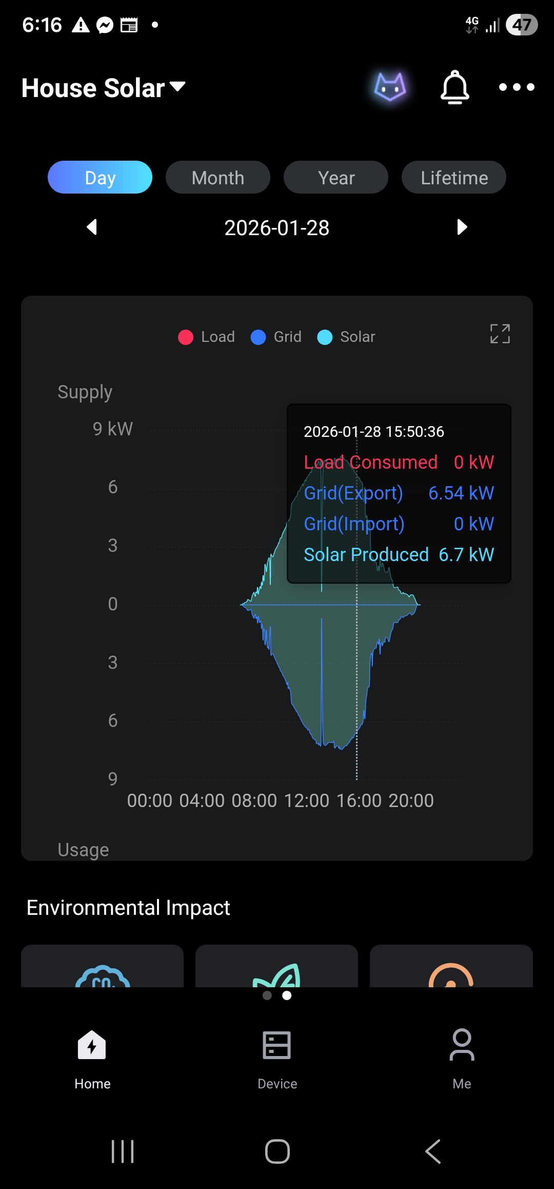

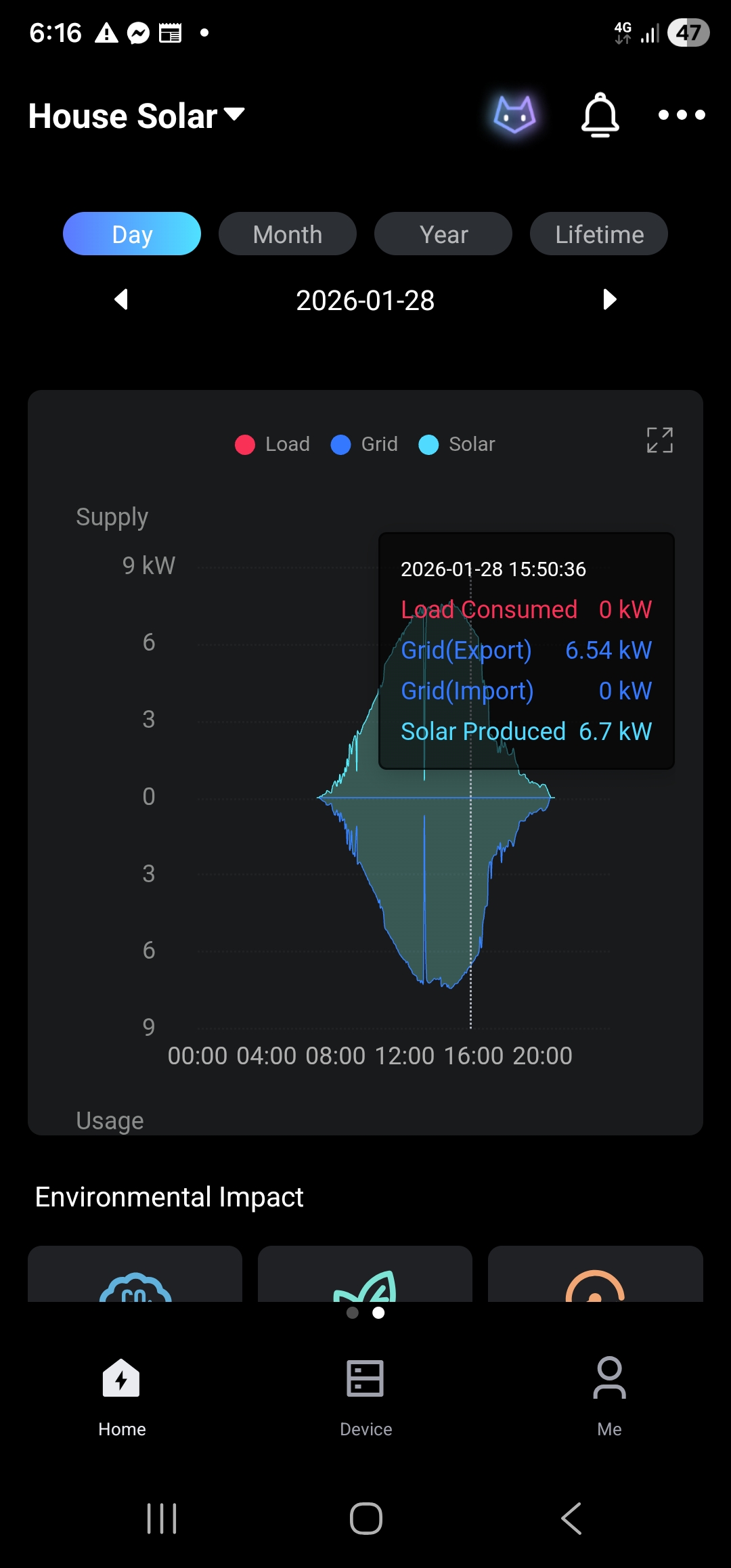

I'm happy to admin my ignorance, but I really don't understand what I am looking at on the app and wondered if anyone was able to give me a rundown on my screenshots?
The takeaway from your screenshots to me, is you are making plenty of solar, but according to graphs, exporting the lot. None of the graphs show any house load at all, so either you use very little, or something is wrong in your system.

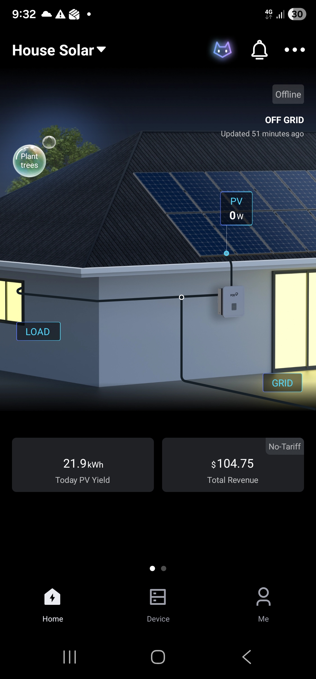

SERIOUSLY?!?! I am so angry right now! I have attached a photo of the home page of my app as I have no idea what the operating system is. I work from home, so the majority of my power is used during the day

When you powered it back on, what does the Inverter screen show, power being generated?
The App won't function well if the WiFi (I assume this is what you are connected by) is weak, hence it could show offline in App, but the screen on the Inverter is showing xxxx Watts being generated by the solar.
Okay, thanks for the info, I will check when the sun comes up tomorrow. There is a wi-fi booster close to the inverter, so the signal should be okay, but I will check that too. Thank you for your time and trouble-shooting suggestions.
