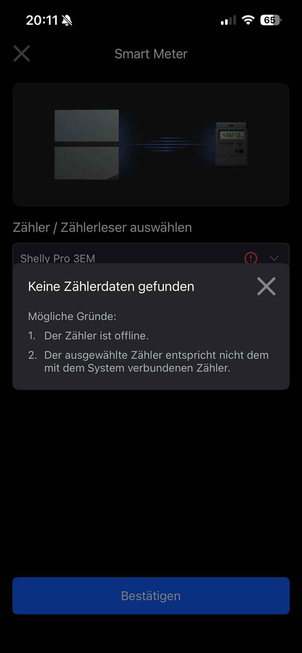

I am trying to integrate a Shelly Pro 3EM as a smart meter into my Avocado 22 Pro system via the FoxCloud 2.0 app. Although the Shelly Pro 3EM can be selected in the app, I get an error message when I try to save the configuration (see screenshot).

Image[/img][/img][/img]
