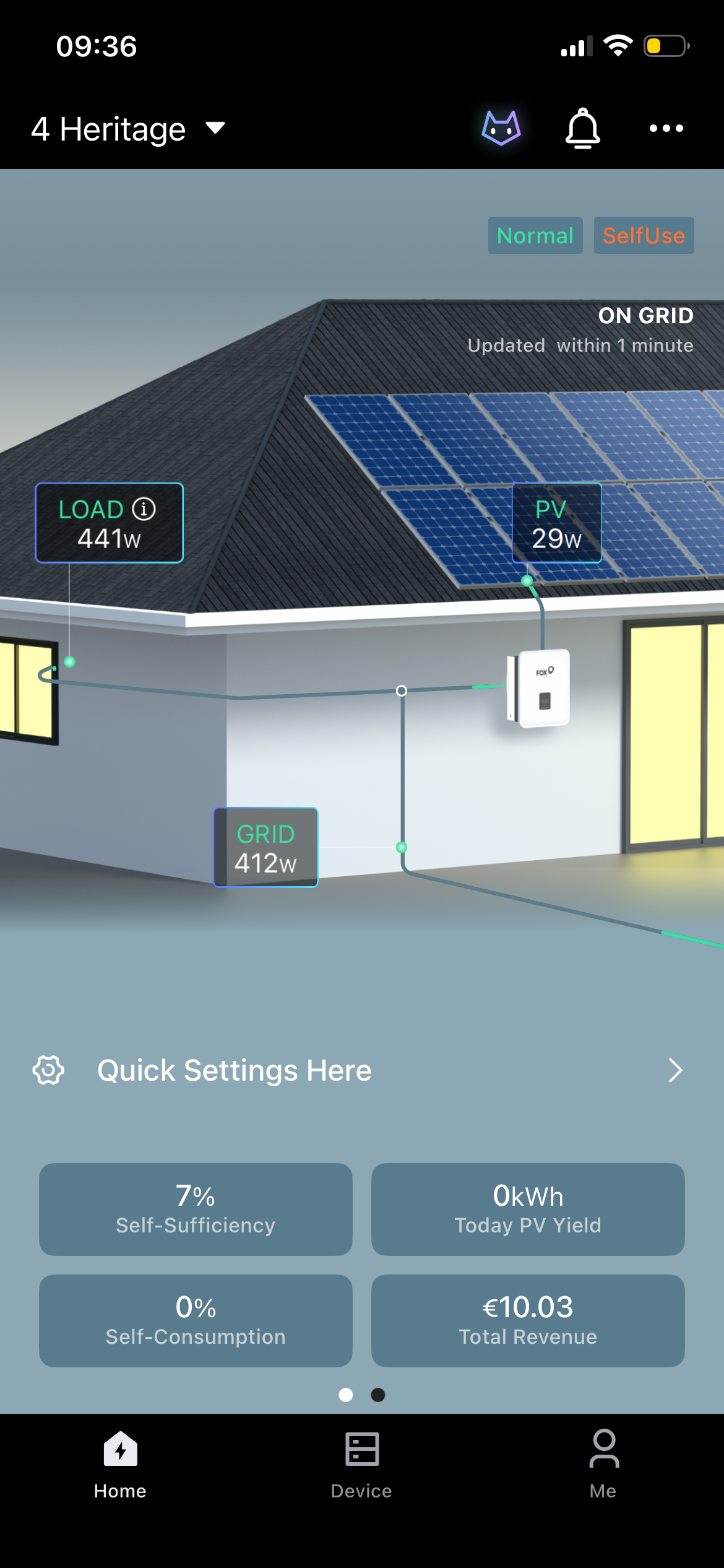

Hi Will, this page?
So do you mean by that, the negative value could be the cost of just running the inverter on days when there is no sun?

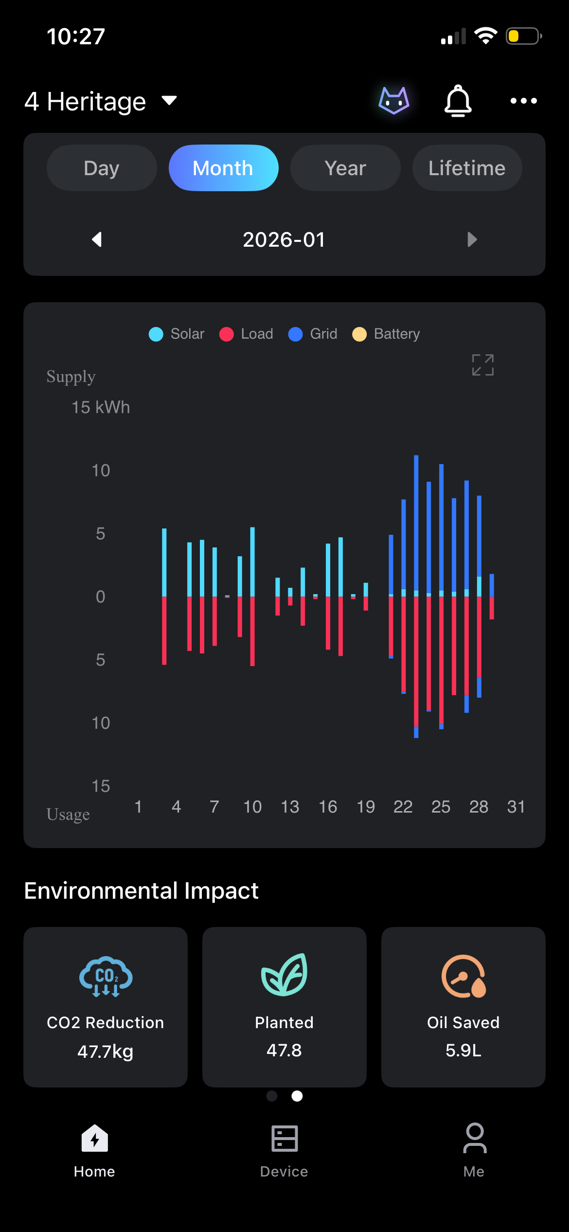

Not that page, that is your "home" screen.
Swipe right to left, then scroll to bottom to see the energy graph.

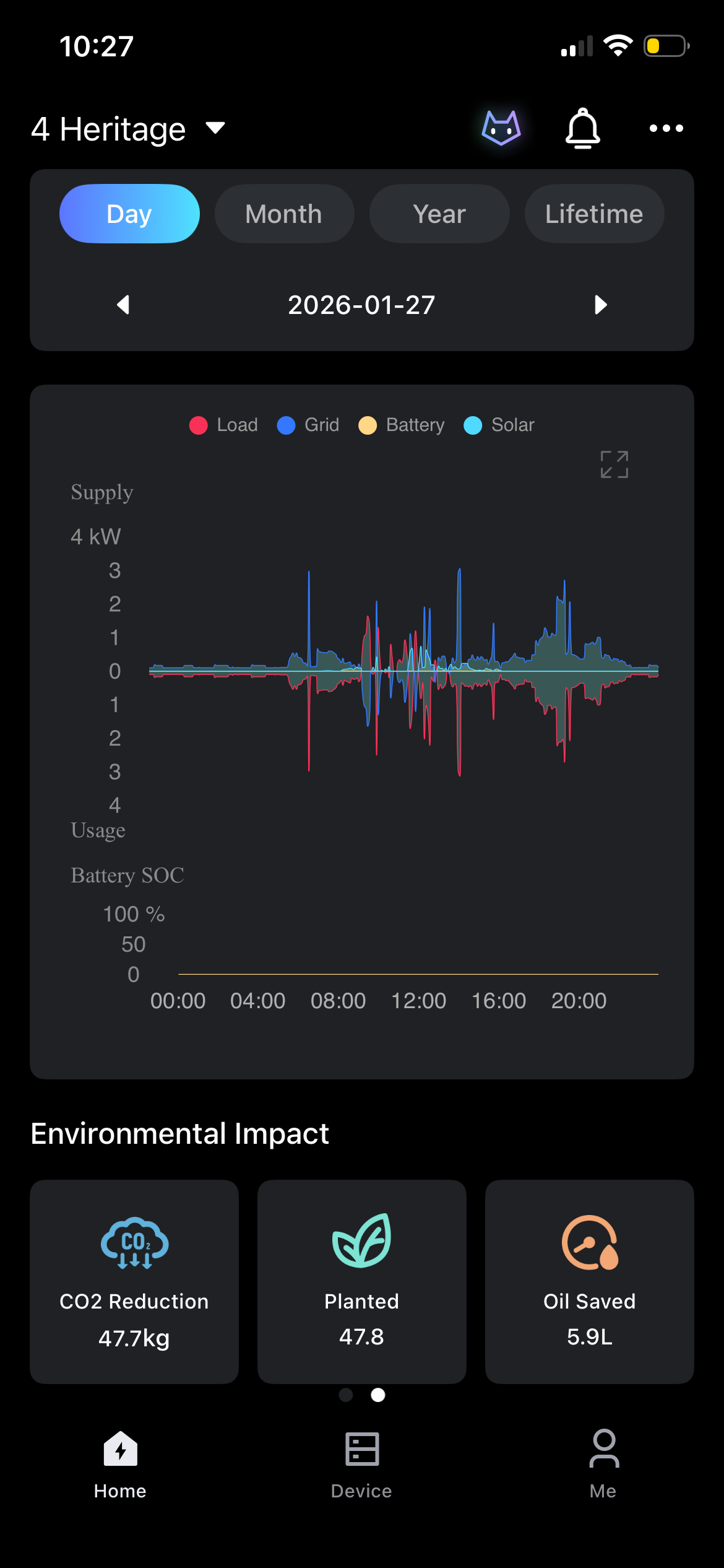

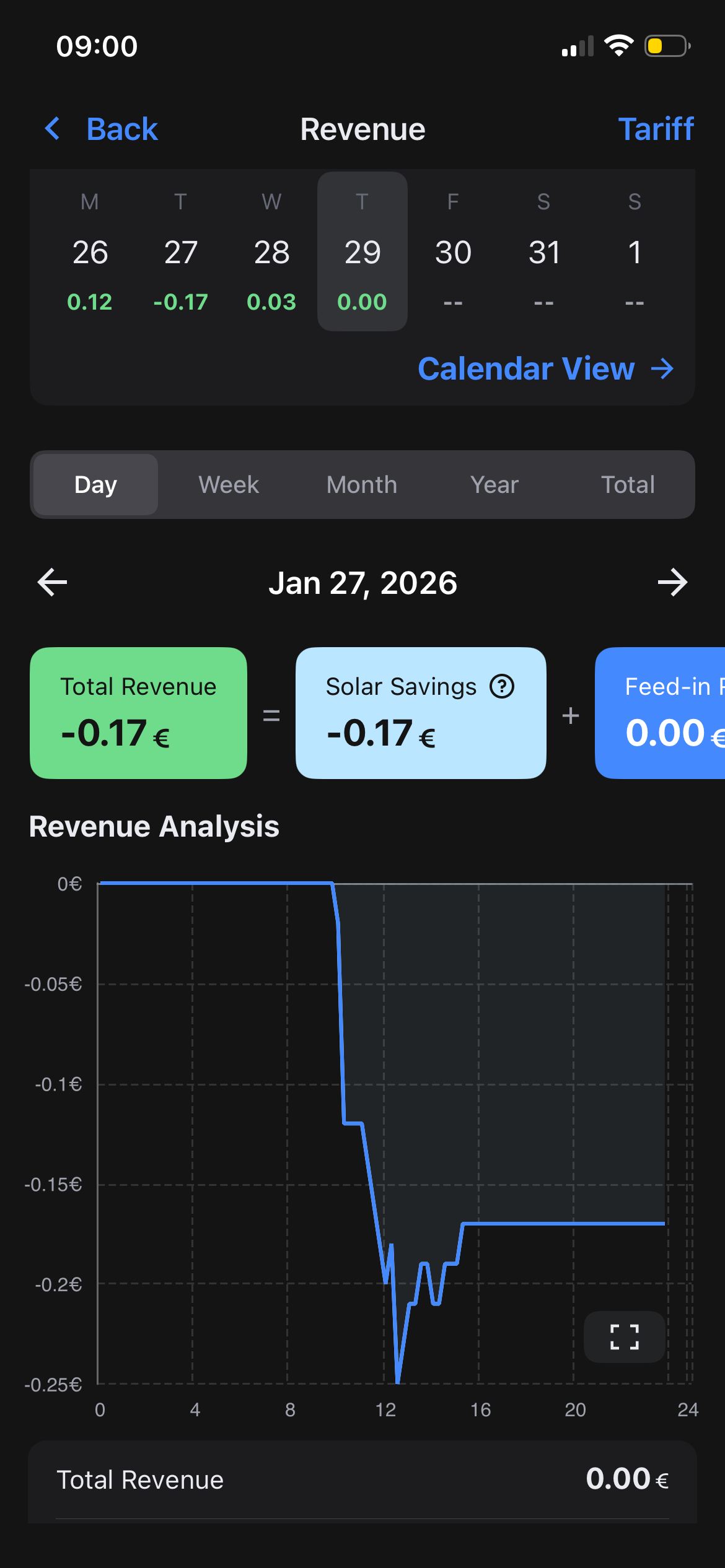

Thanks, here is a screenshot of the month, and of the 27th day which had a negative revenue of 17pence.

Re: Negative Revenue
Jimmyrn85 wrote: ↑Thu Jan 29, 2026 9:38 am So do you mean by that, the negative value could be the cost of just running the inverter on days when there is no sun?
My system has a parasitic loss of about 100W 24/7, so 2.4kWh in a day. That's a KH7 with 15kWh of usable battery in an EC4300 stack. Each system will have a different parasitic loss, based on the number of computers in it, the firmware versions, etc.

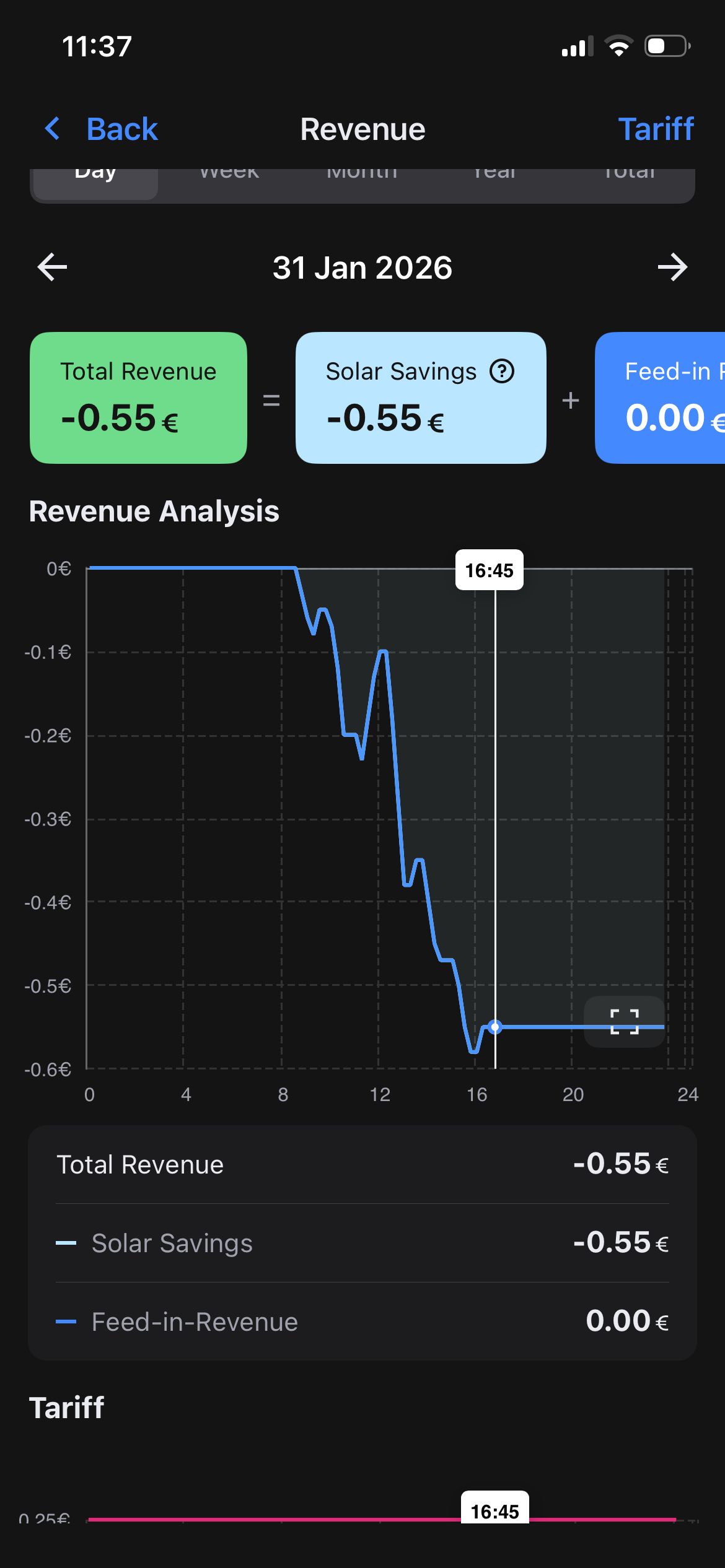

Hi all, yesterday we had a decent day of sunshine down in Devon and generated a chunk of lecci.
It's given me negative 55pence in the app revenue. How does that work and what does that mean?
Is there some confusion with the rent-a-roof system going on?
I see PV production for the Fox system as 5.10kWh
To Grid 7.40 kWh
Load Consumption 7.40kWh
From Grid 9.70kWh
I think the language they use around this part of the system is a bit weird.
"Revenue" as far as Fox is concerned is basically:
The "would-be" cost of any energy you generated on-site and used (they call this "Solar Savings")
plus The profit from any feed-in
minus The cost of any energy used to charge the battery from the grid.
The last two items combined are called "Feed-in Revenue" by Fox.

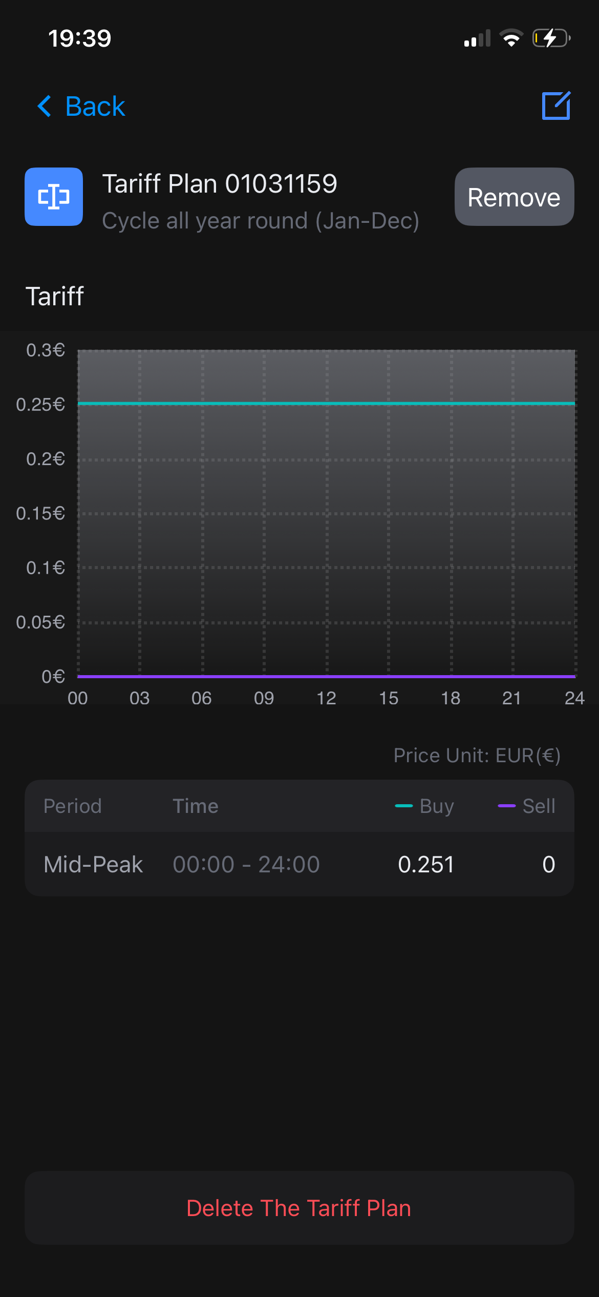

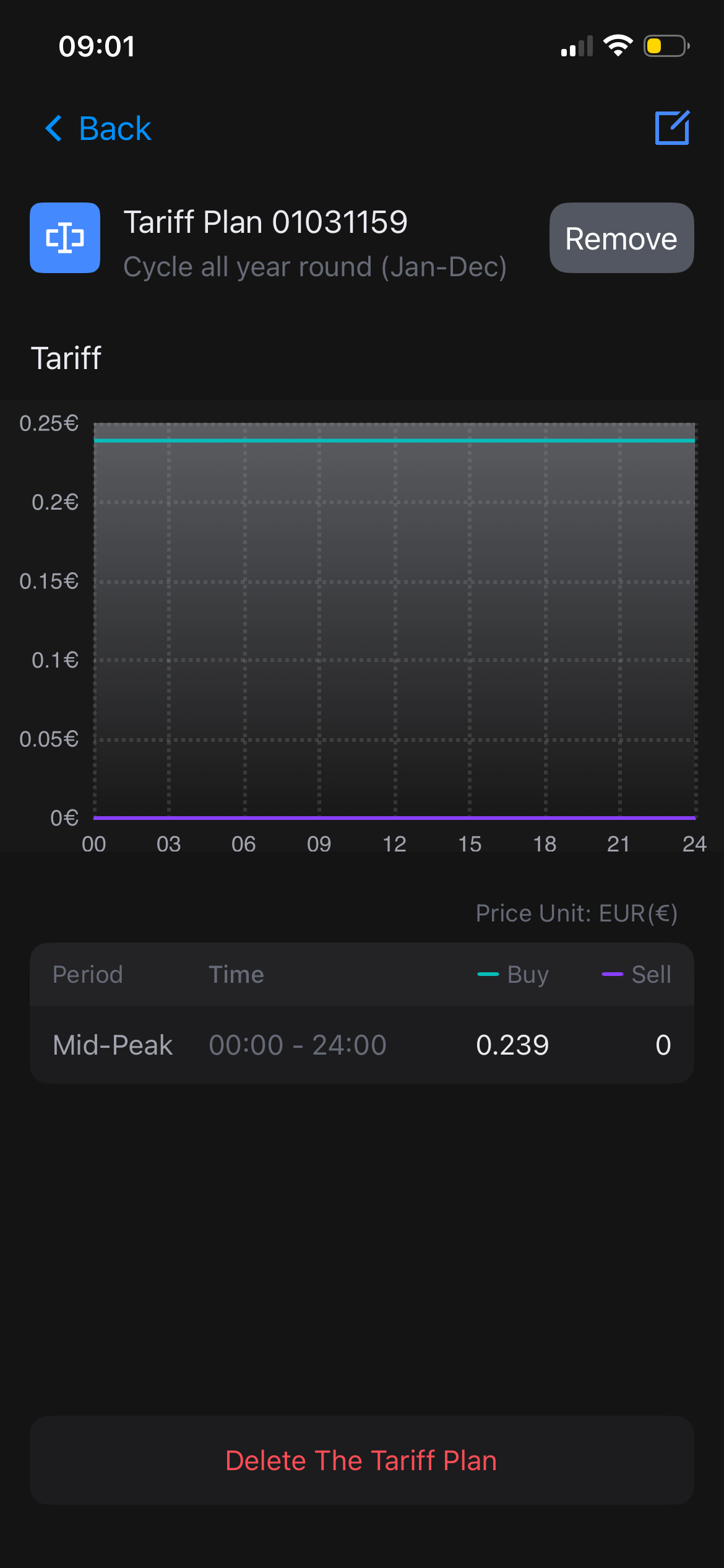

Here, your "Solar Savings" are showing as negative, which is a bit weird... The only way I can think of that happening is if the tariffs are configured strangely (negative buying price for a period for example)... Maybe post a screenshot of the Tariff page (from the App home screen, tap Total Revenue, then tap Tariff top right, then tap on the tariff plan you have set up there, and screenshot the chart shown?)

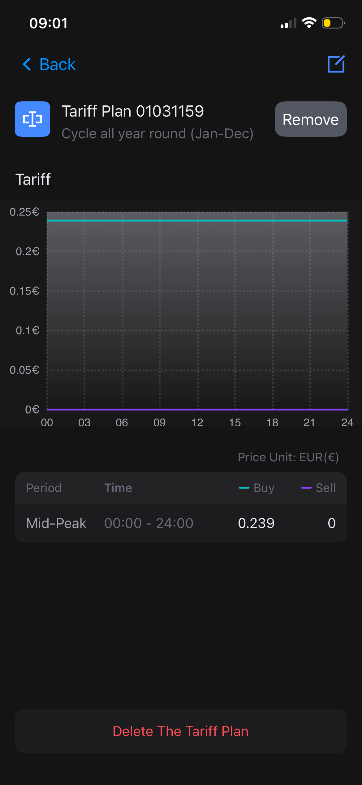

Thanks, appreciate any help or insight you can give me because I'm finding it odd too!!
I updated the tariff page, it was set at 0.239pence per kWh a couple days ago but actually we purchase lecci at 0.251pence so I've now updated that see my attached screenshot.
Since this small system has been installed in early Jan, the PV production has been 55.40kWh.
So I would expect it to say £13.90 (55.40x0.251) worth of lecci has been generated since installation - appreciate we won't use every last ounce of it sometimes but it would give a bit of indication anyway

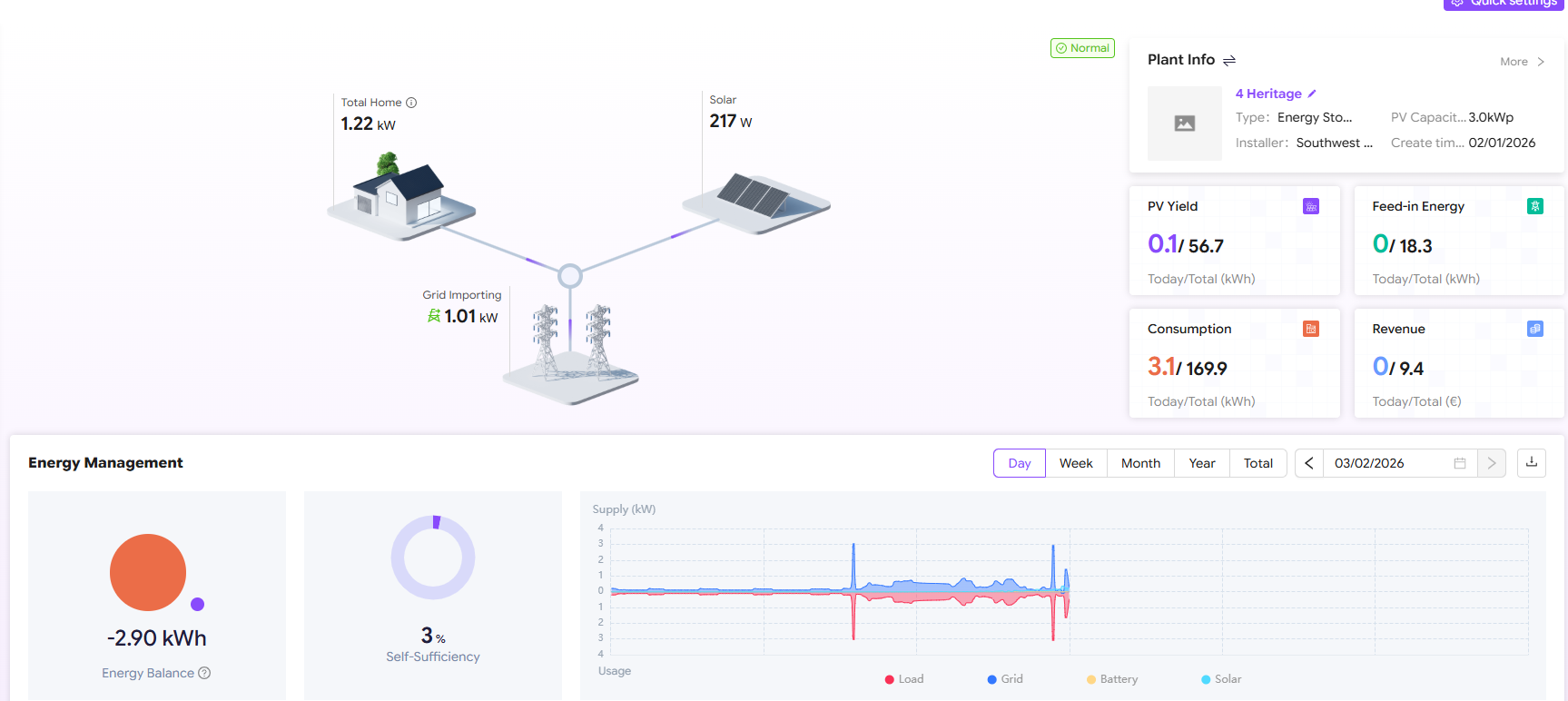

Yeah that looks perfectly normal... very weird.
If you log in to the Fox ESS Cloud stuff (https://www.foxesscloud.com/v2/) is that any more sensible?
To be honest, when I first got our system online, the Revenue thing was all out of whack for a few weeks too. Kept displaying £0.00, then changed to something unbelievable, now it's fairly sensible, but I do constantly doubt it...

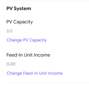

Seems normal however I have just noticed something, in "about plant" there is a Feed-In Unit Income. This was set as 0.251pence. We don't get paid for any feed in (that all goes to the rent-a-roof people on a deemed export).
Let's see if that makes any difference!
But at the moment, the total revenue displayed is slowly going down! lol

Switch your tariff, over. The buy sell is from the energy providers point of view, not yours.
I switched it and it seems to be right now.
tom210 wrote: ↑Wed Apr 29, 2026 2:50 pm Switch your tariff, over. The buy sell is from the energy providers point of view, not yours.
Thanks Tom, that does seem to have worked. However, I’ve lost ‘solar savings’ now, it’s always zero? Before I would get some value of solar savings, then the negative value of feed in revenue.
