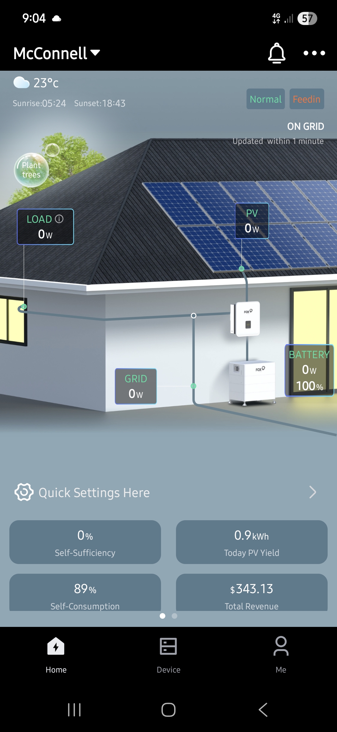

My system frequently shows via the APP, no consumption, no PV and Battery at 100%, despite what I have scheduled, a minor voltage shows coming from the grid.
Howvever i know the consumption should be much higher, as appliances are running.
If a faulty CT Clamp is fitted, would this affect the system settings, or does the CT Clamp only display grid incoming g consumption, and does NOT affect other factors within the system?

I was looking at the settings of the Inverter earlier, but can't remember what the CT Meter setting was.
I will check to see in the morning if it is enabled, and advise.
Sometimes I see load and pv production in the APP. Other times I get zero or 1-4W's for each component.
I need to reboot system so battery kicks in to force discharge , else it seems to drop off.
Also, today, when I rebooted system, I was using minimal load with no AC units etc running, yet load was >6kW which seemed high.
Then battery drained from load over the next 4-5hrs.
It is as the false load showing beinf consumed sends excess to the grid until battery hits the Min sOC.
