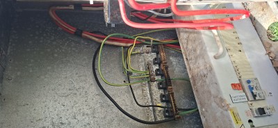

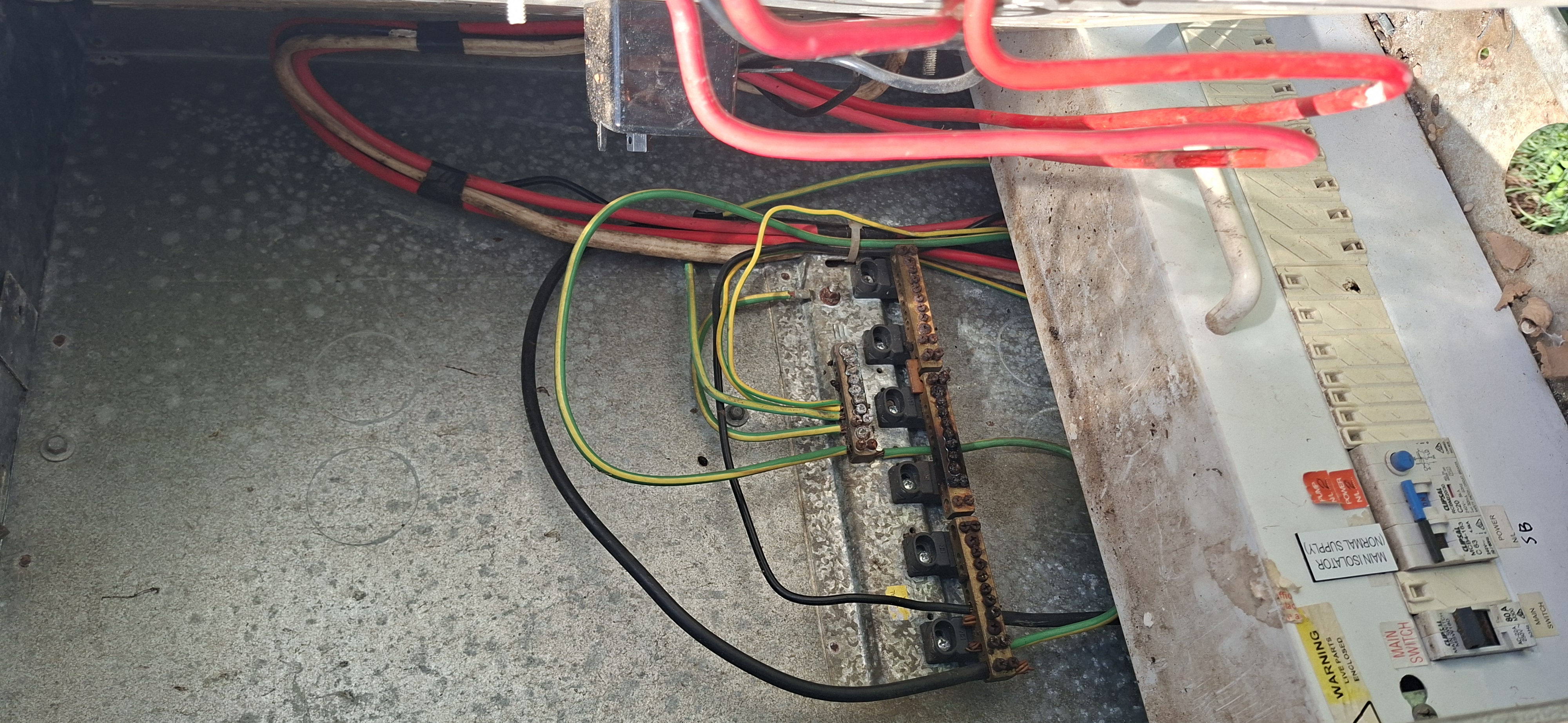

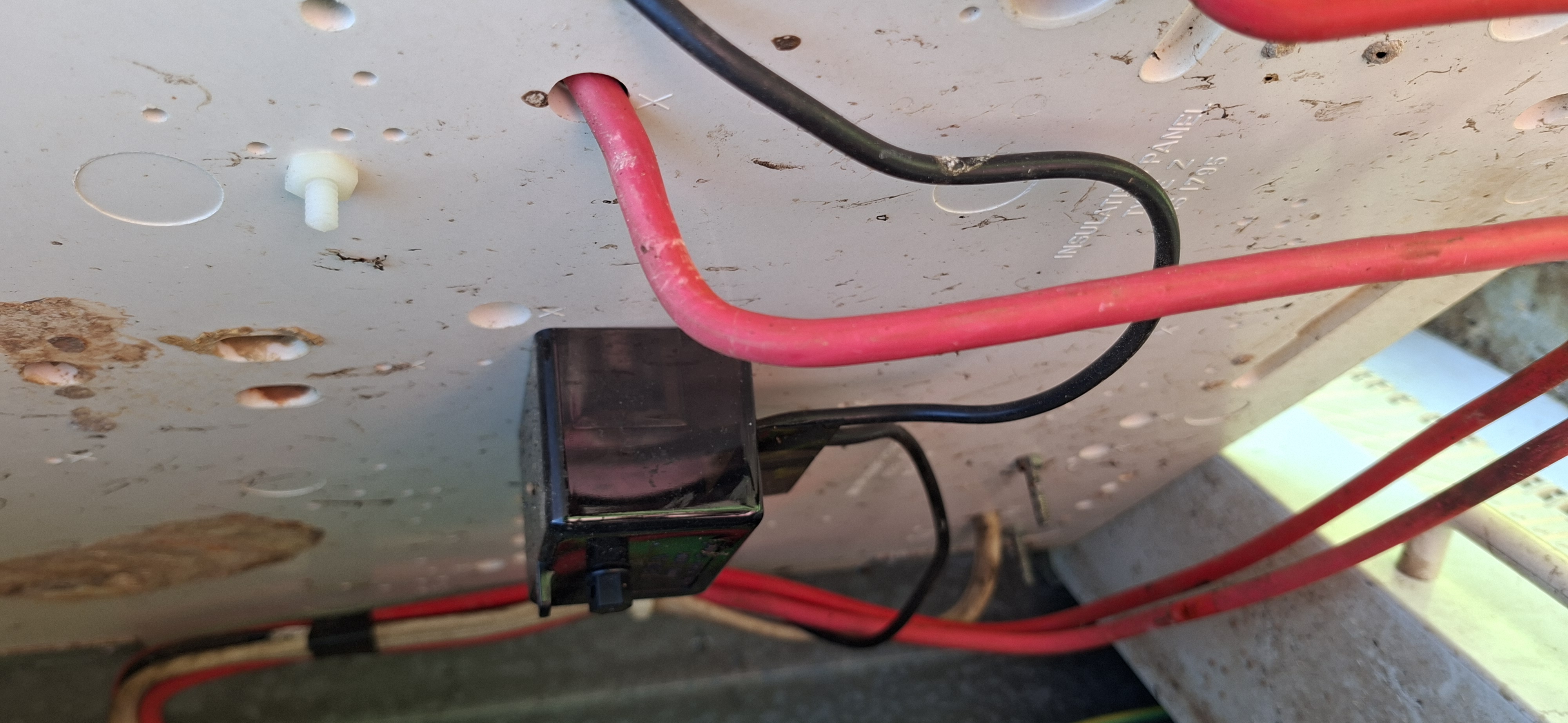

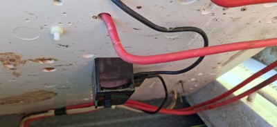

Couldn't see any CT clamp anywhere.
Unless this mounted black thing in the 2nd photo is it?
