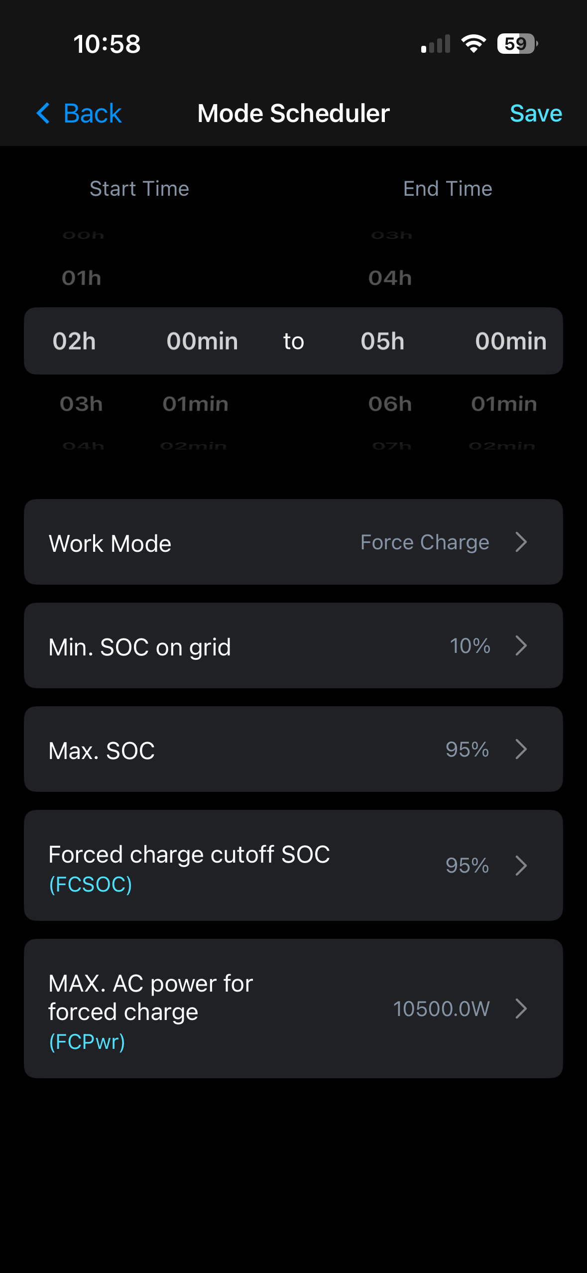

I’ve had my system about a week and really struggling to get consistency with the overnight charging and the scheduler. Sometimes it works fine, others it doesn’t seem to work and tonight is one example. I currently don’t have the ability to export while I wait for certain approvals so I am just charging at my super off peak rate and using that for the day. Although tonight it hasn’t worked. It did the night before. I did read though somewhere that if your battery reaches a “protection” mode then it disables charging. I did notice that my battery was at 9% when I checked just now and I presume it must have discharged to this level before the 2am window, putting it in protection mode and this could be why? Although why would it have gone this low? I fiddled just now and it started charging. It has now stopped at the 10% and is just running off the grid. I’m currently losing my off peak charging window and it’s all feeing really unhelpful and complicated when it seems to work some nights and not others. Any advice would be really appreciated

I’ve since instigated a forced charge which looks to have started but I have little confidence in the app or system. My app only seems to refresh in 5 minute intervals too which isn’t the most helpful when trying to check and resolve stuff. Is this normal? So it wasn’t until the app refreshed that I saw it was charging. It all feels very manual at the moment and I don’t particularly fancy having to wake up at 2am every day to check the system!
Dropping to 9% isn’t a problem the battery manager works off internal cell voltages and it will cut power once the minimum cell voltage is reached - that usually co-incides with 10% but it can be a few % out, particularly when new and un-balanced.
Your schedule looks ok, do you have any other large loads taking power at the time you were force charging, an EV, water heater, heat pump etc..

In your first post, you have FDSoC cut off set at 20%.
So it would charge from grid to 20% and wait for solar to reach the Max 95% for the rest of your energy.

So should my minSOC on Grid be set to 95% as well? From your explanation that makes sense.

MinSoc could stay at 10% if you want, and best in any "experiment" to only change one variable at a time, this way you know which is the magic setting.MartyH47 wrote: ↑Sun Jan 25, 2026 10:48 am Thank you.
FCSoC does need increasing to stop it cutting off too early, or not even starting a charge.
Thank you. I have removed and replaced my scheduler with the new one screenshot. I think it was the FCSoC max being at 10% which was catching me out. With this now at the same as max SoC it should charge.

You can test this now, if you set it to run for about 10mins. Best not to run for longer at peak prices, but you can at least see it will work for next main charge.

Just running a test now and it looks like it’s working. Thank you all again for your advice and patience.
