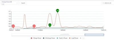

Unfortunately, my system is still unresponsive despite the lack of "forced charge" settings for 24hours. I think it is best illustrated by todays record as copied in below.
During the sunshine in the middle of the day, the battery was charged but the grid was still used to deal with short peak loads of 1.8kW which means the battery reached 100% sooner. Then the excess energy could only go to export to the grid.
Later when the oven was on between 4pm-6pm, all but 0.12kW, came from the grid. The discharge rate remained steady at 0.12kW all through the afternoon (as it had been from midnight until the panels began to generate power).
I have the same data in other forms but I think the image below is explicit. FYI the reported battery temperature is around 13deg C.
What might be wrong ? and can I sort it ?

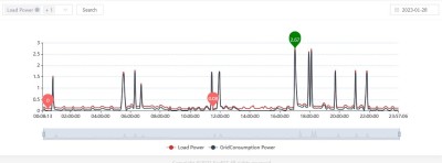

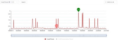

Here is the Load graph for Sat. I have added for comparison that graph along with the Grid Consumption which follows it very closely - the latter is less the 0.12kW of battery supply apart from when the sun is shining. I can confirm these numbers relate well to the figures I see on my smart meter IHD of instant reporting of grid consumption.
FYI I know about the regular demand 1.7kW peaks throughout the day - they come mostly from our instant boiling water unit which heats up for about 30secs approx every 40 mins or so - of course with the strange snapshot reporting of Fox, the chances of it being spotted depends on whether the snapshots are or are not in sync.
Load Graph Load v Grid Consumption graph I'd be delighted to hear your opinion or from anyone else who has worked out how the BMS is supposed to match house demand

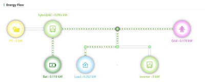

Ok, very strange - can you have a look at your ‘real-time’ power flow, is the direction of power flow what you would expect i.e. towards the house for load, and away from the grid for consumption

Thanks again, Dave - in terms of your first question, yes I believe the flows are all in the correct directions. If I understand correctly, the image you want to check (as just captured) is:
I am encouraged that the system is potentially able to be responsive to demand - any thoughts how to fix this or do I need Fox to attend site ? I had only wondered if low temperatures are causing other current limits to kick in ?
As always, ideas from the community are most welcome - i.e. I wondered if I have a rogue setup.
I have never seen an error in the directions of energy flow in such views, also the currents reported, eg Battery, all line up with direction of charge v discharge etc.I am encouraged that the system is potentially able to be responsive to demand - any thoughts how to fix this or do I need Fox to attend site ? I had only wondered if low temperatures are causing other current limits to kick in ?

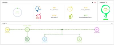

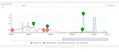

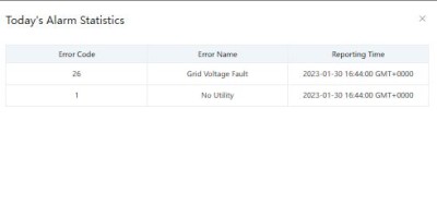

I rebooted the system as suggested at 4:45pm - so far no change in behaviour, and still a steady 120W only feed to the house. see graph below:
Apart from getting FoxESS directly involved, has anyone any other thoughts ?
No errors on reboot except as expected at time of turn off, see below:
Further, I see the behaviour at midday was to keep feeding the battery even when excess was going to the grid rather than meet the house demand. It seems to me the priority is battery before self-use - how can that be ?Apart from getting FoxESS directly involved, has anyone any other thoughts ?
