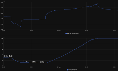

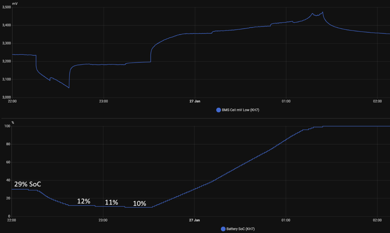

I have made this little graph up from a discharge I did last night, to bottom out the Cells and help the BMS keep the SoC % on track.
It starts at 29% SoC, and I stop the Force Discharge at 12%, it then drops down gently to 10% from a 300W load (TV and base load) until it stopped supplying energy. Soon after it reaches 10%, it then started a charge from my off peak tariff.
What you might see as interesting, is the Cell Voltage droops down low during the discharge, and actually recovers as the SoC changes down from 12% to 10% as I was more gentle with the load.

Hi, what I find interesting is the exponential cell potential droop at max SoC - what causes that?
I think, (I may be wrong in this) that from my own many moons past experience, that the droop in the read cell potential during discharge is due to the battery's internal impedance and the drop across it. The exponential droop is seems more interesting to me.

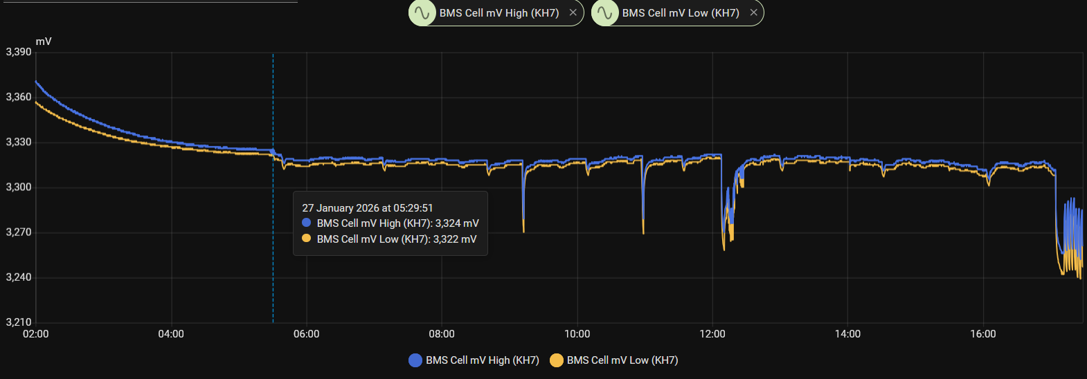

Hi again Derrick, hopefully a final graph for you to peruse.
I have a further image to show a little further on past the other graph, and this time I added Cell Low and High, so that you can see the Cells look nicely calibrated (very small delta between high and low)
You can also see the curve does flatten off nicely towards 05:30, and I then allow the battery to discharge. The first small spikes are caused by kettle going on, saucepan on at dinner time, and the end of the graph ripples are from the oven going on/off as needed.

Thanks again, that's very illustrative of the battery's internal working but the thing I find to be fascinating and a bit enigmatic is that exponential curve on the left hand side - memories from dim and distant courses on electronics remind me of capacitor discharge curves.
