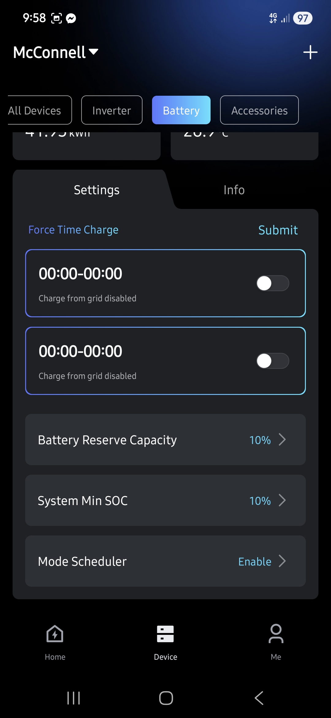

Newly installed 13kw solar + 41kw battery.
Have noticed we never drop battery below 98%, yet we still get Ergon bills ($au50-80 p/month).
I just set up a schedule that previously was disabled.
See pics of app settings.
Am trying to initially force no grid power being charged between 4pm and 9pm, and draw power from the battery instead during those times.
Can someone confirm these settings suit my plan?

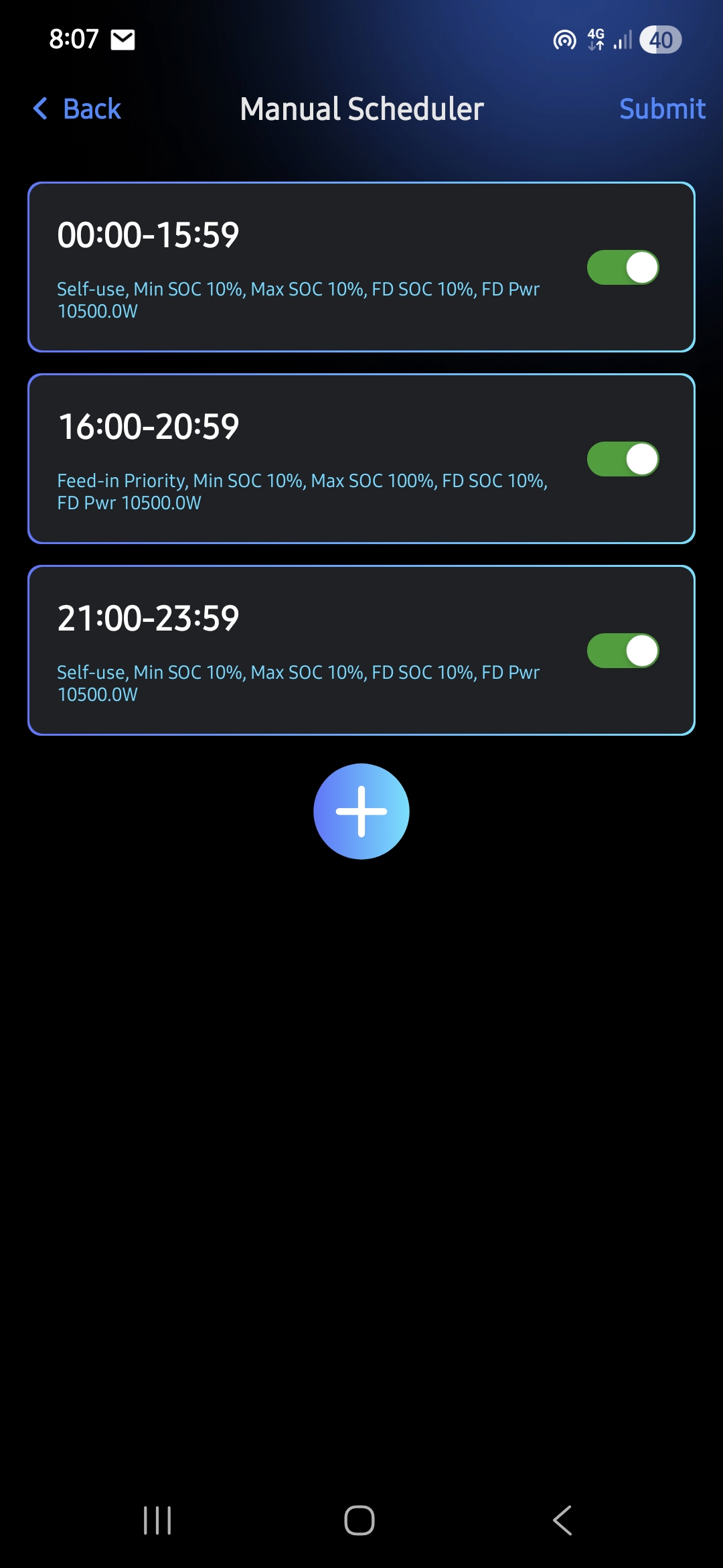

like the attached image?MaterialBarracuda48 wrote: ↑Thu Jan 15, 2026 8:55 am That error code can be caused by your manual schedule being set to feed-in and blocking you from changing work mode manually.
You would expect the system to have your default work mode of self-use, and to adjust to feed-in for your manual schedule, and then flip back to your original self-use after 9pm. What is seen often is that it does not flip modes without a nudge.
Now the safest choice, that would protect you if the Inverter had a reboot, is to add a manual schedule for the self-use period from 00:00 to 15:59, have your feed-in from 16:00 to 20:59, add in 3rd schedule for self-use for 21:00 to 23:59 to cover your 24hr period.
Thanks for the reply.
Yes that is how I would program it for safety.
Have that set, then observe system behaviour to see if it behaves as you expect it to.
Credit for putting them in order, keeps my OCD calm
Edit on 1st and last, make the Max SoC 100% to make sure it allows the PV to charge batteries just in case it decides that 10% = nope

Just changed Max SoC to 100% on 1st and last. It was on 10%.MaterialBarracuda48 wrote: ↑Thu Jan 15, 2026 9:10 am Edit on 1st and last, make the Max SoC 100% to make sure it allows the PV to charge batteries just in case it decides that 10% = nope

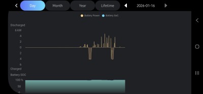

Need confirmation, but I think from my settings, home is not being powered by battery still.
See screenshot attached. End of graph covers start time of battery supposedly set to be used.
But looks like it remains at 100%.
Unless PV is still topping it up.

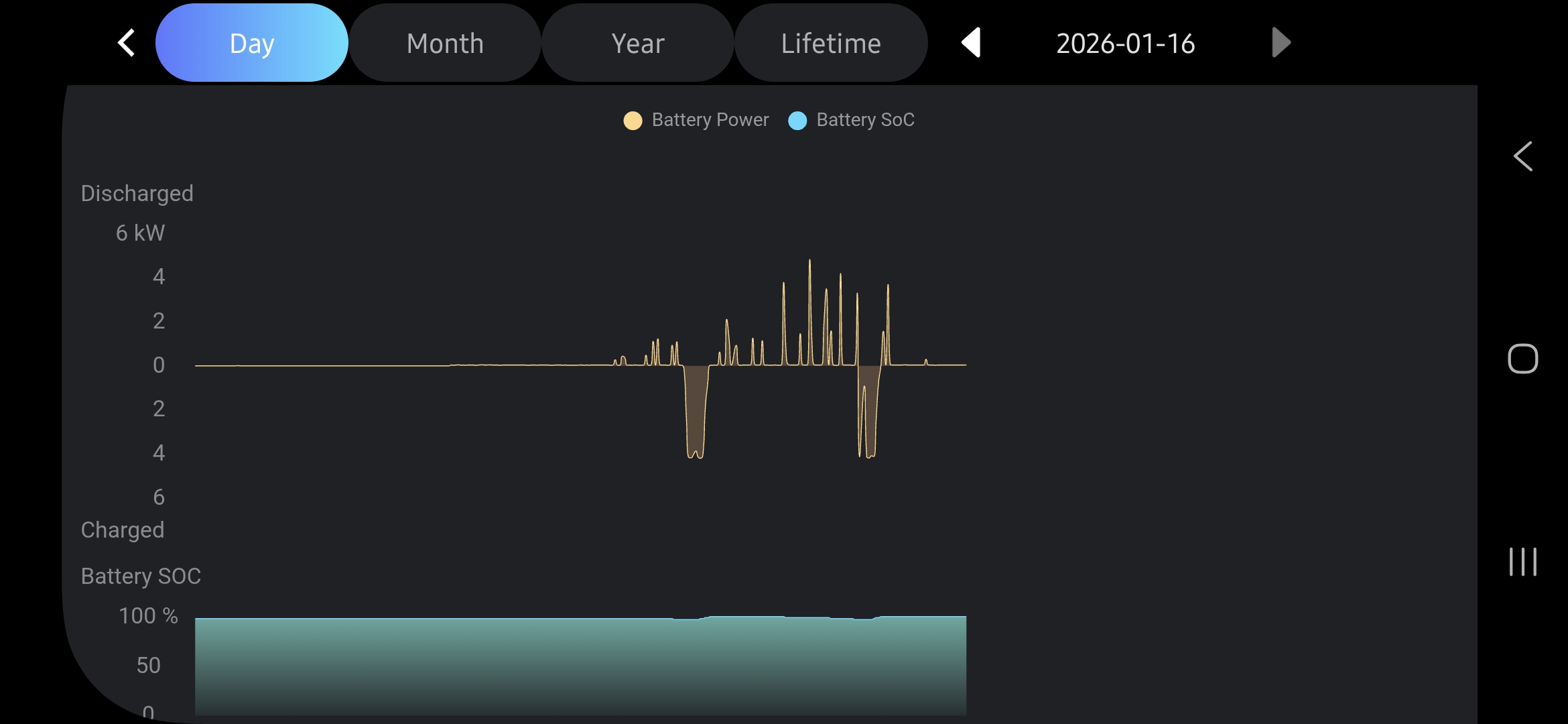

Your graph isn't showing any grid load/solar, so in my limited knowledge it won't be working right.CoreyTroy wrote: ↑Fri Jan 16, 2026 6:24 am Need confirmation, but I think from my settings, home is not being powered by battery still.
See screenshot attachedScreenshot_20260116_172041_FoxCloud20.jpg. End of graph covers start time of battery supposedly set to be used.

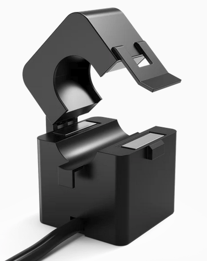

The battery cannot supply power as the Inverter is not seeing the grid and load values, so it won't know when to pump out power when demand is needed as it is invisible to it.
Do you have something like this in your house electric supply box? It should be after your meter. If you do have this, then you need to look at your Inverter itself, in the settings of it (usual passcode is 0 0 0 0)
To see if you Inverter has the CT setting turned on.
The missing PV off your graph is another thing to sort out, but let's check this as first step.

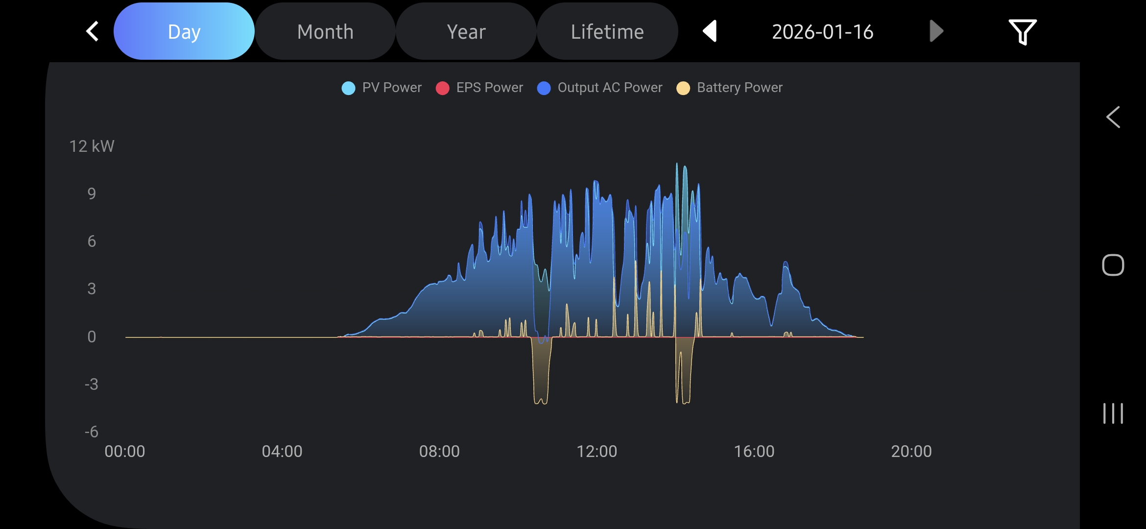

Another graph as attached shows the PV.
The one I posted was only the battery.
I will check out those videos and item's when home still.
You had me worried there!
Well in that case, maybe there wasn't much house load to drain things, and the evening sun you are getting could be powering your house load without battery.
Self-use will use up all the solar it can, fill the battery, the the rest spills over to the grid as export.
Once home and such, you can look at what your system is using, let's hope it is working perfectly for you.
