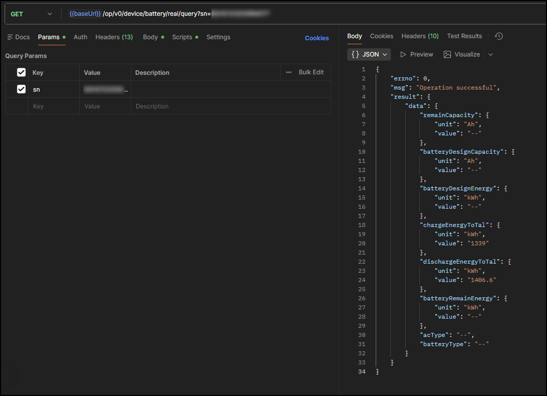

Hi, could anyone please advise why "Values" are empty for battery/real/query?
I want to query battery capacity, remaining kw, current %, is this the right endpoint?
Code: Select all
https://www.foxesscloud.com/op/v0/device/[b]battery/real/query[/b]?sn=xxxx
Please below the response I get!
Code: Select all
    "errno": 0,
    "msg": "Operation successful",
    "result": {
        "data": {
            "remainCapacity": {
                "unit": "Ah",
                "value": "--"
            "batteryDesignCapacity": {
                "unit": "Ah",
                "value": "--"
            "batteryDesignEnergy": {
                "unit": "kWh",
                "value": "--"
            "chargeEnergyToTal": {
                "unit": "kWh",
                "value": "1339"
            "dischargeEnergyToTal": {
                "unit": "kWh",
                "value": "1406.6"
            "batteryRemainEnergy": {
                "unit": "kWh",
                "value": "--"
            "acType": "--",
            "batteryType": "--"

This is a new endpoint and, so far as I can see, doesn't return any data apart from the charge and discharge energy.
To get the battery details, you need to use a number of other queries:
Get Device Detail to get a list of the batteries attached to the inverter and their capacity. Sum the battery capacity values to get the total capacity.
Get Device Real-time data with the relevant variables to get the current battery SoC, voltage, current, temperature, throughput etc.
If you use Python, this get_battery() api wrapper does the work for you: https://github.com/TonyM1958/FoxESS-Clo ... nformation

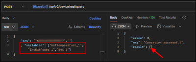

  • The real/query endpoint doesn't seem to return Soc_1 variable when filtered

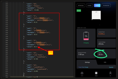

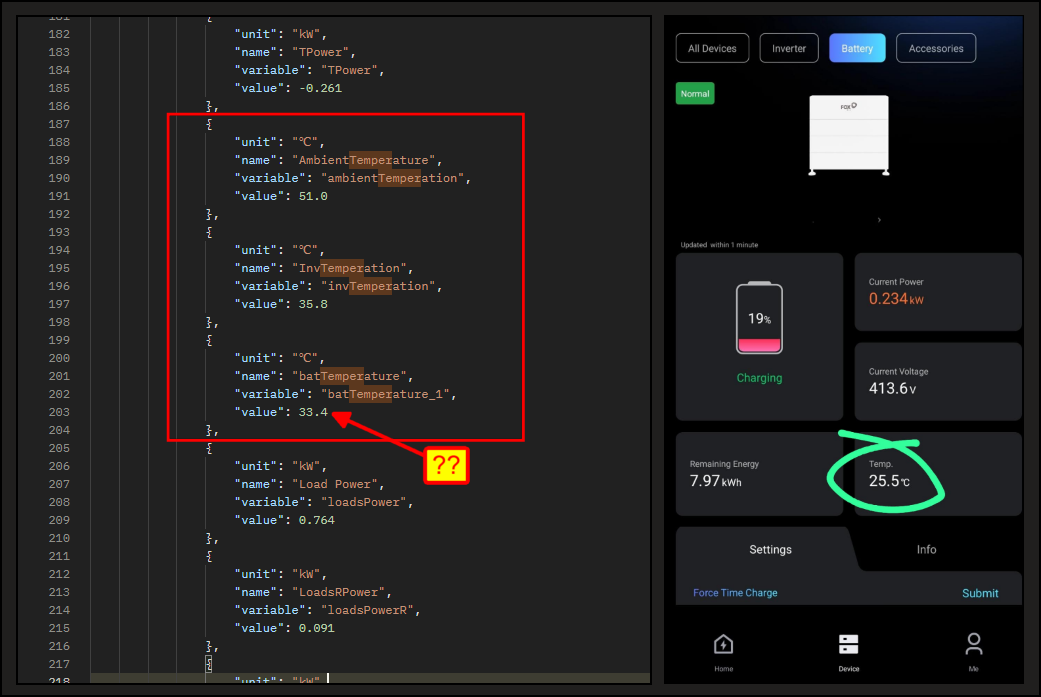

  • With battery %, the values don't seem to match on API response vs what's shown on the app

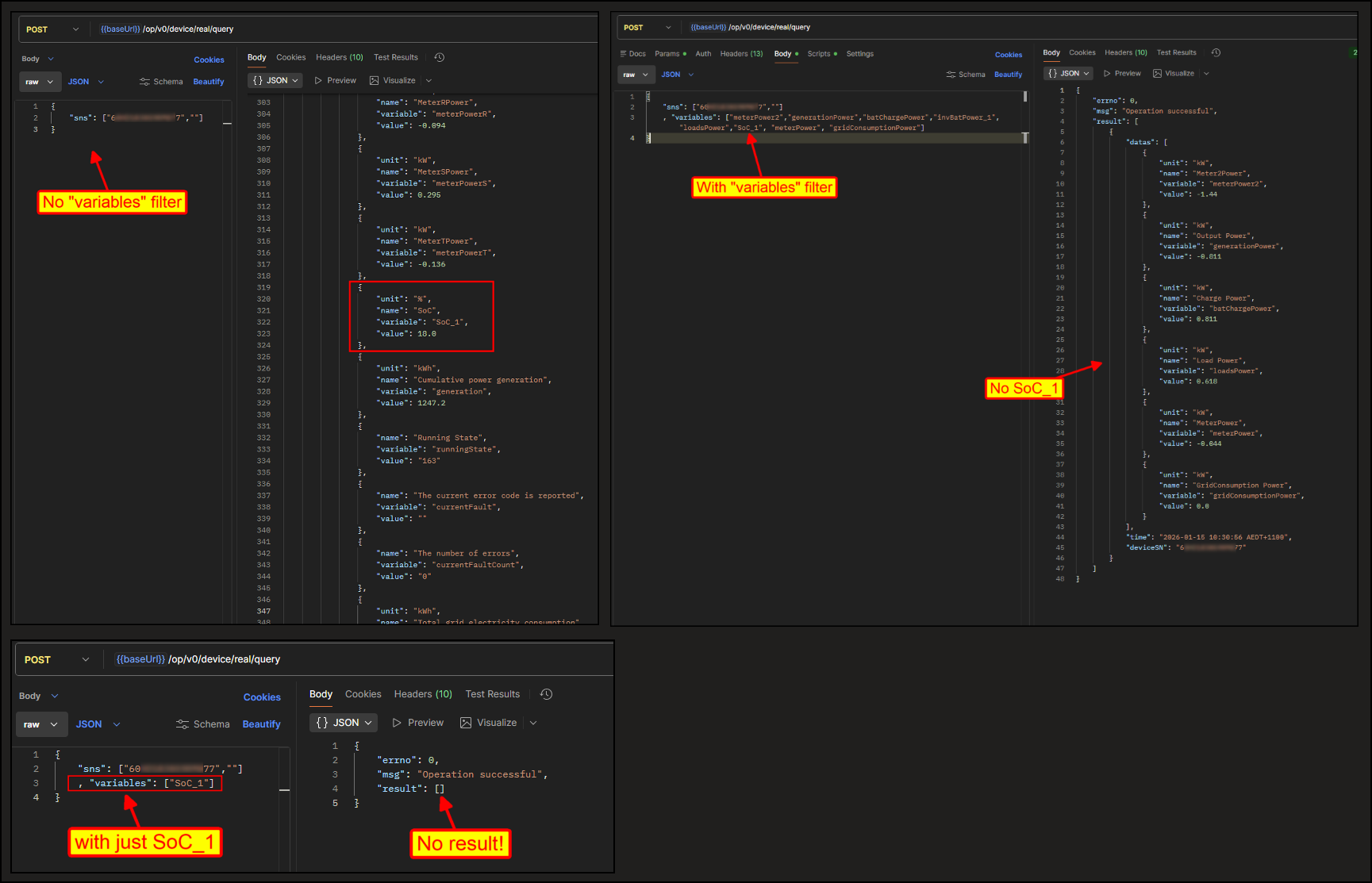

  • Few other variables are also not getting filtered!

Confusingly on a single battery system the variable name is actually 'SoC' not 'SoC_1', whereas on a multi-battery system you don't have a SoC you have SoC_1 & SoC_2 - change the name to SoC and it will return a value.
The temperature you see in the app is the lowest cell temperature, whereas batTemperature is the temperature at the BMS power junction and is usually 6-10C higher than the lowest cell - sadly despite our continued requests Fox have not added the lowest cell temperature to the OpenApi.
Similarly as for SoC the variable names for a single battery system are 'invBatPower', and 'batTemperature'
