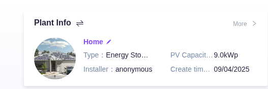

we had our solar system installed by use the sun ltd on april but they don't seam to have configured themselfs as the installer.
how do i go about getting updates in this situation can I create an installer account with ESS and then manage my own firmware?
