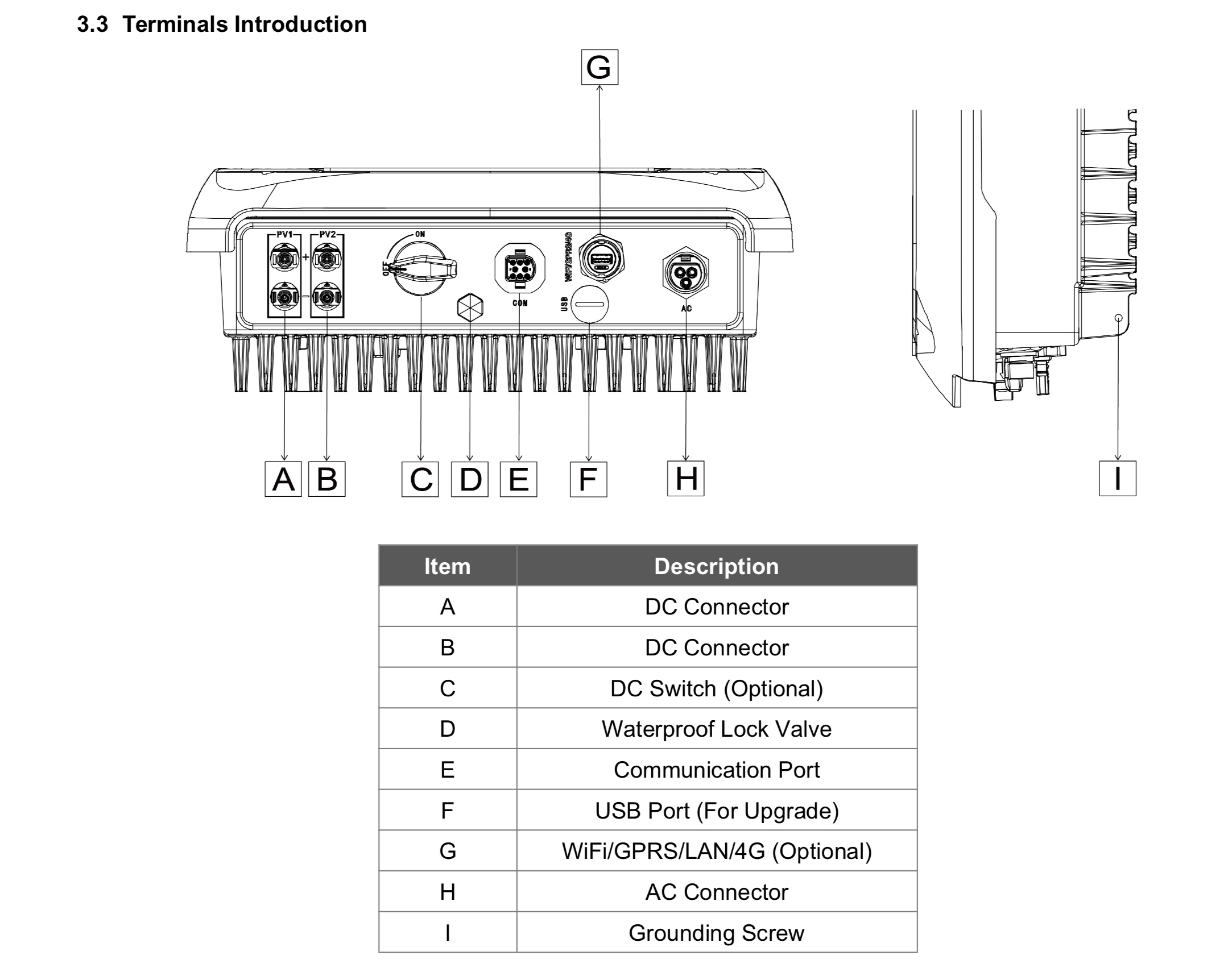

Just to double check (as there is a seperate USB port as well), this is likely the layout of your F series connectors, and it’s connector ‘G’ that may also be a USB type.
I’ll have to double check tomorrow but I’m pretty sure that’s the layout but without connection G will take a few extra photos
