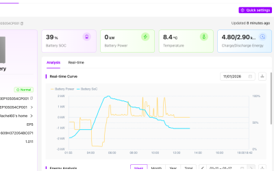

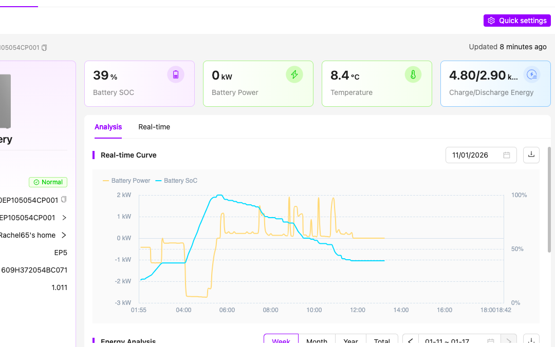

If it is currently heating, then it won't discharge at the same time.
Looking at the graph it seems that the point your reboot issue started at this time was when the battery reached 40% SoC, this is the threshold at which the battery switches from self heating to using external power to heat.
Your inverter firmware versions are also quite old, it would be worthwhile emailing Eon or (probably better) FoxESS support to get these updated.
