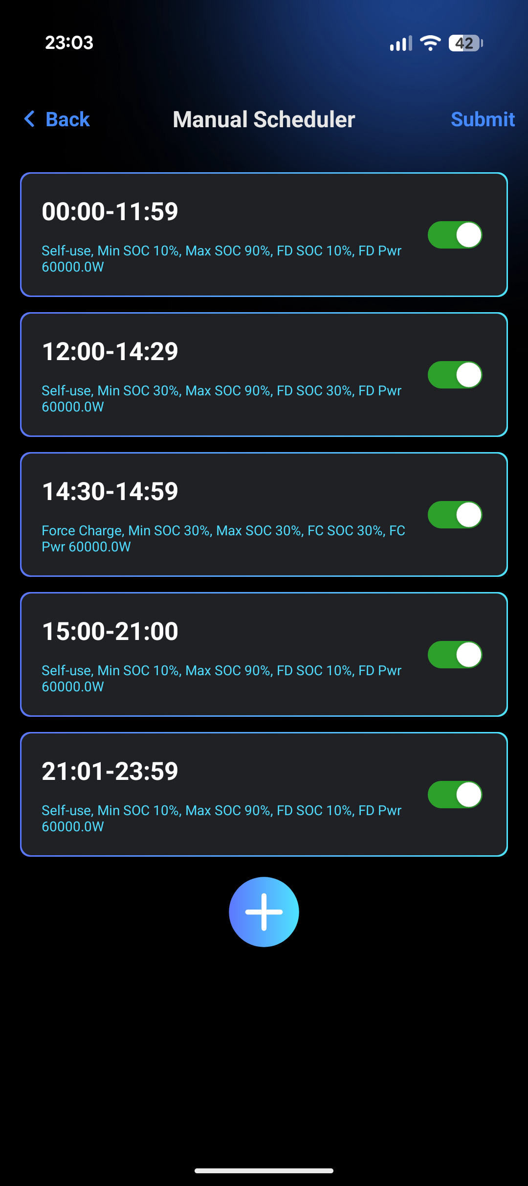

My peak period starts at 3pm, so I've set a "force charge" interval from 14:30 to 14:59.
I've set all of the min SOC, max SOC and Force Charge Max SOC to 30%.

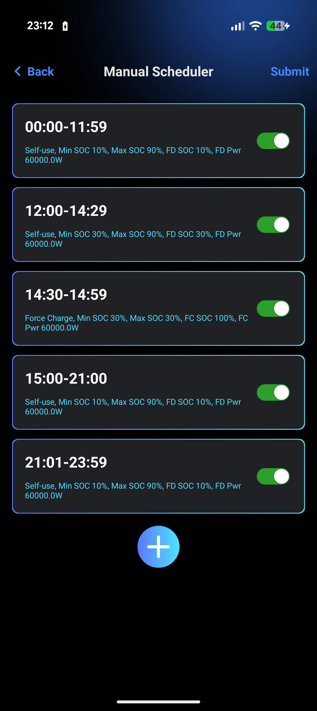

Note though that I've checked later and the Force Charge SOC was overridden to 100%.

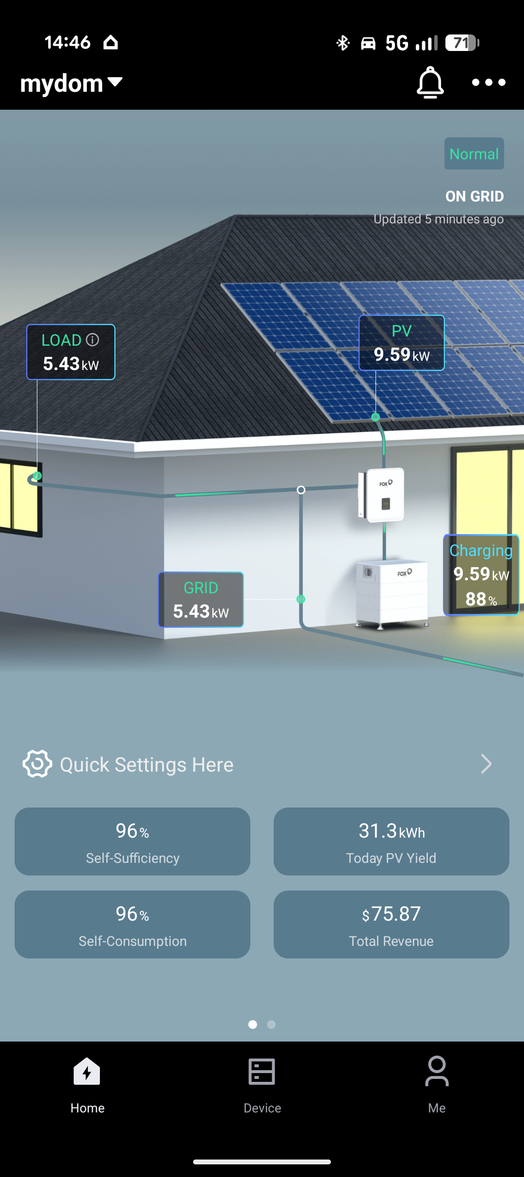

Today was a relatively sunny day so the battery was charged from solar to almost 90% before force charge period started.
However, the force charge period still prioritised charging the battery, even though max SOC was set to 30% and the battery was almost full.
It looks like it was using just solar for that purpose but I would've liked it to actually use solar and battery to power the house at this point, rather than trying to get battery to a 100%.

I set the max soc and force charge to 80%, save it and can conflicts saved ok. However at later point both settings get overwritten to 100%.
