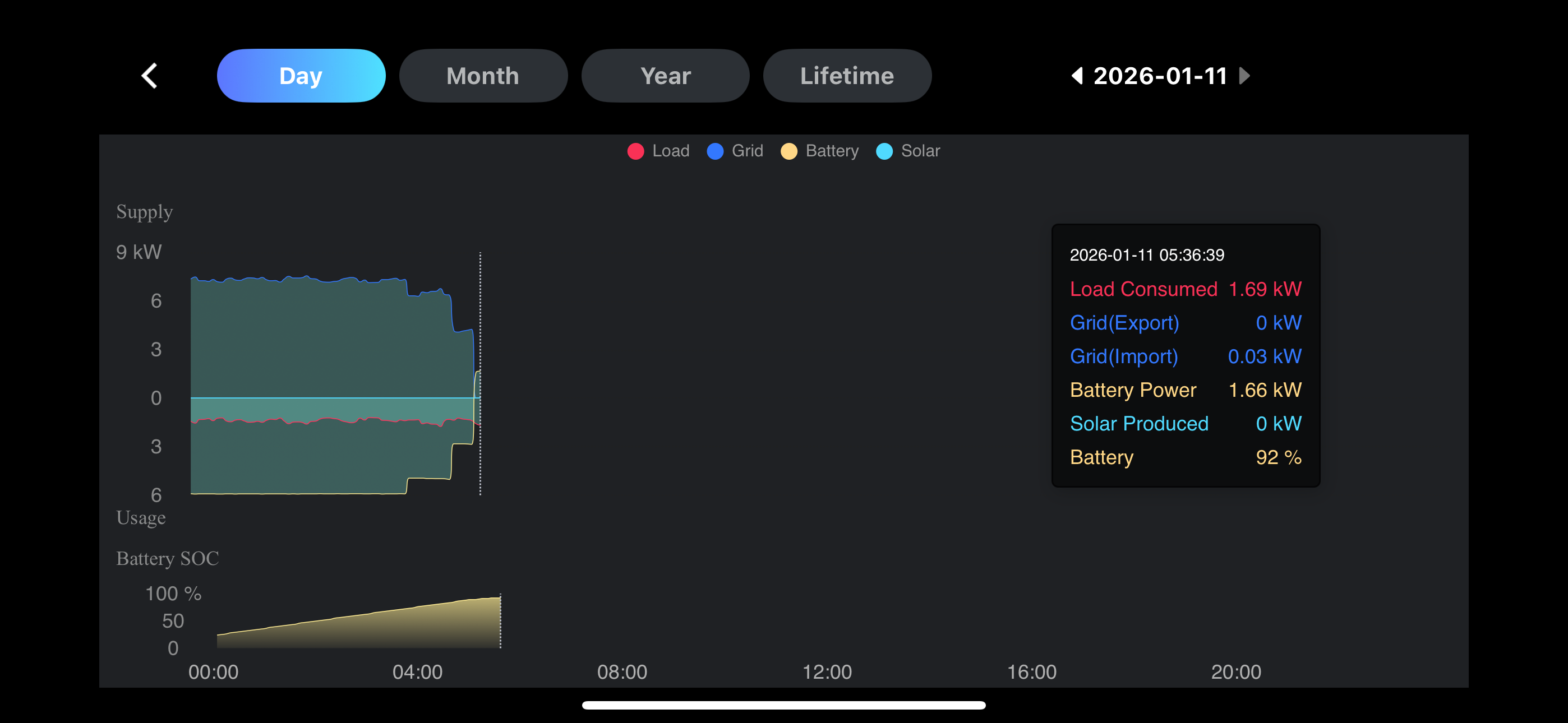

And after all that managed to add another hour of charging through intelligent octopus go EV schedule and in response my inverter seemed to throttle back charging in the last hour of charging so I still only got to 92% when for another hour I should easily have got to 100% charge.Any idea why the throttle back happens

The batteries always throttle as they approach full, but usually nearer the 95% mark - have you ever done a complete charge cycle on this pack yet ?, i.e. from 10% to 100% and back to 10%.
The pack balances as it approaches 100% (see my first post above) which is why it is throttling to allow individual packs / cells the time to harmonise with the rest of the batteries - if it is starting a little earlier it suggests the batteries have not yet learnt their limits which will naturally happen after a few full charge cycles.

This forum is so helpful. Batteries have never been above 92% because inverter is too small but you can see from graph they started to throttle an hour before end of charge period which says they have learned that 92% is the max. Normally they have throttled in the last 30 mins - hope they can unlearn this !!
Is there an easy way to get them to learn 100% or am I simply going to have to go through 8 or 10 cycles edging them up. Problem I have is that I simply don’t have time for this amount of “customer commissioning”

From March onwards you'll have plenty of solar to help, these are the worst months when the majority of battery charge will come from grid.
The only way to get them to 100% is to leave them charging for as long as it takes, which at high tariff just isn't worth it.
The batteries will learn, it just takes a bit of time - they will always throttle above 95% but in summer you won't notice, for now just carry on doing what you doing and hopefully soon you'll not use all your battery during the day or we'll have a good solar day and they'll be able to charge all the way to 100%.
