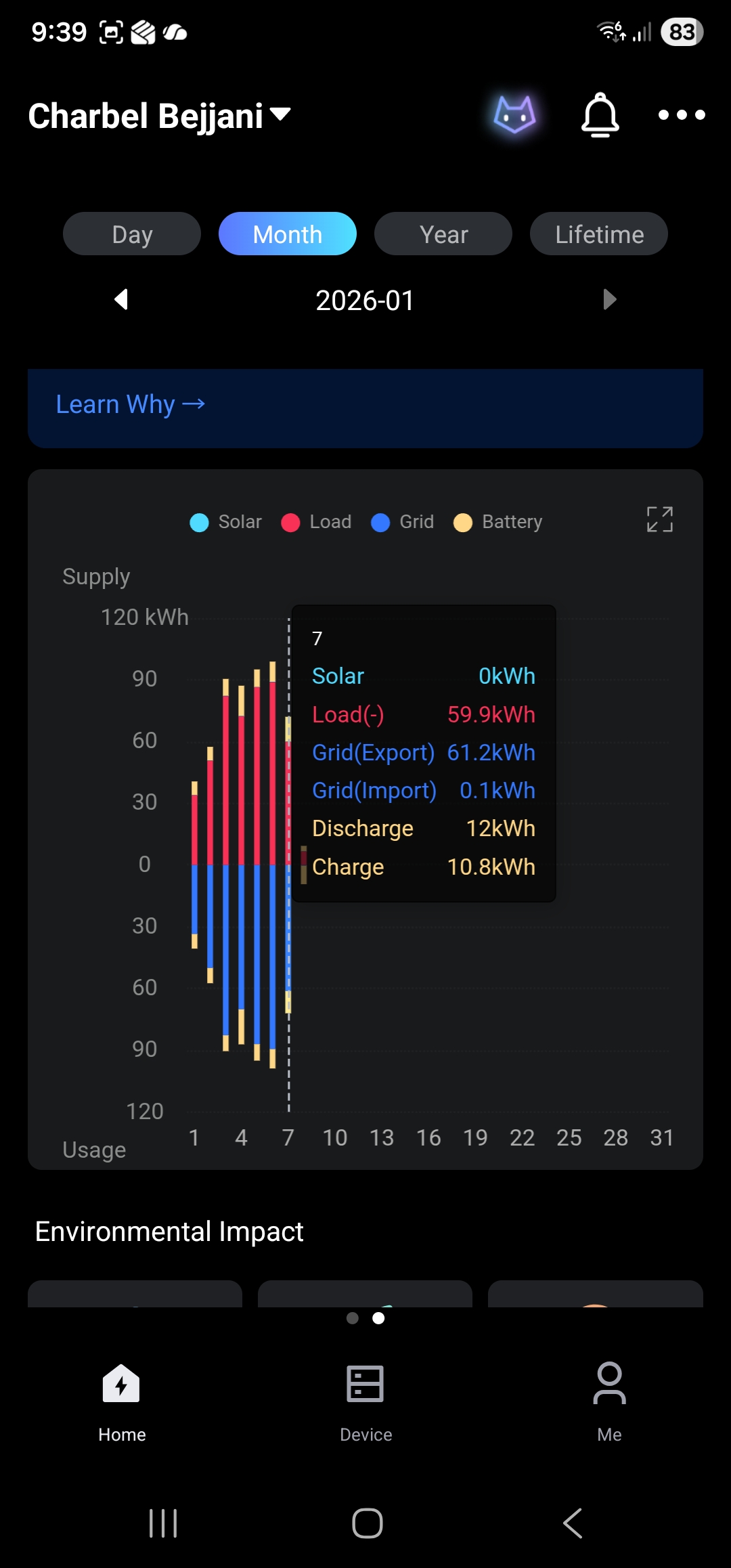

My problem is with the cumulative Load value when I look at the day by day data. It's represented as Load(-) and I understand this means that I have a 3rd party PV solar array producing abundant energy (which I do).
It just seems that the Load(-) is calculated by = Grid(export) + battery charge - battery discharge. There's no other variable there.

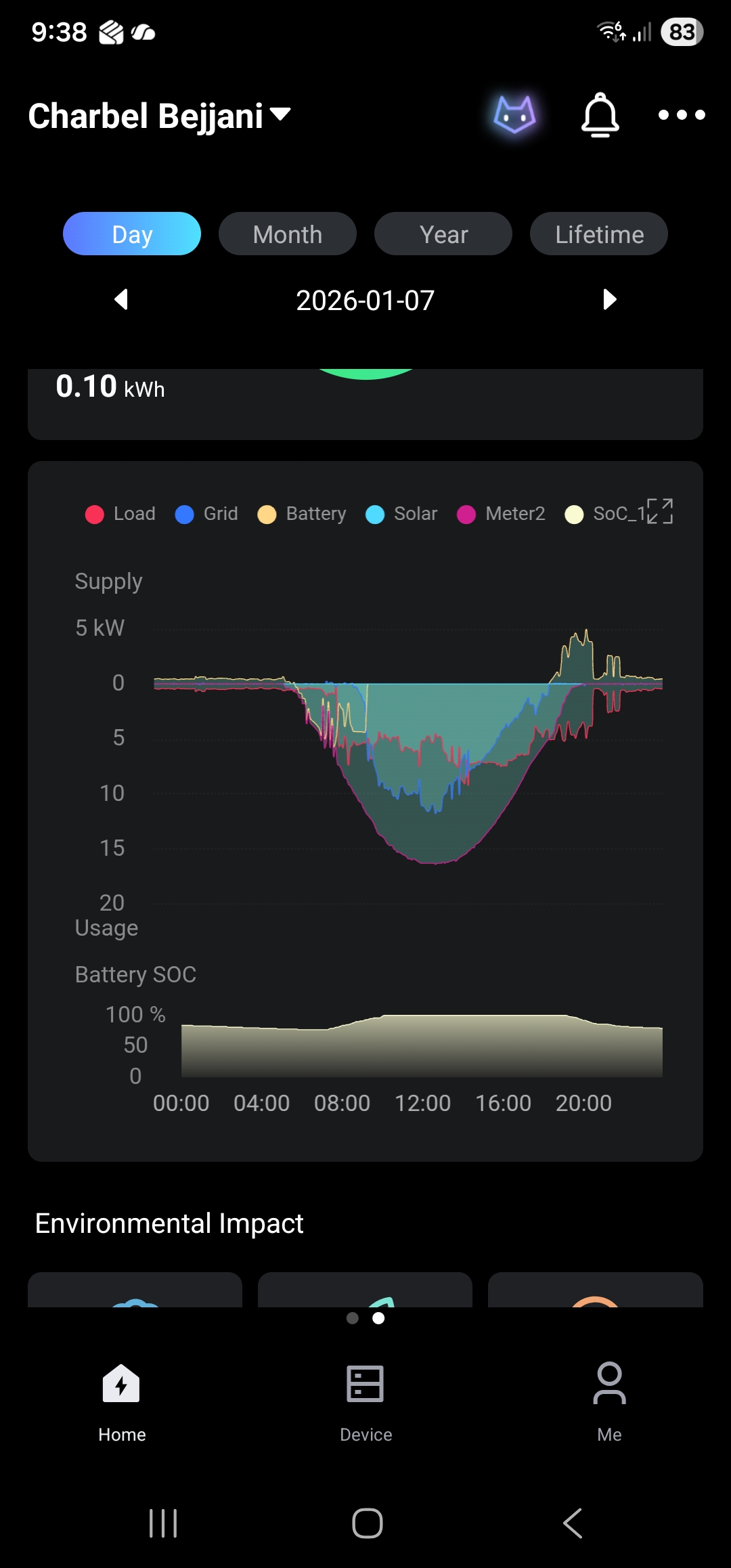

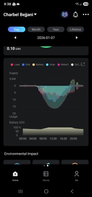

Live data displays Meter2 curve accurately (but is in the 'usage' area under the horizontal line).

A second inverter source usually messes up the load figure even on a single phase inverter, the CT2 clamp placement and phase direction are critical to the calculation that takes place in the Fox cloud.
I believe that the calculation it is doing is Load Power = GridConsumptionPower + Output Power(RST) – FeedinPower + meter2Power
But sometimes with 3 phase systems the sign of meter2Power is reversed, in which case the actual calculation would be better represented as Load Power = GridConsumptionPower + Output Power (RST) – FeedinPower + abs(meter2Power)
But just a thought, have you tried the Energy Stats app ? - Al the developer added an optional setting that allows it to flip the sign of meter2 for 3 phase systems which worked much better.
But in all honesty the best advice is to install a home assistant and then do your own load calculations based on the R/S/T values for CT1 and meter2 and feed those into an integral to produce your energy statistics.
