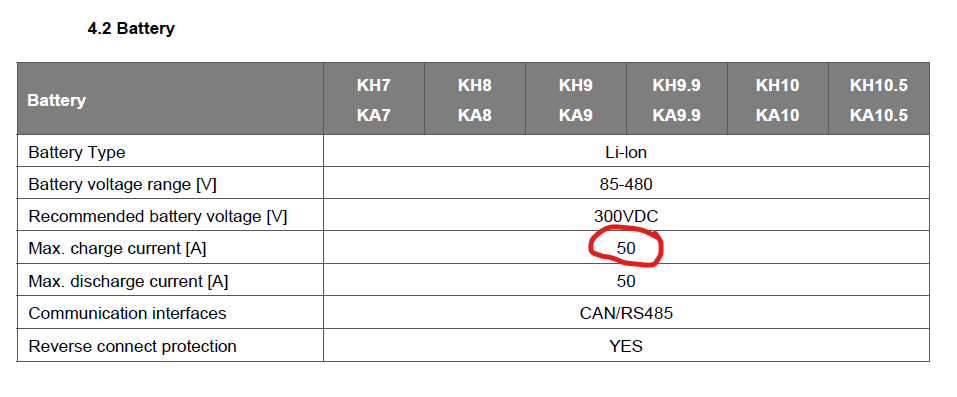

According to the EQ4800 specifications, the nominal operating voltage is 403.2V, and the recommended charging current is 30A (max 50A). A simple P=VA calculation means the recomended charging power is 12.1kW (max 20.2kW).

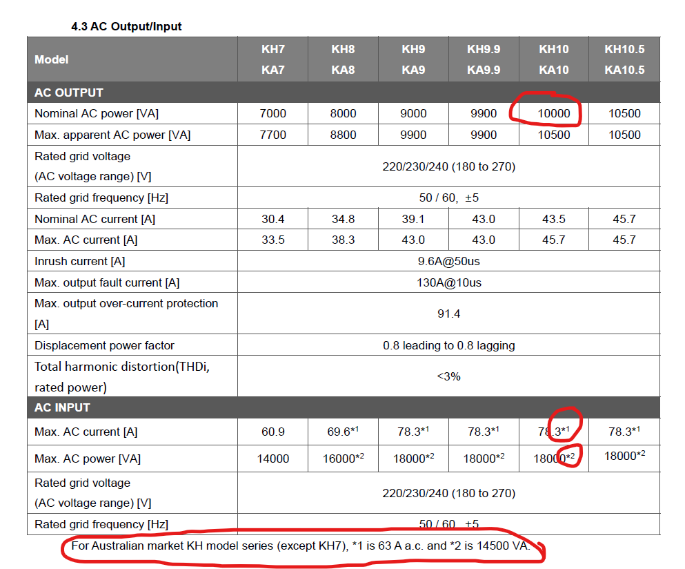

During force charge, why is the KH10 inverter limited to 10kW from AC and 1kW from PV (max 11kW total)?
Because it is a KH10 with a maximum AC power of 10kw, a KH7 would be 7kW, the limit is set by the inverters power limit or the (BMS maximum charge current * battery volts) whichever is the smallest.
The AC output is used to provide power to the house load when discharging from the battery. AC output is not used to charge the battery.
The inverter is connected to the battery by DC not AC. The Datasheet for the inverter specifically contains the DC specifications of the battery for charging and discharging.
As previously provided, the EQ4800-L9 operates at a voltage of 400V and the inverter has a maximum charge current of 50A (battery recommended is 30A). This shows the KH10 is capable of charging the battery at 20kW (battery recommended 12kW).
The AC Input specifications are what determines how much power can be used to charge the battery (allowing for AC to DC efficiency which is 97%).
As shown, for Australia, the max AC Input power is 14.5kW.

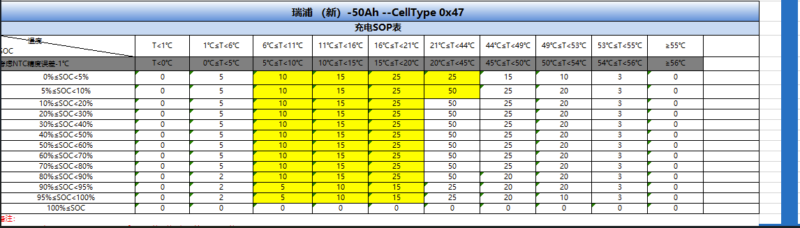

Also worth noting the BMS (BMU) is constantly managing the charge current and will ramp up or down depending on temperature, and soc.

Not sure, do you have home assistant installed? - it would be really useful to see the traces of your BMS max charge power sensor, actual battery charge power, battery voltage and the PV traces (i’m assuming they were being clipped?).
Given the system losses it’s likely the actual charge power going into the battery was 400-500 watts less the 11kW which is getting close to the 10500VA apparent power limit.

The max battery charge current on the inverter is set to 50A. Is this setting on the AC side (240V) or the DC side (400V)? If on the DC side, then the max charge power would be 20kW (10kW AC + 10kW DC ?).

Correct, the max battery charge current in the inverter defaults to 50 for the KH and that is that maximum allowable DC charge current to the batteries, but the BMS maintains it's own Max DC charge current which changes depending on temperature and SoC - this image is based on a slightly older BMU specification but shows it effectively. (it is managed by the BMS and cannot be set)brunofabre wrote: ↑Thu Jan 01, 2026 10:23 pm The max battery charge current on the inverter is set to 50A. Is this setting on the AC side (240V) or the DC side (400V)? If on the DC side, then the max charge power would be 20kW (10kW AC + 10kW DC ?).

But even with that, with your battery volt range between 365-463V, unless it is very cold or hot it is unlikely that is throttling you, which leaves only the AC power limit as that is your source for most of the charge controllers (AC-DC converted) charge power.
There are max AC limits in the settings which are used where the grid has a limited supply, I don't think they are responsible but you can check them in Settings, on-grid, Export Control, ImportLimitCur (normally set to 100A AC or your supply fuse limit), and some inverters have ImportLimitPwr (normally set to 30,000 unless you have a restricted supply).
That's a hard one to answer for me, in the UK / Europe where the PV is mostly used to charge the batteries through the day (and run the house through the night) with any surplus exported at a export tariff (so more PV generation is always a good thing) - it appears you have differing requirements in Aus using the batteries to load shift.brunofabre wrote: ↑Thu Jan 01, 2026 10:23 pm I currently have 4kW of PV and thinking of adding more so I can fully charge my battery each day. However, if I can't get the full benefits of the 4kW I have now there's no point adding more.
Based on the BMS battery charge current grid you provided, I would be operating in the range of 50A 21<T<44 and 10%<SoC<90%.
My ImportLimitPwr is set to 15100W and the ImportLimitCur set to 63A (Grid voltage is 240V).
We have established that the max AC Input power for the KH10 is 10kW (240V @ 41.67A). What I really want to know is what is limiting the total charge power to the batteries to 11kW? When my PV is above 1kW, it will reduce the AC Input power so that AC Input power + PV power = 11kW (as shown by the app screenshot).

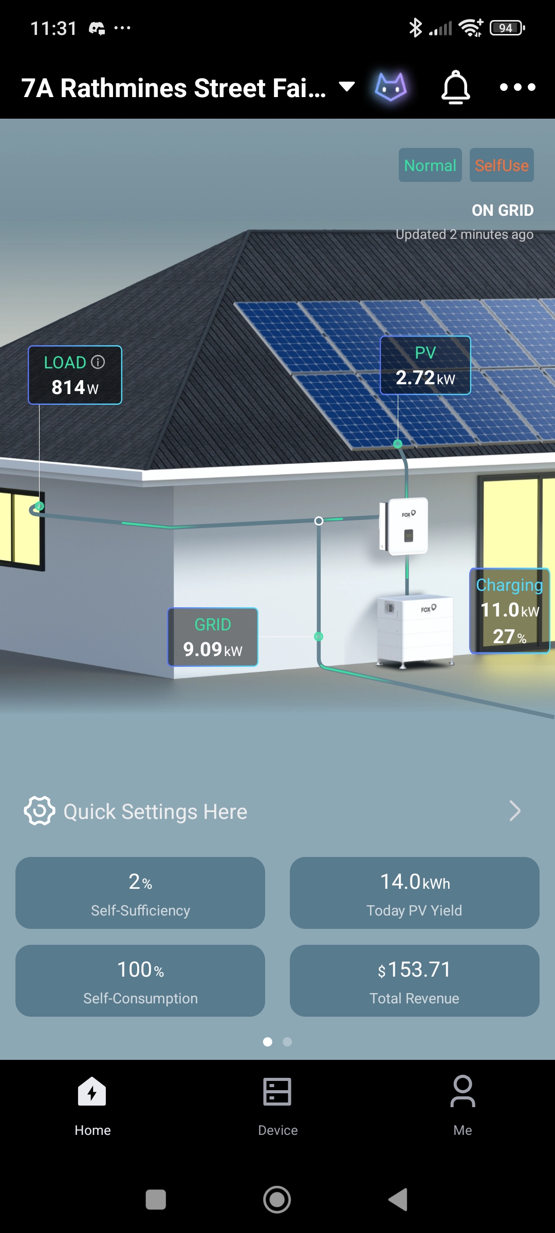

What is happening:
PV=2.72kW
Load=0.81kW
Grid=9.09kW (0.81kW to Load, 8.28kW to Inverter)
Battery Charge=11kW (2.72 from PV + 8.28kW from AC Input)
What I expect to happen:
PV=2.72kW
Load=0.81kW
Grid=10.81kW (0.81kW to Load, 10.0kW to Inverter)
Battery Charge=12.72kW (2.72kW from PV + 10kW from AC Input)
There seems to be something that is restricting the total (PV + AC) battery charge current to 11kW. I want to know if this is a configuration setting that has been incorectly set.
