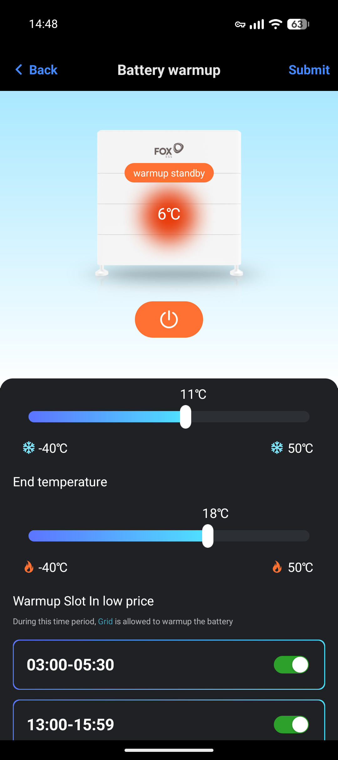

First of the very cold weather for my area in the UK and the battery warm up feature seems to not be working.
I appreciate cold weather impacts batteries but I thought this battery warming feature should be kicking in to prevent these charging issues.
I have an EP11 and a H1 5.0 G2.
Version - Master 1.31, Slave 1.02. Manager 1.48, BMS version 1.005.
Below is an image of the settings I have setup and it not doing anything, I understand there should be an animation when it is heating.

Contact your installer or Fox support and ask them to remotely update your battery firmware, there have been a number of revisions to correct faults - latest version is 1.011
And to be honest whilst you are there ask them to update your inverter firmware as well as that is some way behind, you can see the latest firmware versions here viewtopic.php?t=1927

greensolarostrich wrote: ↑Sun Jan 04, 2026 2:50 pm Screenshot_20260104-144835.png
Once you have updated the firmware, you will know as the heating range you can set changes.
Mine had -40C to +50C on FW 1.005, corrected when updated.
Here is a video of how it looks in action, recommend you set top min temperature to 9C (you can go lower, but charge/discharge is affected more)
viewtopic.php?p=10871#p10871

All updated now, looks like it's not working now. Got up to 16c in 45-60 mins from 6c which is good! Now just to wait for the cheap period to come around again to test my automation :)
