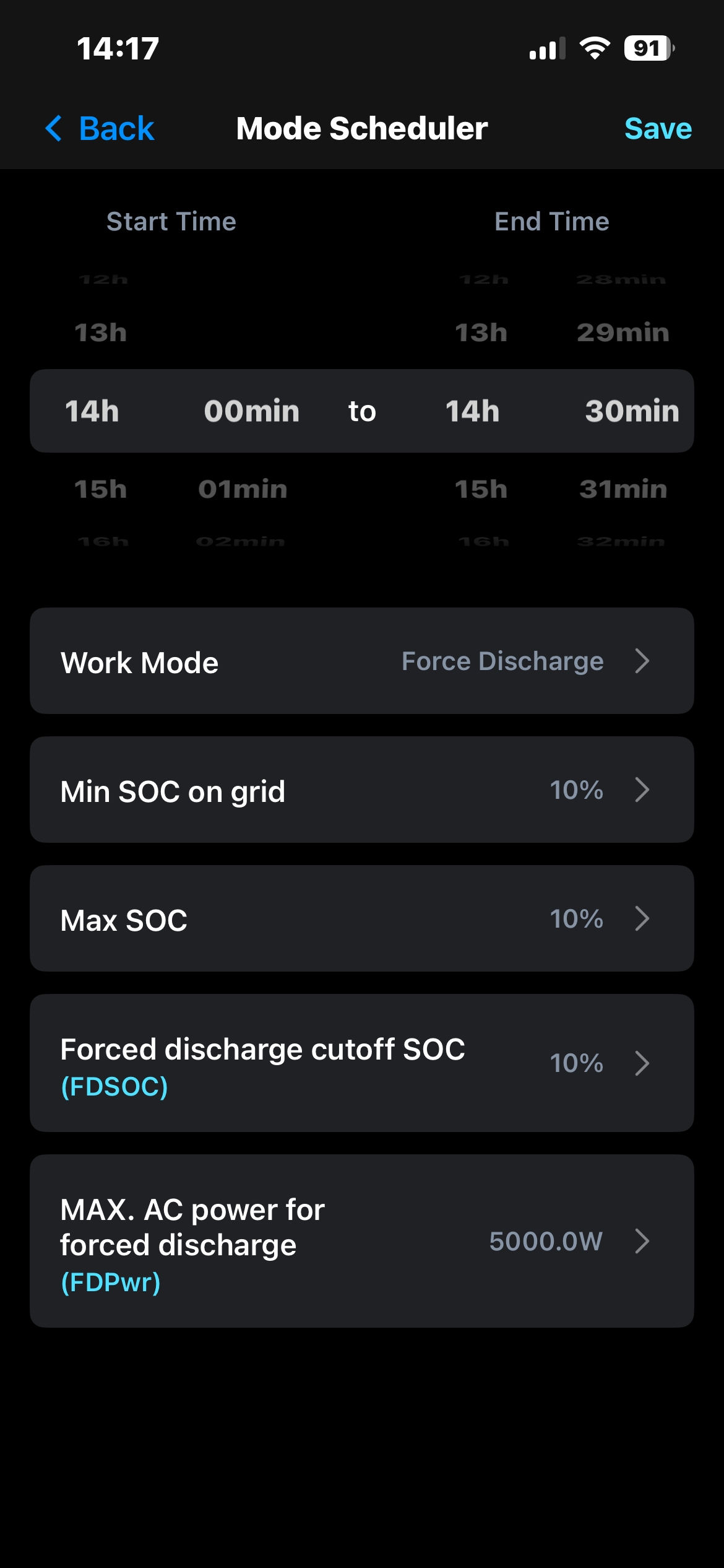

I am trying to work out how to force discharge my battery to the grid. I have set up as per photo but nothing happened. The battery simply continued to supply the household but did not discharge anything to the grid.
What am I doing wrong?
That should have worked as long as you saved it, made sure it was switched on and pressed ‘Submit’ - if you close the app and open it again when you look in quick settings it should show ‘Mode Scheduler Enabled’
Did you have any other heavy loads on at the same time, EV charging, heat pump running etc..
