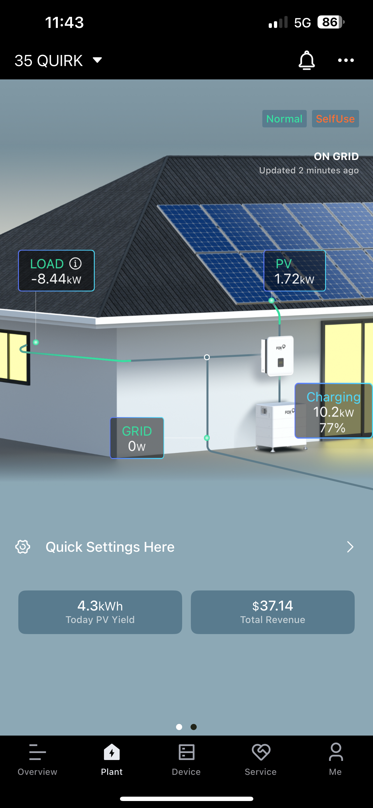

Recently just did our first fox eq4800 l9 install at my house with a H3 SMART 10.0. The load seems to be negative and the inverter is not recognising energy coming in from the grid. The battery is currently charging from the grid in this picture as I've set it up to charge from the grid during this time of the day as we have a free power plan.
Ive checked my energy retailer app and we haven't been pulling any power from the grid overnight, however according to the energy retailers app we exported about 2kw (per hour) to the grid from 3pm to midnight for some reason.
Anyone know why this is happening am thinking the CT clamps might be wrong but not sure?

There are 3 clamps, we reversed all 3 didn’t seem to do anything still showing negative load.
Also the load is definitely wrong - had a kettle on and it only showed 250w

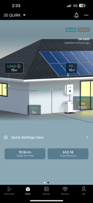

After the battery has fully charged (from the force charge setting) it seems to go to 0-50w for 30mins to an hour.
