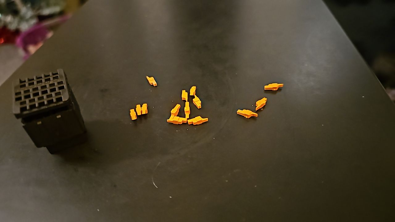

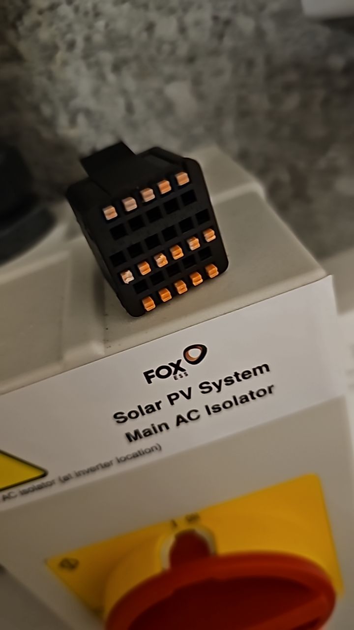

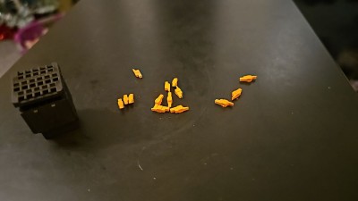

I got ModBus working, but damn did I make a wonderful mistake.
I had never seen this connector before, and didn't know how it worked, so pulled it apart. I did manage to put this together, after I dropped every single pin out and the orange push down parts on the garage floor.
When I put the connector back together again, and wired back the CT Clamp & Modbus... I got error in the inverter as the pin (8) for the CT1+ wasn't fully in the plug... so I had to fully dismantle and put together for a 2nd time.
