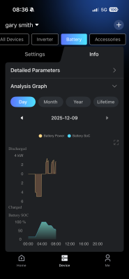

It would really help to see the graph you get at the bottom of the page when you swipe left on the app.

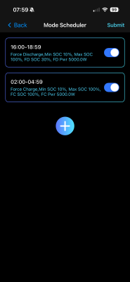

Thanks. Can you confirm that I have both charge and discharge settings correct now.
Gary
Gary
Yes both are set correctly, the only comment to make is the schedules end on the 59th second of the time, so you would be more precise ending at 18:59 and 04:59 but it’s only a minute.
So just to confirm what each is doing,
The Force Discharge will discharge the battery, starting at 16:00 and ending at 19:00(:59), and will cut off should the battery soc drop to 30% - discharging at a rate of 5000 watts.
The Force Charge will charge the battery, starting at 02:00 and ending at 05:00(:59), charging to 100% - at a maximum rate of 5000 watts.

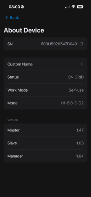

3. Have you had the firmware updated since installation (possibly not as the f/w versions are not the latest)
4. If a new install, has the CT clamp been installed correctly (arrow on CT should point to the grid supply)
Manager(ARM):1.70
Master:1.53
BMS:1.012
Manager(ARM):1.70
Master:1.53
BMS:1.012
What should the latest firmware be for my inverter H1-5.0-E-G2

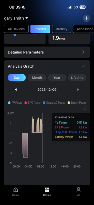

The inverter will be set in Self Use mode at 5am and so the batteries will meet any house load which is its normal operation.garysmith38 wrote: ↑Tue Dec 09, 2025 8:39 am Inverter graph below, previous was the battery.
What exactly are you trying to achieve?, normally it would be to run the house off battery and dump any excess to the grid at the higher flux rate.
If you don’t want to use the battery at all, use grid power at the standard rate and then dump the battery at the high export tariff, that may not be possible (depending on your firmware).
If that is what you are trying to do you would need to set the workmode to ‘Backup’ at 5am until 15:59 (again this depends if your firmware supports it)

I have had Fox update the firmware on the Inverter, so fingers crossed all works ok overnight. Thanks for your help and will let you know the outcome tomorrow

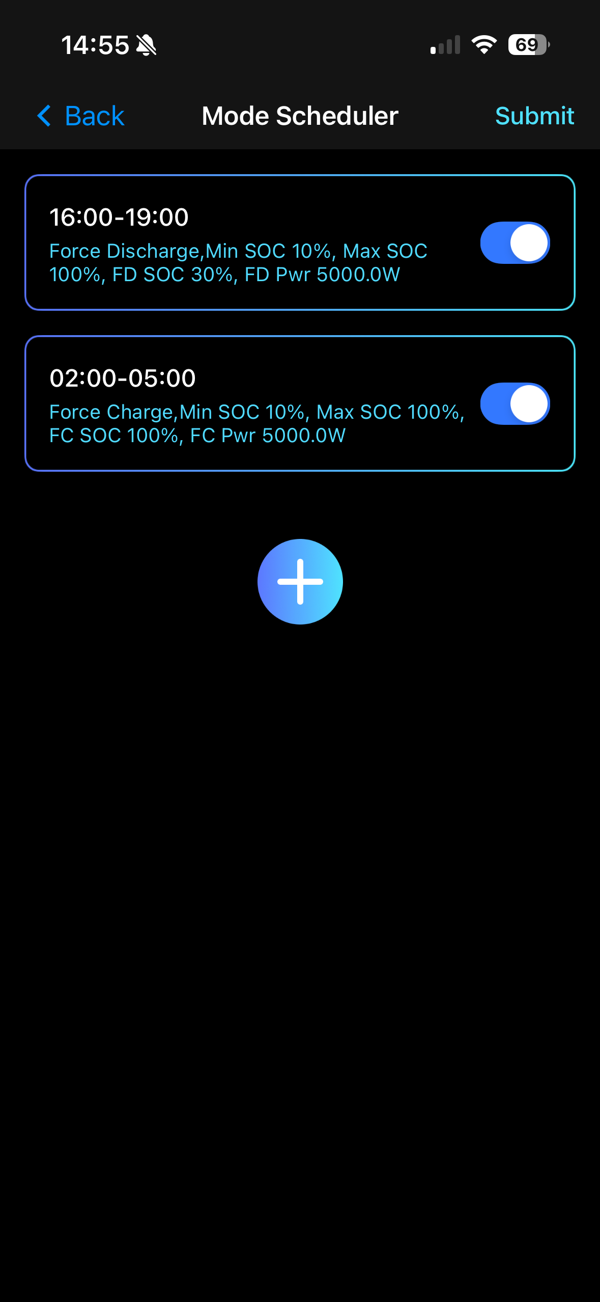

Well, it still not worked!! I am stumped. Screenshots attached of setup.
The inverter is now in "self use" mode which means it will be discharging and supplying the house load (up to the inverter power rating) which is what it is supposed to do.
If you want to stop this from happening you need to add a schedule with the mode set to "Backup" from 05:00-15:49

Thank you. What should the other settings be e. Min/max soc, max ac power
I'd start with:
Min SoC on grid 10%
Max SoC 95% (The battery will self discharge slightly so setting this below 100% should stop the inverter attempting to charge the battery back up to 100% using standard rate electricity)
FDSoC 100%
FDPwr 0W
The last two should have no effect anyway.
