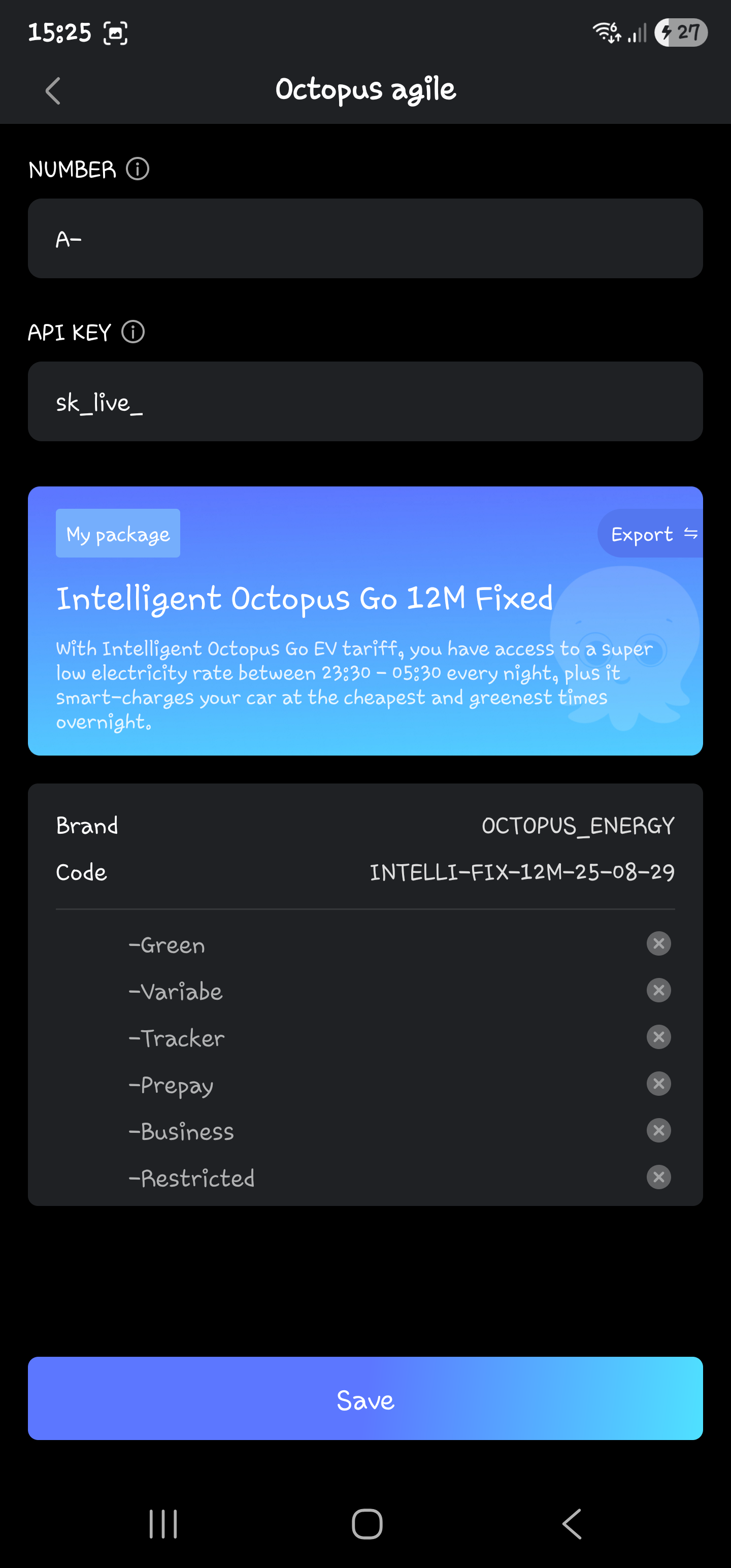

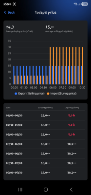

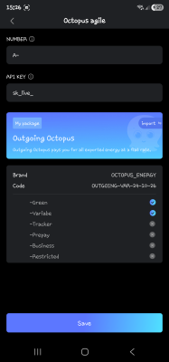

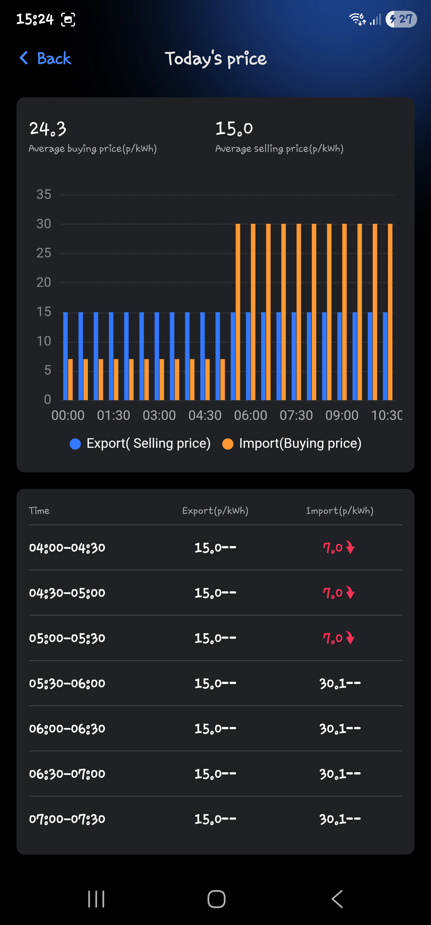

Meanwhile here are some images you should see once your API key has been entered and verified. You can see that once it works, this is how it appears in a working account. The name Agile is kind of misleading now, as it actually show your Account tariffs. I am on Octopus Intelligent Go, and Export Fixed (though does say variable to cover them changing rates in future)
Import:
Export:
Pricing pulled down into the Fox Cloud
Import:
Export:
